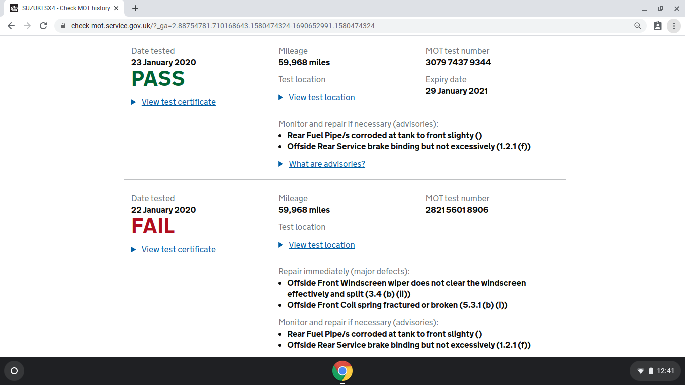

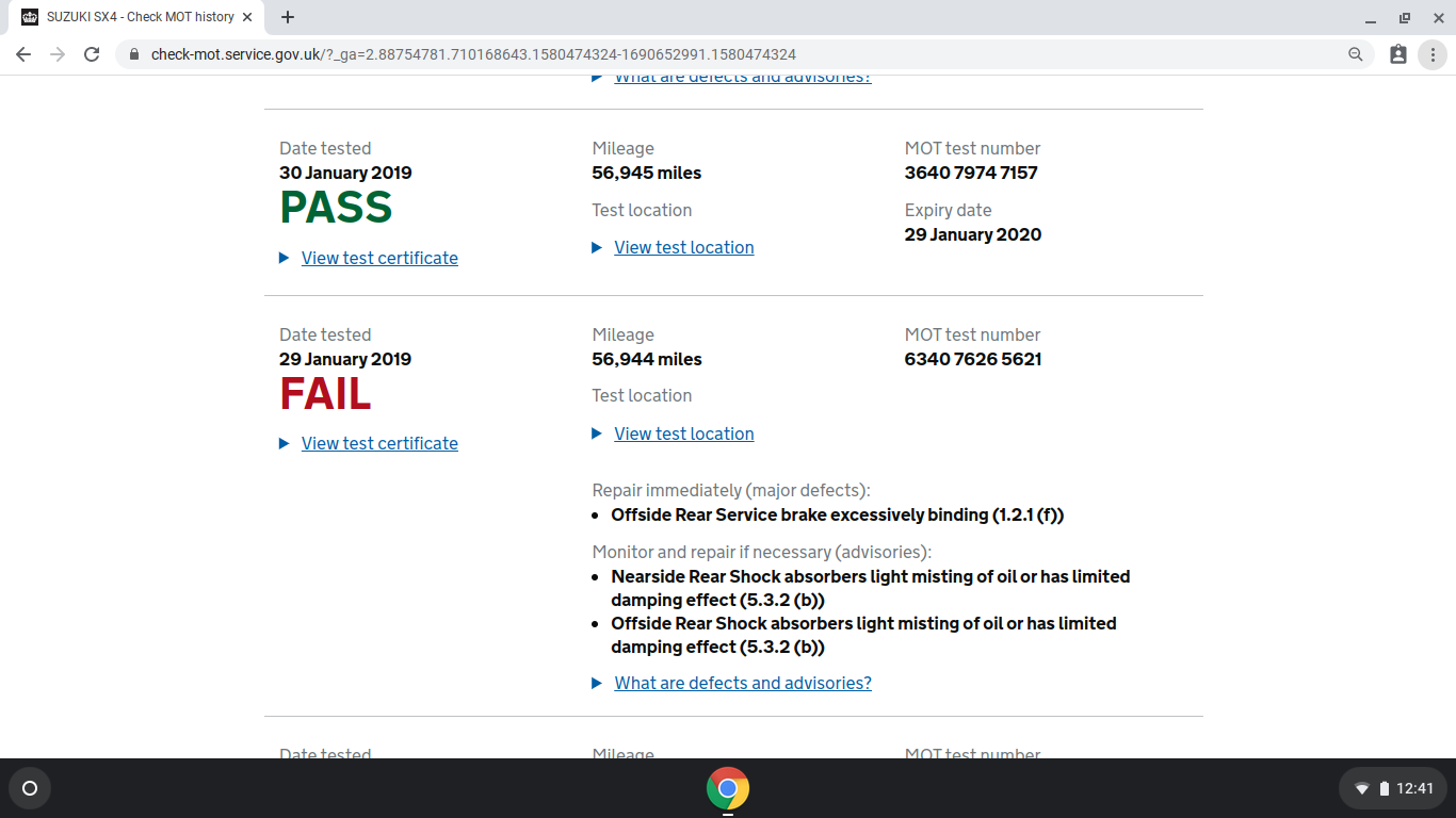

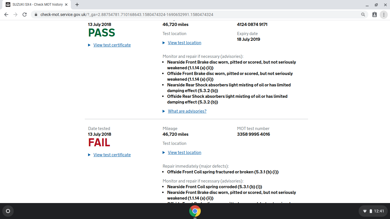

ARNOLD CLARK PEUGEOT AYR.
Were trying to contact me yesterday after my 'Survey response' on Wednesday.
We bought an old used car last February.  MOTed in January 2019. Previous MOT July 2018.
We got a 2 year Service & MOT plan.
I knew the MOT History.  I know the cars well. A Suzuki.
Came with New Discs, Pads & Tyres & Serviced.... New Rear Springs, New wipers, New Oil & Filter & Air Filter certainly.
July 2018, Fractured or broken O/S Front spring fail. Passed the same day.  No idea where.
MOT again Jan 2020. There were new discs and pads on it, and new rear springs. Crap wipers
3,000 miles later.
Last week in for a service and MOT @ 8 am.  Call at 8.30am broken front spring, wiper failed mot.  Rear Brake binding.
I said OK get the spring, put on a wiper, and service the back brakes.  If you check you fitted them last year.
Do not change the Brake Fluid by year / miles, test it for H20.
No problem if you can not get the spring on by tonight, as long as by tomorrow Lunch time.
Quote 1.3 Hours, Parts, Labour, VAT £216.
Happy as larry.
Then the call again, 'Got the spring, mid afternoon, Not ready tonight',  That fine but need it at 11.30 am Tomorrow, then the attempted upsales.
BOG OFF.  Just Service it, you are not fitting Plugs or Filters, sort the rear brakes.
So car not ready next morning, not going to be ready till afternoon.
Tech calling me was a clown, and ARNOLD CLARK Peugeot & Toyota AYR do not have a Brake Fluid tester at the Workshop supposedly.
There is a Service Video on the ramp with the wheels off last Wednesday.  Quickly gets passed the Discs, new rear Coils, and not that much concentrating on the front coils..
