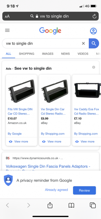

I’m not sure about piggyback fuses as the one I used came with a CAN connector that turned the unit off and on, but as for the double din plate, that may not fit as the Skoda unit isn’t actually din shaped, so you would need a VW to single Din Adapter. These usually come with a storage pocket to fill the gap. Something like the ones below. They also have the 4 screw holes to mount the frame in the holes behind the plastic surround of the Unit.

Yeah that single din adapter that you have linked is what I have ordered.  Ill just have to wait for stuff to arrive and see if I have it all or not. Thanks
