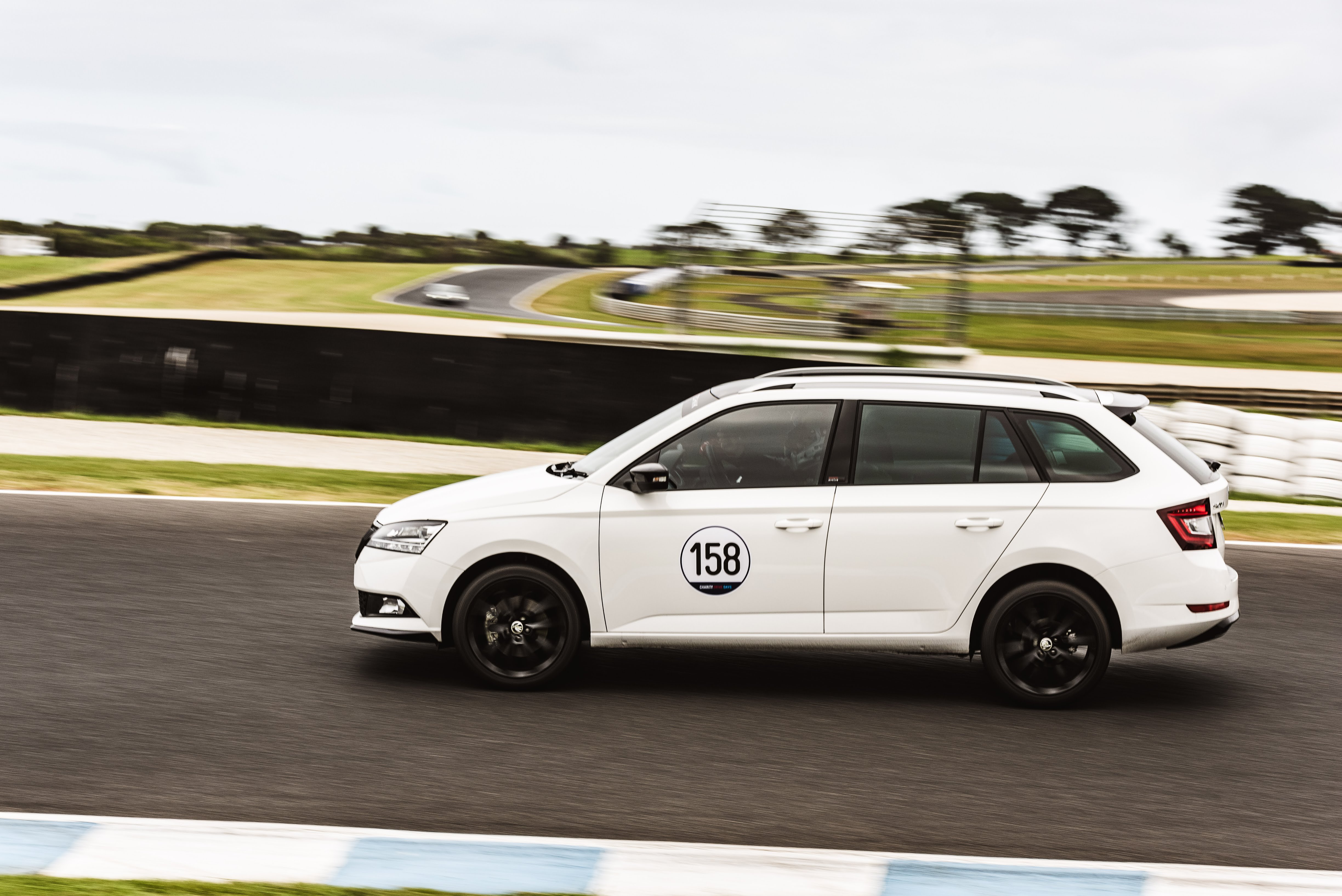

I have the full facelift Monte Carlo kit from Superskoda.  Aside from adding a few speed clips and bolts at the bottom edge (x6 from memory) it just all screws on with the stock screws on the bottom edge.  It came with an adhesive to stick the top edge on so generous amounts of that and taping up whilst drying means it ain't going anywhere in a hurry.  The front one is the same process but two separate pieces on the corners.  The side skirts on the other hand.....that is a project and a half.  Need to find some more mounting hardware to fit them (brackets, screws, etc)

I made the dealer include it as part of the deal when I bought the car. I liked the monte carlo kit but not the interior so I think it cost around $2000 AUD for the whole kit
