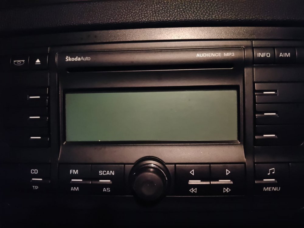

picked car up today aand this is the stereo in it, plays mp3s from stereo and it has an aux port under the arm rest :)

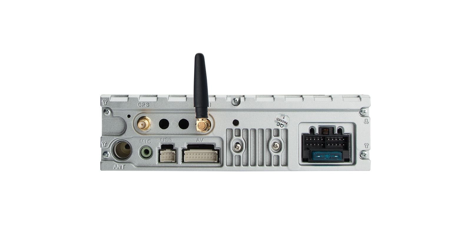

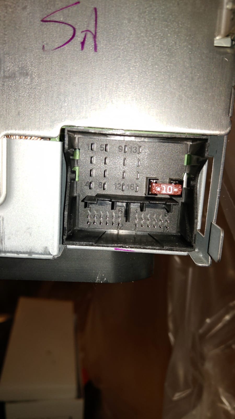

did you need any cable adapters for either of these because looking at the pictures of the back of them, they dont look like the back of my stereo
the 1st picture is the 1st link and the second picture is my stereo and they look different, (the xtrons looks like only the bottom half of my stereos plug)

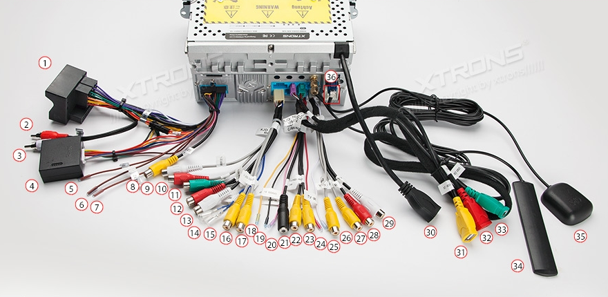

In my case I plugged into the wiring harness (1 - in the image below) supplied by Xtrons
