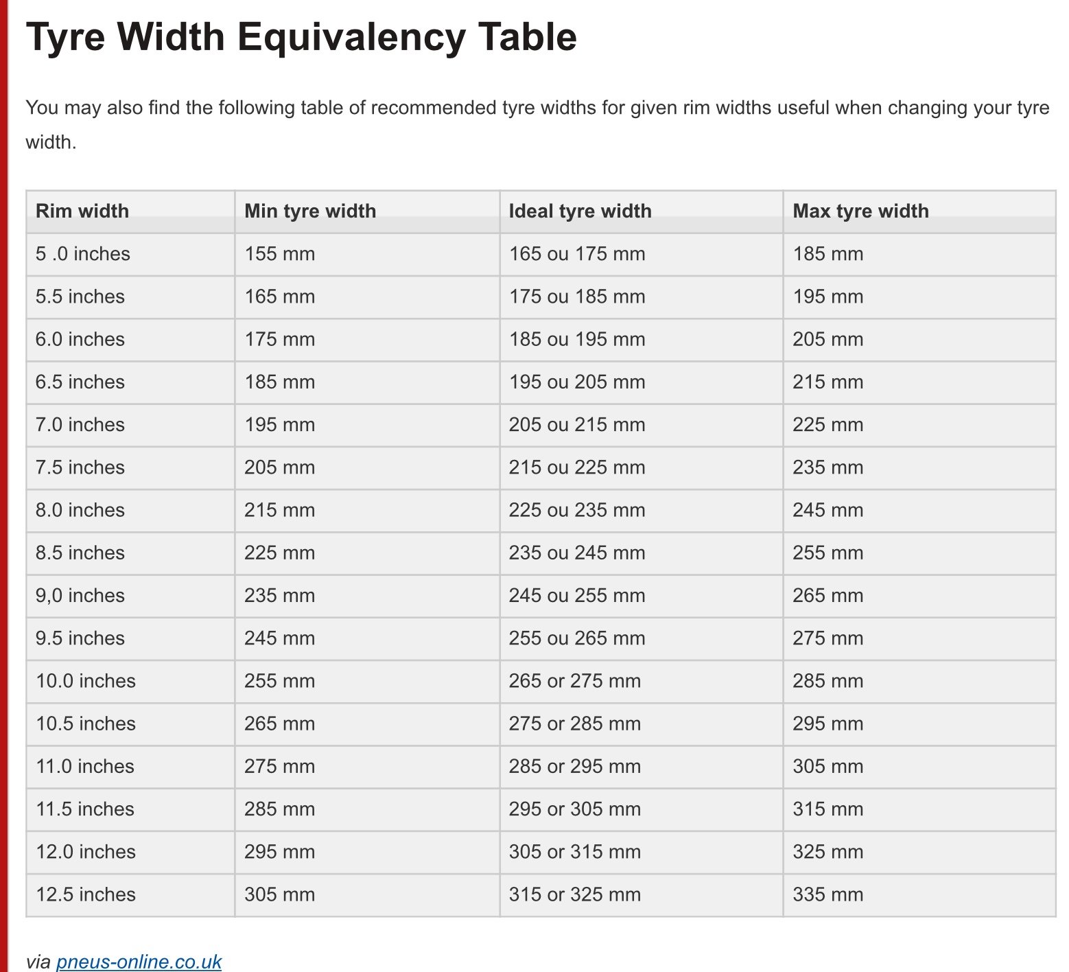

At the moment I have 215 65 R17 tires on 17x7 alloys, I would like to keep the alloys, as they are Oz Rally Racing which are quite nice on a white Kodiaq but I would like to read you opinion if there would be any issue to fit 235 65 R17 tires on them, mostly because of narrow alloy wheels?

Thank you, in the meantime I got TUV papers for alloys and actually below are all possible options for OZ rally racing wheels:
225 65 R17
235 60 R17
245 55 R17
255 55 R17
