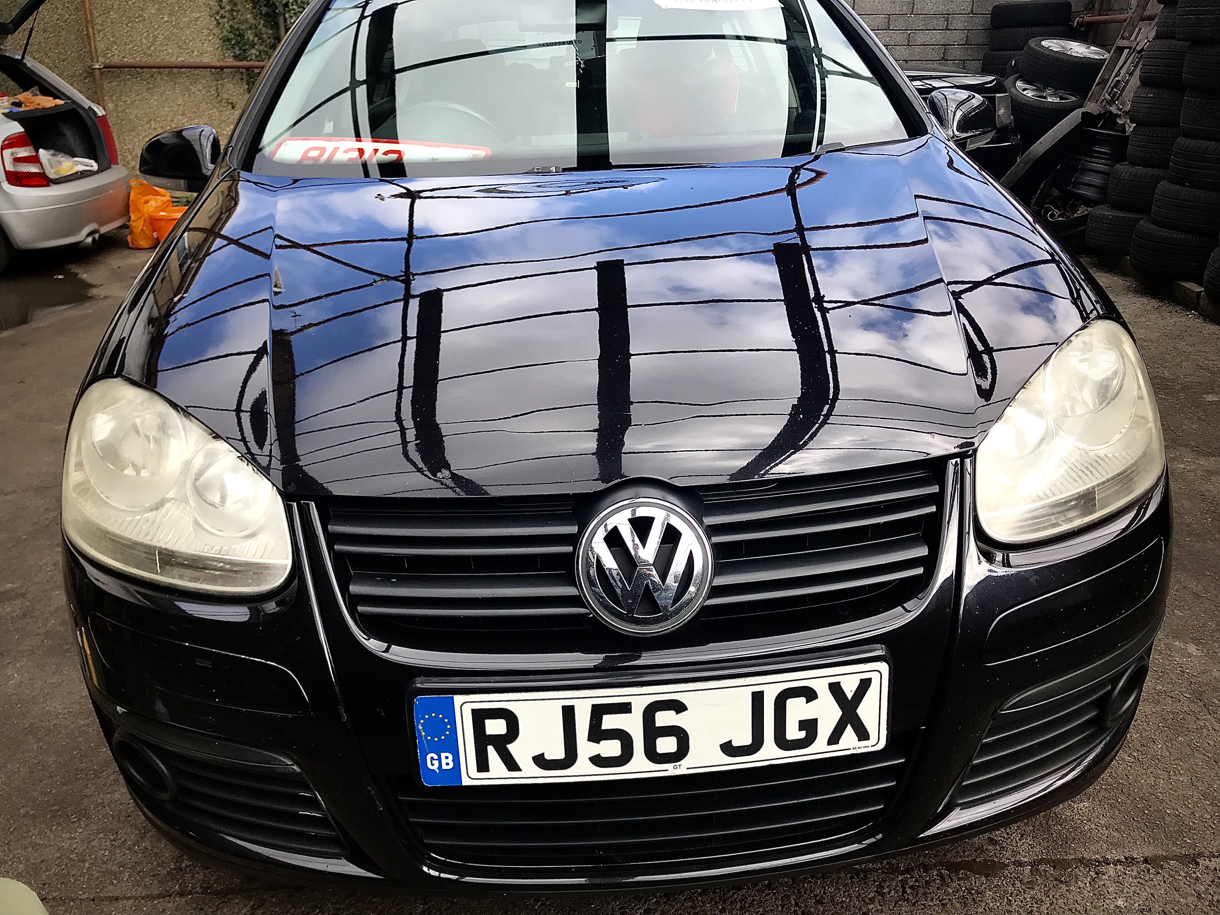

Something seems strange about painting the lens lacquer or not lol don’t know why. I’ll post the before and after of the m3 kit and how long it takes etc but below is a quick shot of my headlights now.
They are both about the same but on different angles, the left doesn’t look too bad but you can see how bad they really are on the right.
Edited by mikey362
Can’t tell my left from my other left 🤪
