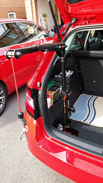

She had a lift for her Fabia estate but we used to break the scooter down and lift the bits in seperately.  In the end it was more of a faff to use the lift than just lift things in and out by hand.  Her lift was fastened to the left hand side of the boot floor and when folded down it took up about 4 inches of depth across the width of the car so factor that into your space calculations.

We have a lift in my wife's Seat Ateca which is ideal for it, being tall and upright at the back. I struggle to see how one would fit in a Superb hatch without you having to dismount the lift arm to close the hatch, possible with the one we have but the arm itself is quite heavy and awkward to handle. Is the one you're considering specifically adapted to fit the Superb to get around this problem?
