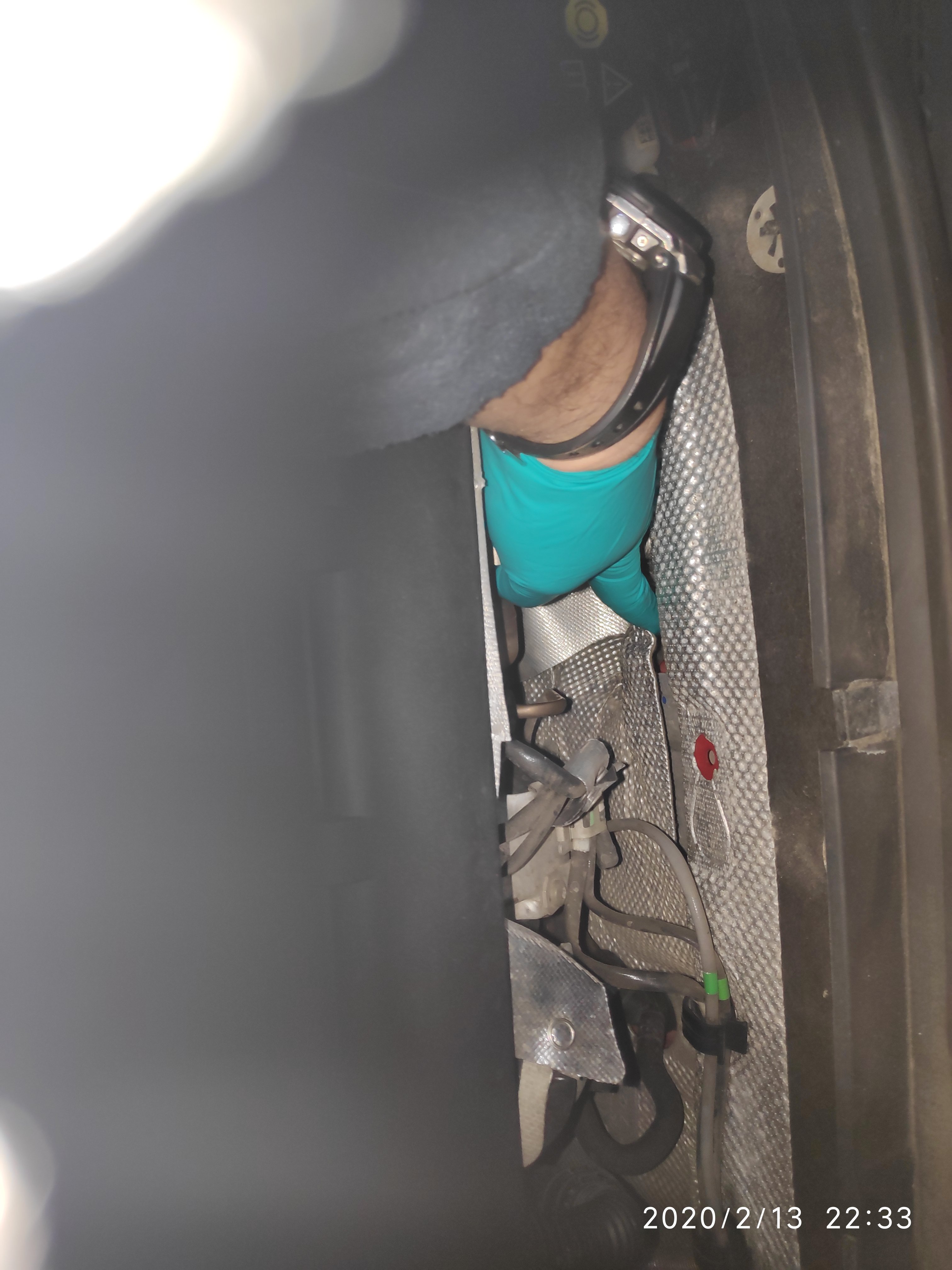

Hi i have something similar on my one, only between 1000-1200rpm and again between 2000-2200rpm. I think i pinpointed to the heat shield on the bulkhead resonating as has a loose corner also no sign that used to be a fitting there...

Can you please point that with a picture or a photo? I think it might be the source of my problem. It will help me massively... Thanks!
I will when i get a chance on daylight. And last night i noticed it started doing it at 1800 and stopped or diminished above 2100rpm but din not done it in the low revs above 1000...
I read around the forum is a common issue with the ac pipes but i could not find anywhere more than that comment. Not sure if is the same with what i think it is but following the ac pipes from left front to where are going in to the dash i have seen the heatshield and puting my hand on with cold engine and moving it to simulate vibration of the engine the sound was similar just louder and not that much buffed like from inside the car... Determining this is pretty hard as it happens under load and i cannot reproduce it in neutral with the car parked.

As for the heat shield picture attached. As stated i can not do a picture on day light. Done it last night. The sound this morning was cut in more then half but... Is something else also but big improvement from before( is not that obvious now as a sound that something is buzzing). I can only assume is something else also so i am a bit dissatisfied that is still something but now is so small i really have to pay attention and close cab ventilation and radio to hear.
When i get the chance i will get undertray off and check lower down but for now will do.

Many thanks, with this photo I will have a look tomorrow. By your description it looks exactly like my problem. Depending on the day it sounds more or it sounds less. Now I’m switching on the AC the sound seems to disappear. Does it also happen to you (no sound with AC on)?

Hi what did you actually do to the heat shield to stop or reduce the noise?
