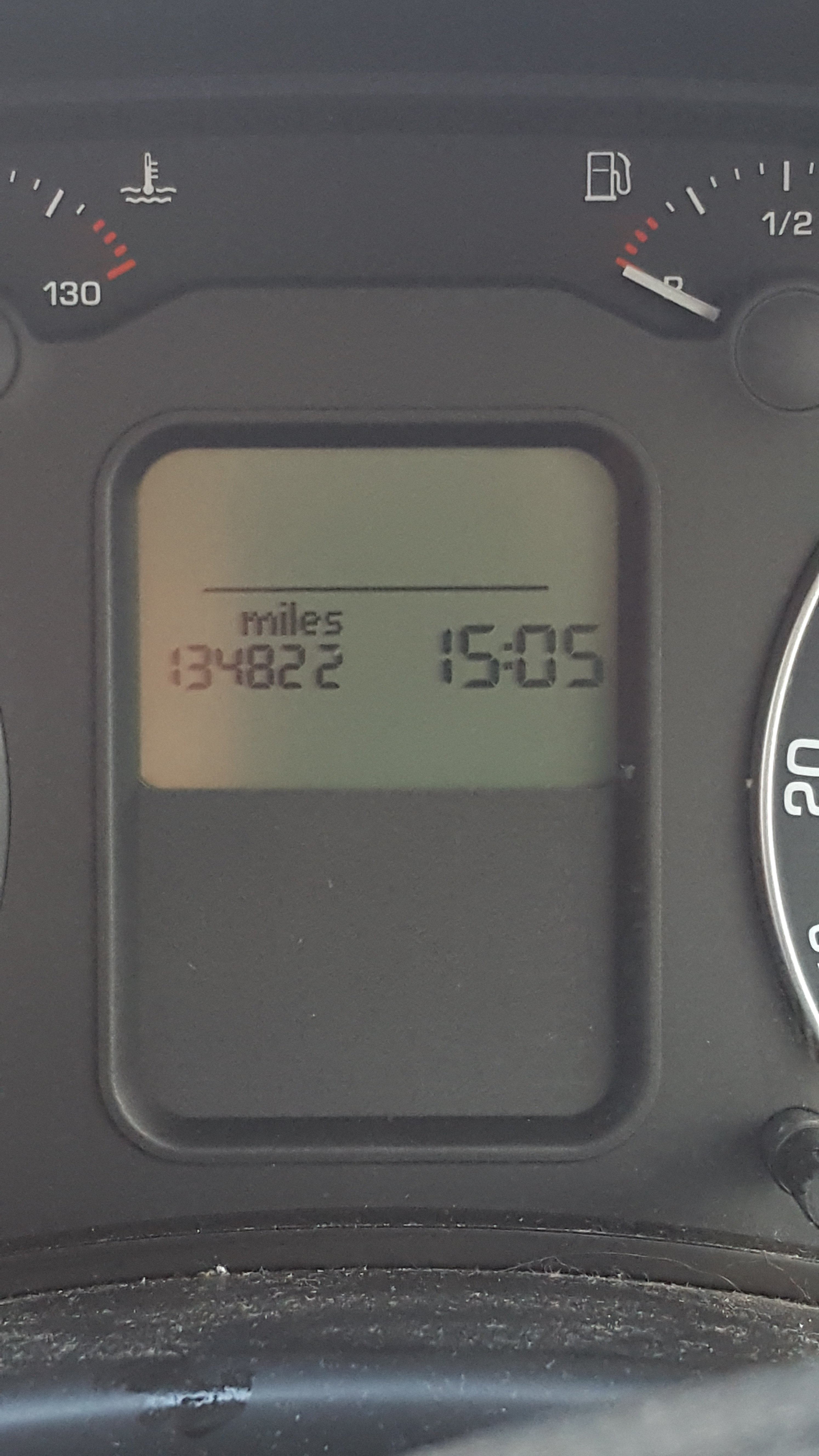

The car doesn't have a Maxidot display - see below (don't know its official name).
