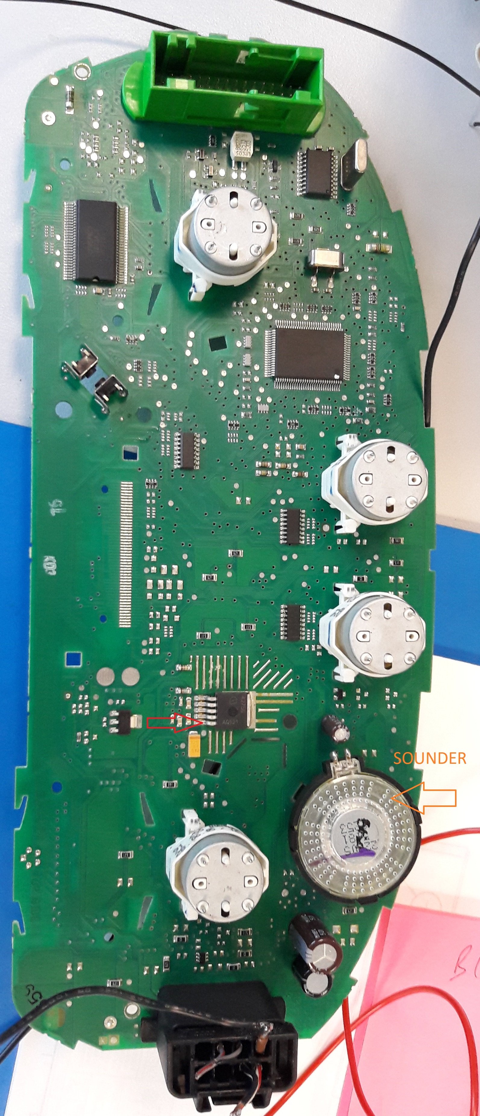

The source of the ticking may well be a piezo tweeter on the instrument cluster circuit board.  It could possibly be replaced by a louder one with the same physical footprint.
I'll dig out an image of the one on a Fabia shortly.
  • Sponsor
Here's the sounder on a Mk1 Fabia instrument cluster board, (orange arrow, ignore red one). Things may have changed of course, and the sound may be made elsewhere, I doubt too many Karoq clusters have been dismantled to look at so far, but I bet someone has, somewhere.
If you're really lucky, VCDS may be able to alter the sound level in software.
