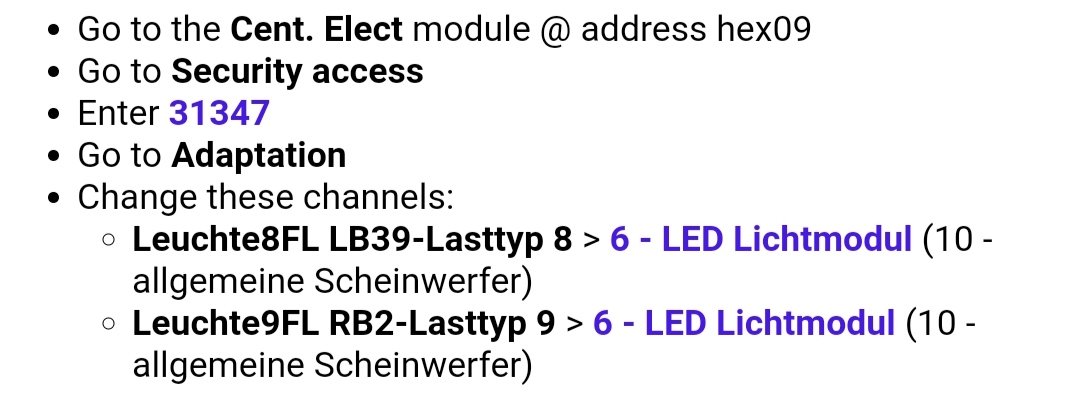

I have been searching and reading many different forums and posts, but still have not found straight info - -how to code correct h15 led bulbs, so there don't come up error message on dashboard.
I would be happy if someone could post step by step how to code H15 led bulbs with Vcds.

Here is the picture of coding.
Does it works also on high beam or only on DRL?
This is for high beam, I think that DRLs are Leuchte4FL and Leuchte5FL so you have to change lasttyp to led.
My DRLs are changed on foglights, so I did not have to code for that.
Thank you for information.
I will try it.
Will give a feedback afterwards.
@Braun_BiH
Thanks for info. All went OK.
Only issue is that, I can't deam DRL, they are little bit to sharp in night time.
