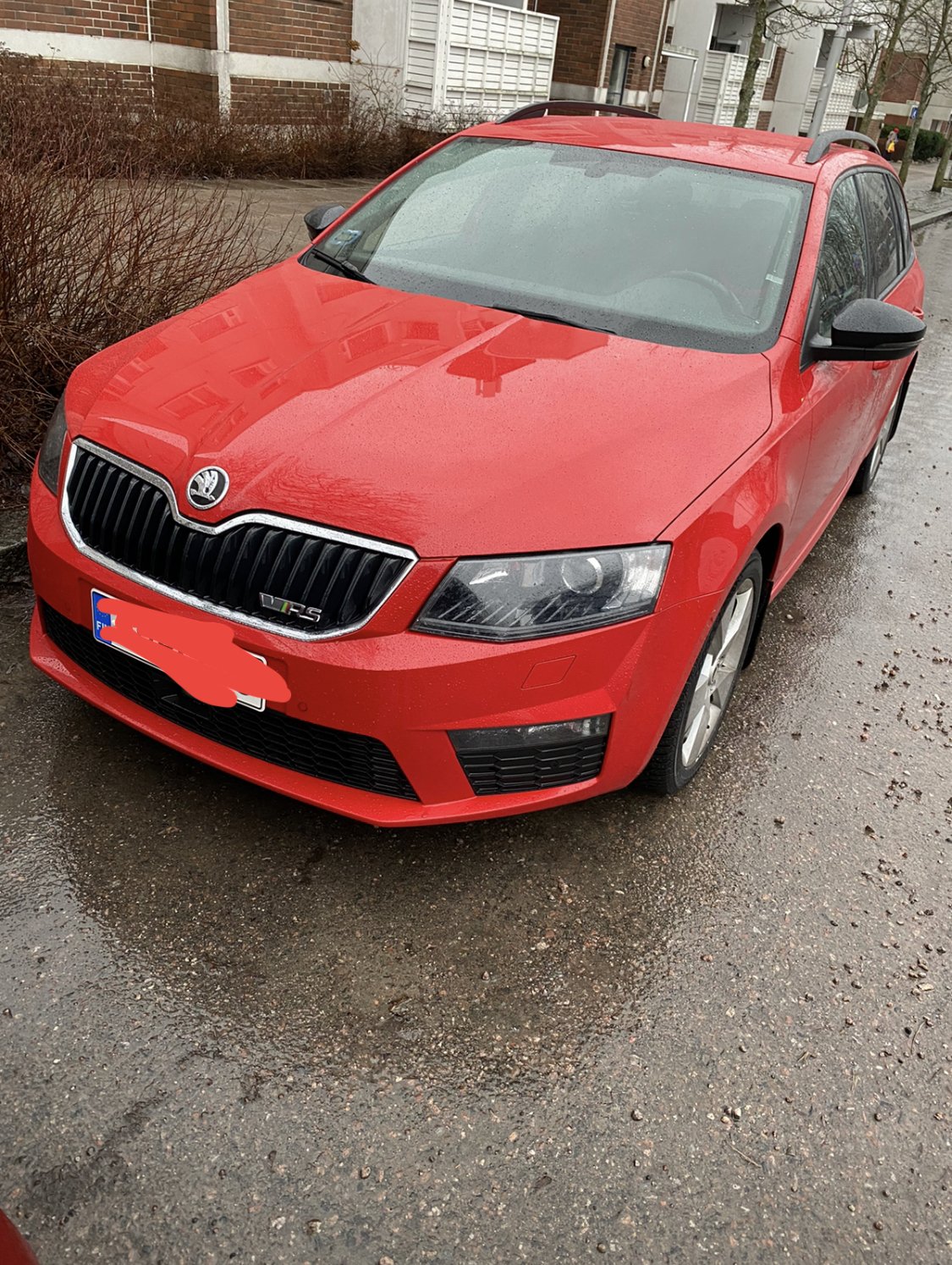

Okay so I am now an owner of a TSI RS!
Ended up pushing my budget up by about 4000€ to get a car with just 103,000km and in really good condition.
The car with 190,000km was an OK experience, but there was something going on with either the DSG or engine. When fired from cold, it did a weird noise and actually stalled on the first lights completely! After that, during idle, the rpm kept jumping and the car was really ”bouncy” as well. Could’ve been just that it hasn’t been driven in a while, but I decided to play it safe.
Really happy with it and actually got some nice additions such as Webasto and towing hook with the car!
