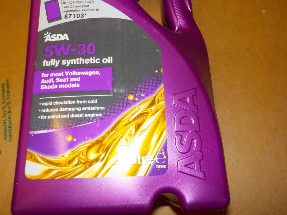

5 litres of 5w 30 FS III to VW 507 00 in Asda for about £20-24 is perfect.  Maybe even being cleared cheaper just now.
16 hours ago, Roottootemblowinootsoot said:
@cypher007
I got some the other day from Asda for £19 not bad for 507.00 oil
I've been using both the Asda or Tesco oil to 507.00 for the majority of my oil changes with absolutely no issues in 48 months and 65,000 miles ... Normally changed every 9,000 miles which was until last October about every 8 months... I'm now only doing a return 10 mile run per day to work so will be lucky to do 4-5,000 a year so it'll be once a year now .. Maybe twice I've still to decide
