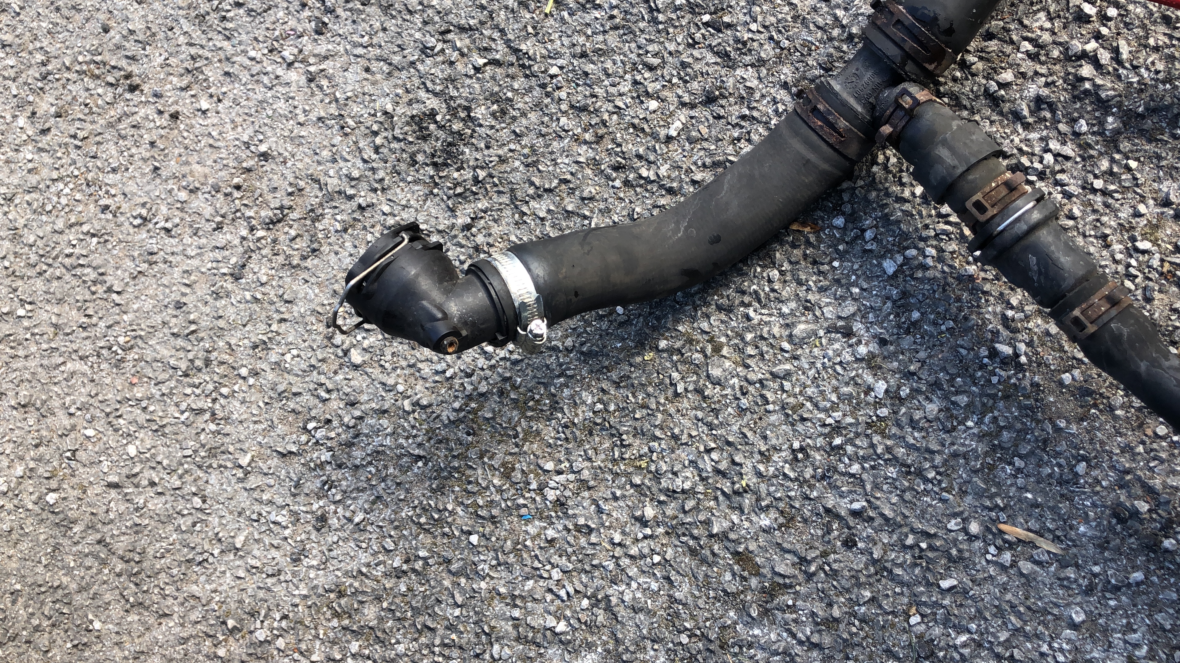

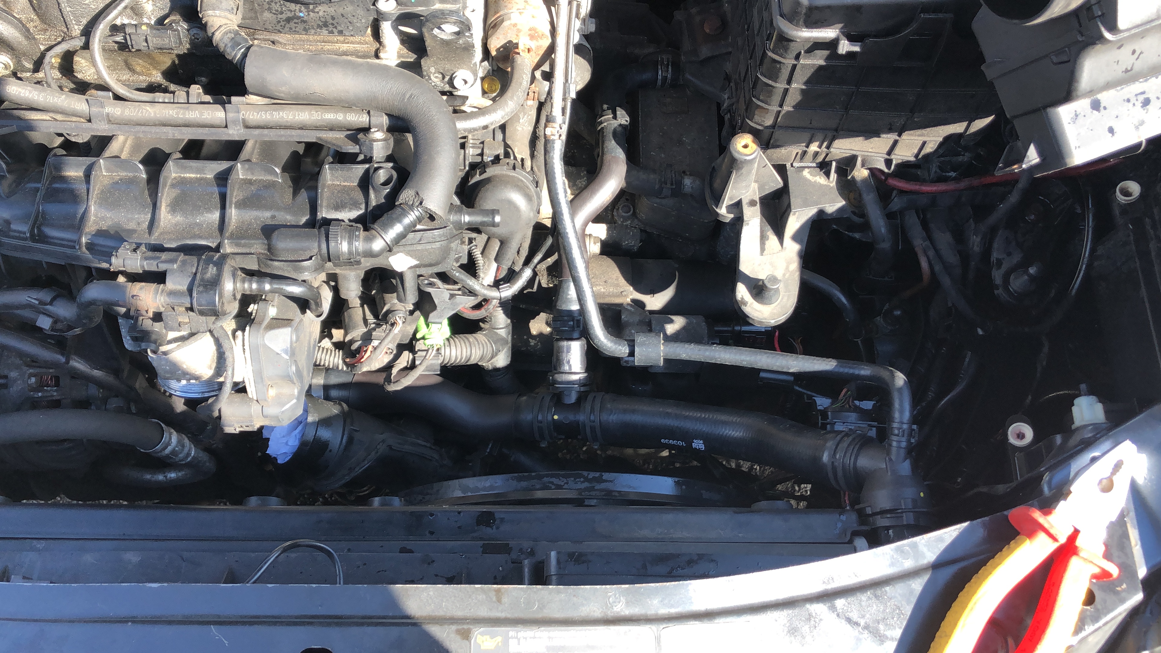

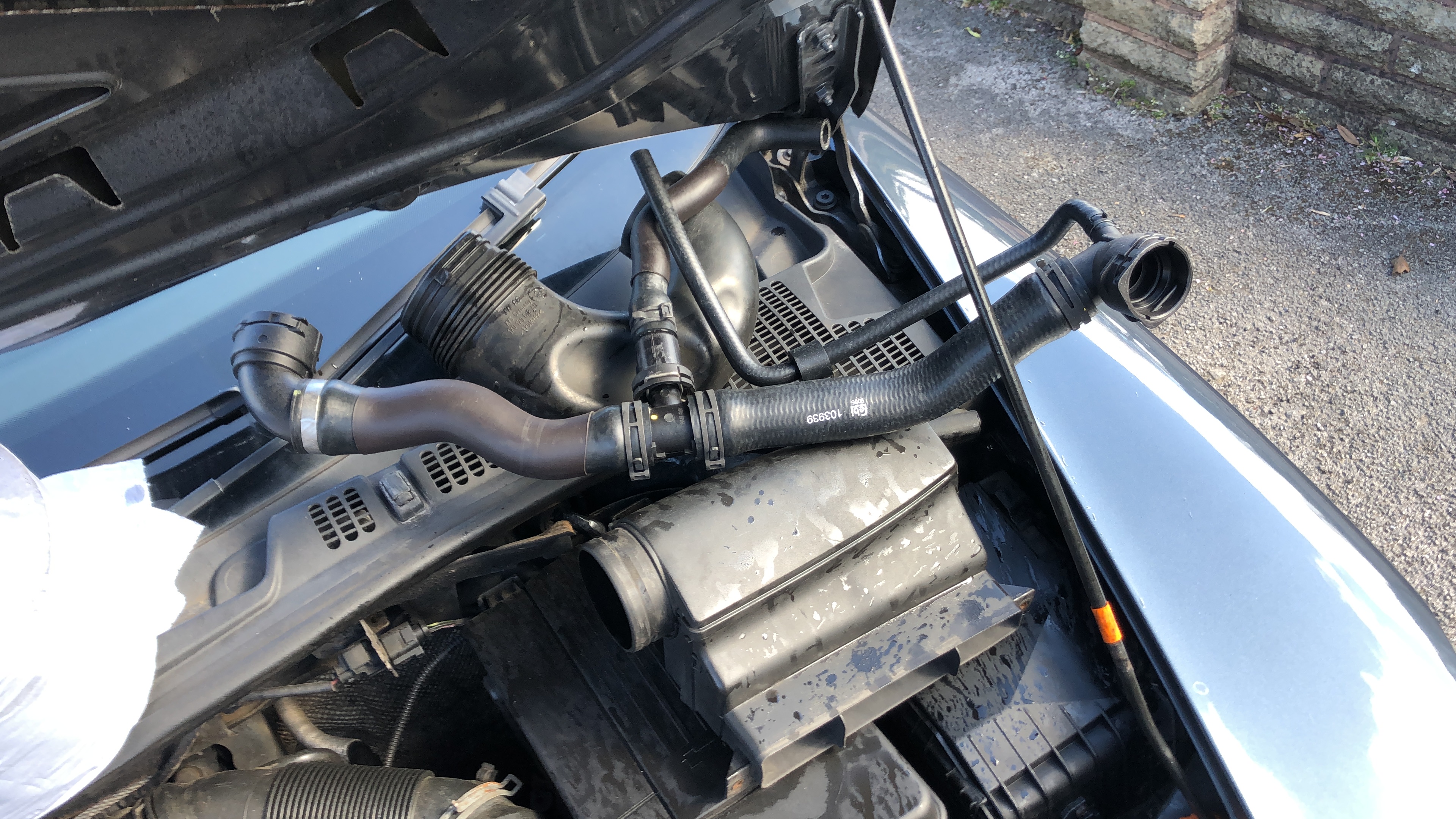

So I’m having a couple of days on the Octavia, today started off with a coolant leak, the car dropping most its coolant and me driving the car back with steam coming out the bonnet 🙈🤣
luckily I had seen this run of hose had already started to weep so bought a replacement ready to go on.
as you can see the plastic barb for the turbo return has snapped off 🤦🏻‍♂️
replacement from auto doc
Brand new again 😎 and no more leaks

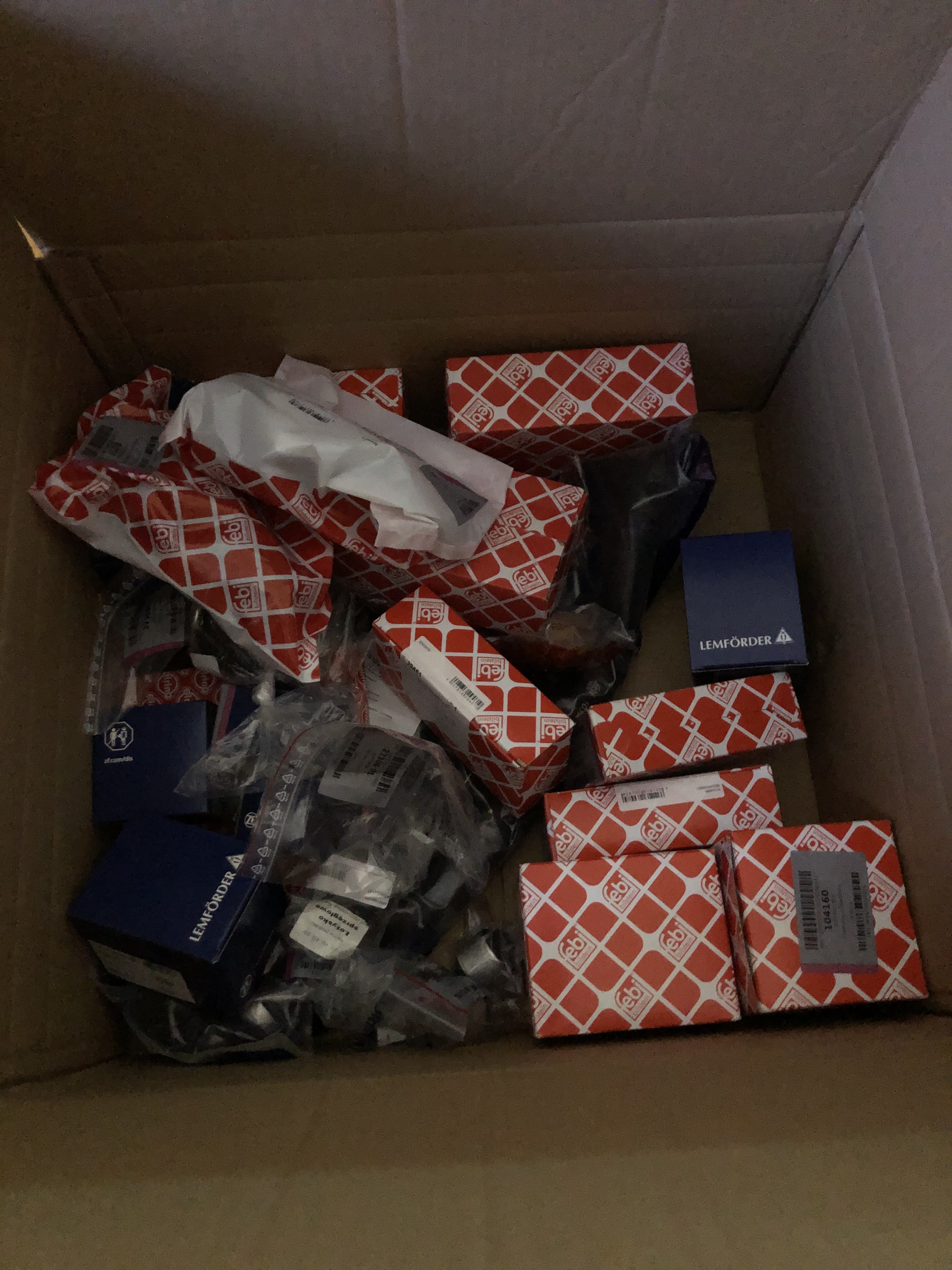

I’ve also been gathering more bits, so the bushes have turned up, I have bought aluminium wishbones and hubs to help lighten the weights up front
enough to keep me busy for a while there 🤣

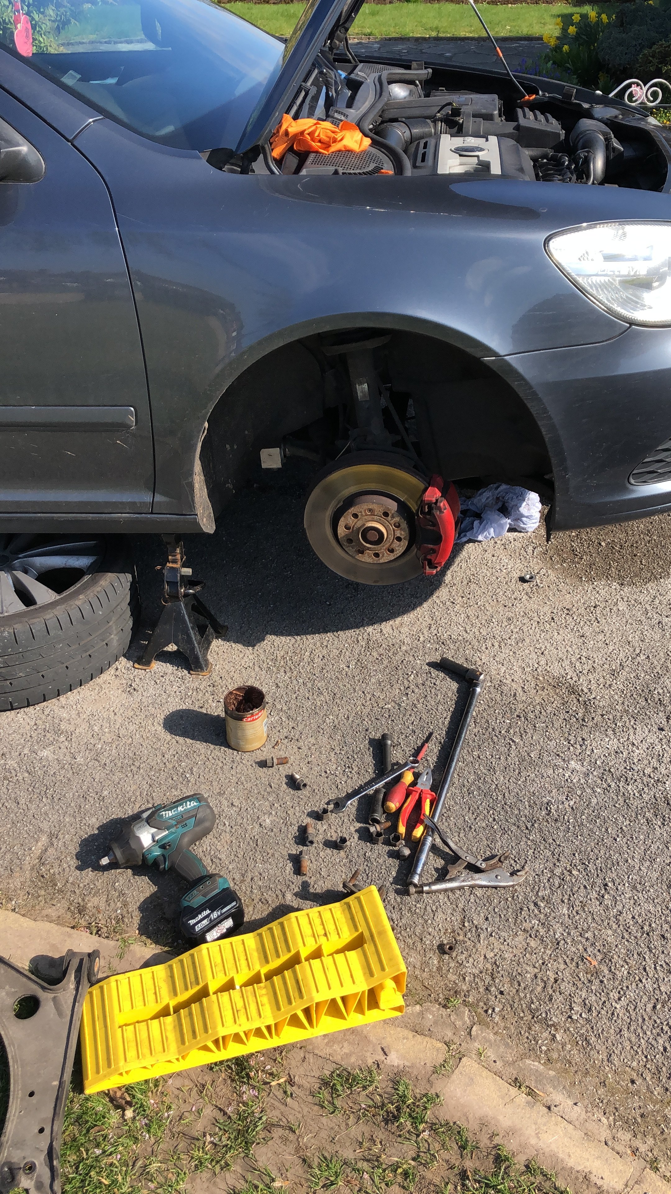

I wanted to do the wishbones today but they hadn’t arrived and I didn’t expect any deliveries on good Friday but today they turned up so I was well chuffed, I was in a rush and was just going to replace the rear wishbone bush on the standard arms but once I got into it I just thought it would be pointless doing it twice.
I was chuffed to bits when these turned up 🤣🤣

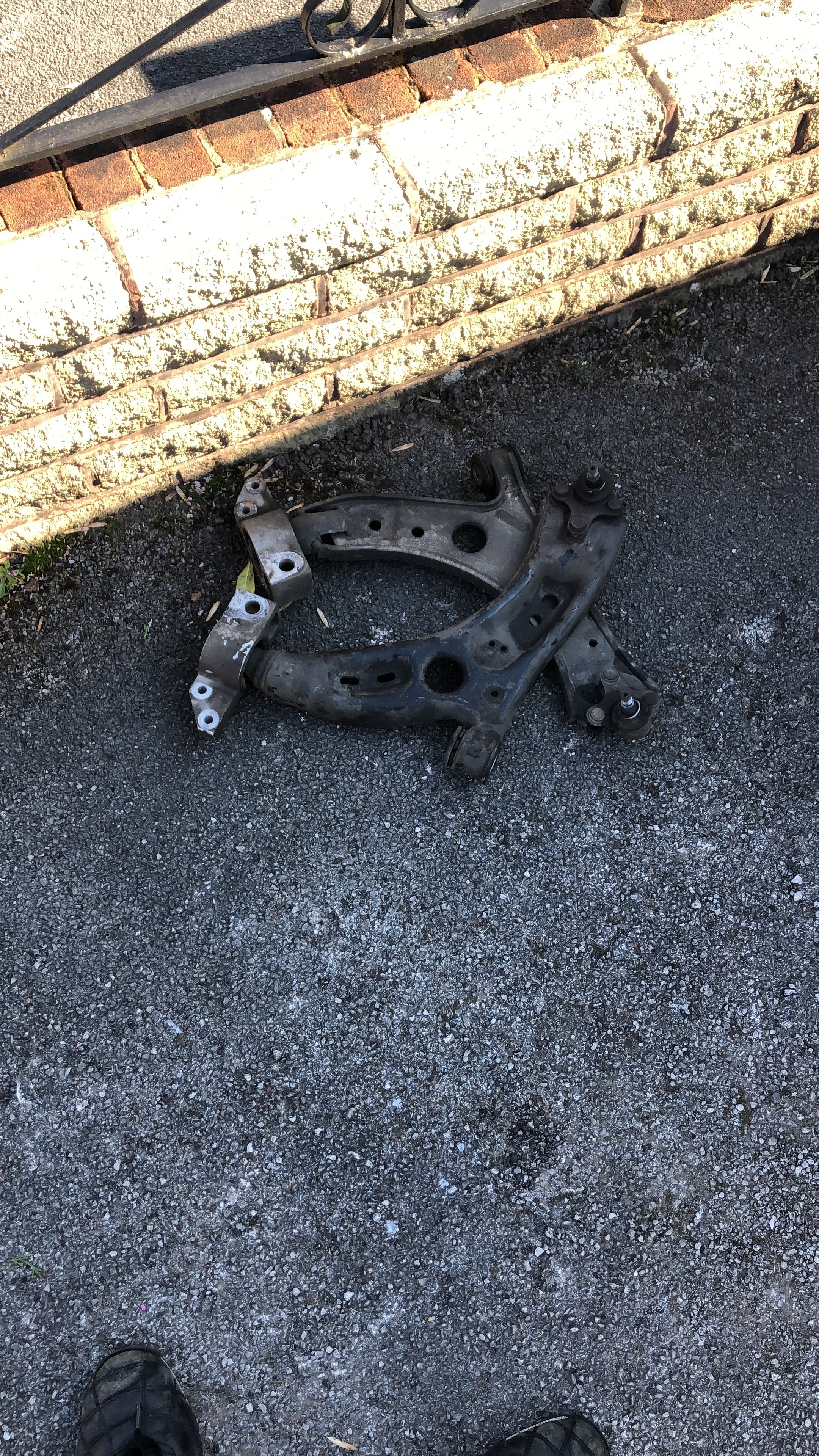

Didn’t take many photos at this point, I replaced the rear bushes for solid S3 ones, and the ball joints where good and the front bush was fine also, although I do have replacement front arm bushes.
first time the wheels have been off on the front so had a good nose round, the arms went on quite easily
old pressed steel arms, they where different types, unsure if just a superseded part or not, but once I fitted the alloy arms the tracking was miles out
The tracking was so bad I didn’t want to do over 30mph 🤣 it’s the worst car I’ve driven 🤣 rushed round to find someone to do the alignment and Halfords managed to fit me in and now it drives spot on 👍 although it will get a proper Hunter alignment but that will be once I’ve done the conversion and have all the other bushes replaced.

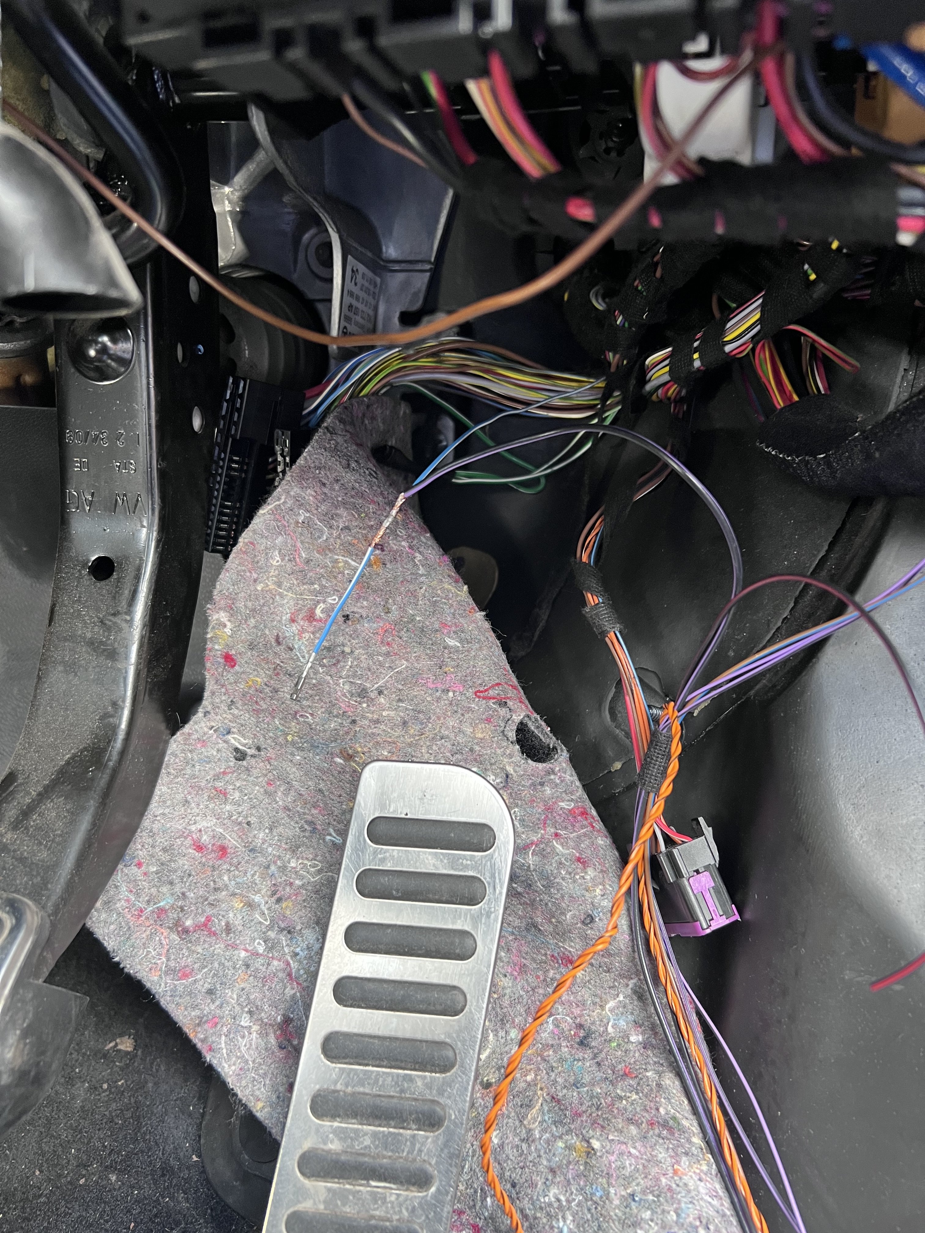

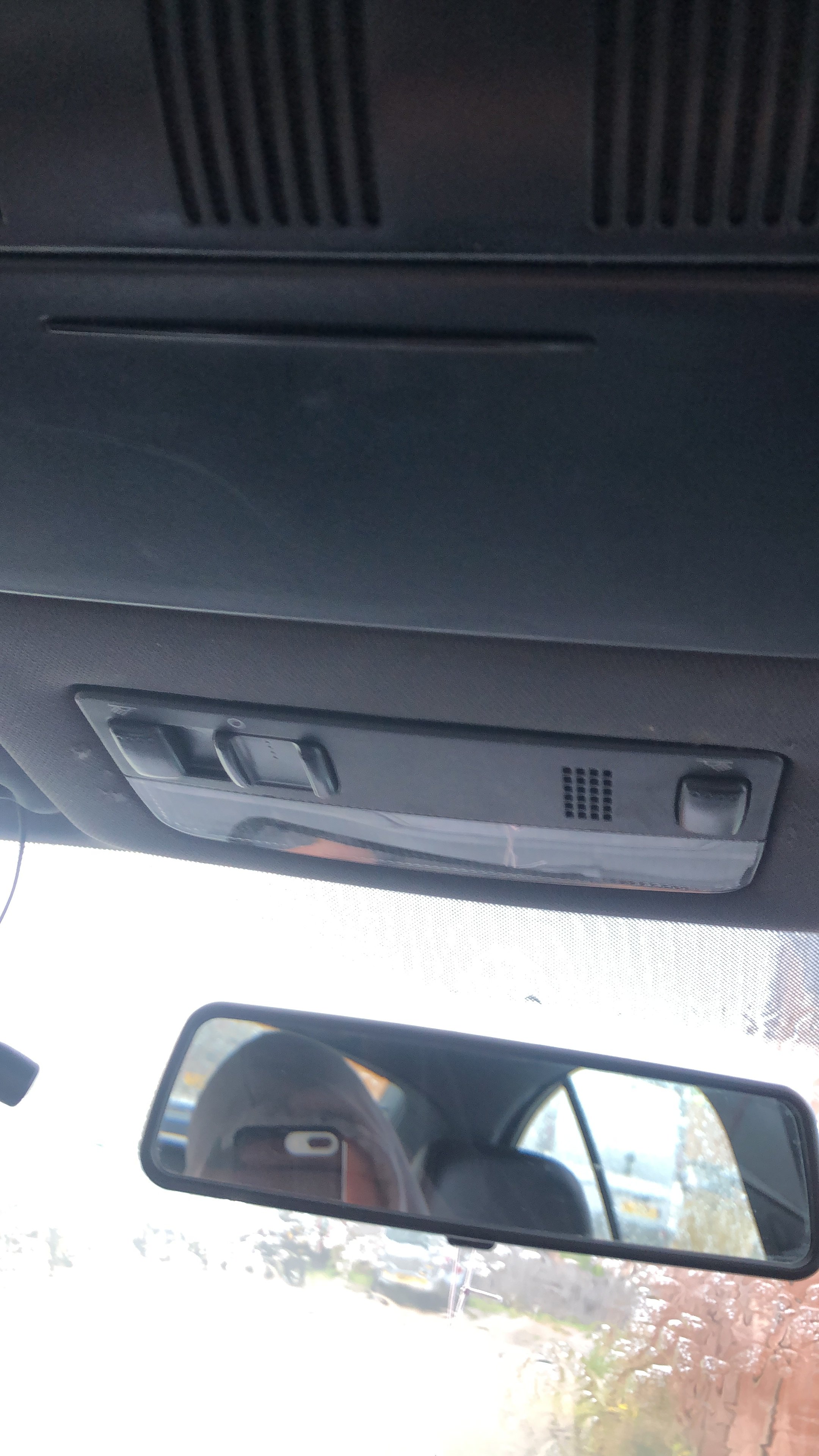

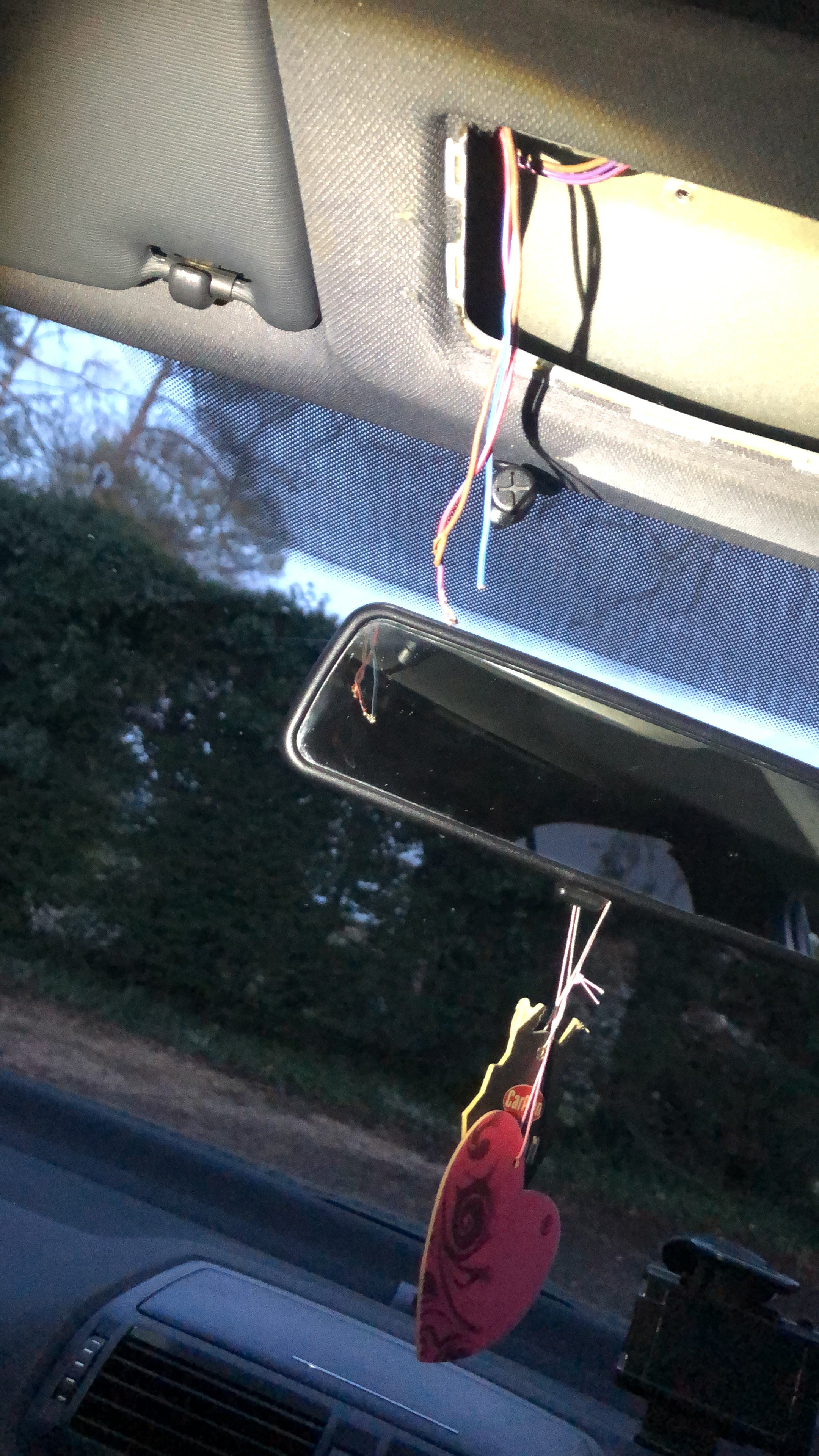

Things like when I picked it up the interior lights weren’t working. I pulled the front courtesy light out and was greeted with this?!? ED1A44EF-68AE-4332-98A3-FBB895FC8017.thumb.jpeg.5bf6eb62cc4f86cf620fb593512d9e92.jpeg
I’m still unsure what has happened here 🤣 but they where exposed wires just tucked above the light and the plug was missing, I have made safe and now the interior lights work I just need to replace the plug to get the front one working.
other annoying issues are the dash has the conmom earthing fault on it, and the interior lock button doesn’t work, but I’ll slowly work through them as i progress with the project 👍

So a LONG awaited update, I don’t forget about you guys in here, I have had the car round Donnington, it was so much fun, fixed the interior light after sourcing a plug, done a few bits and pieces, life has been manic since this pandemic has been going on.
New plug for the car so now I have interior lights again.

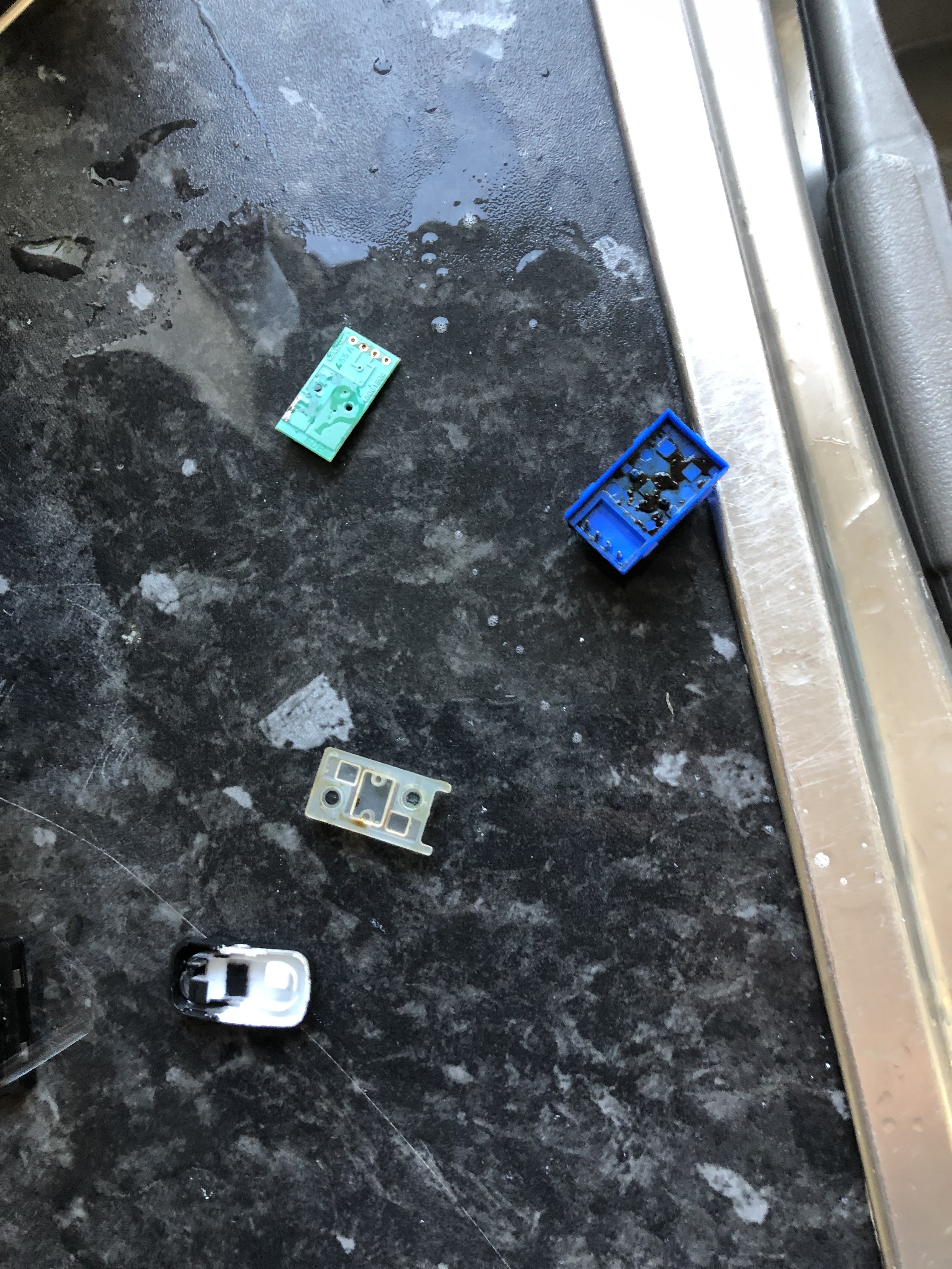

The common problem of the lock unlock button not working, all the scuzz and Coca-Cola got washed off first and then I went about soldering the pins to the plug to cure the bad contacts.

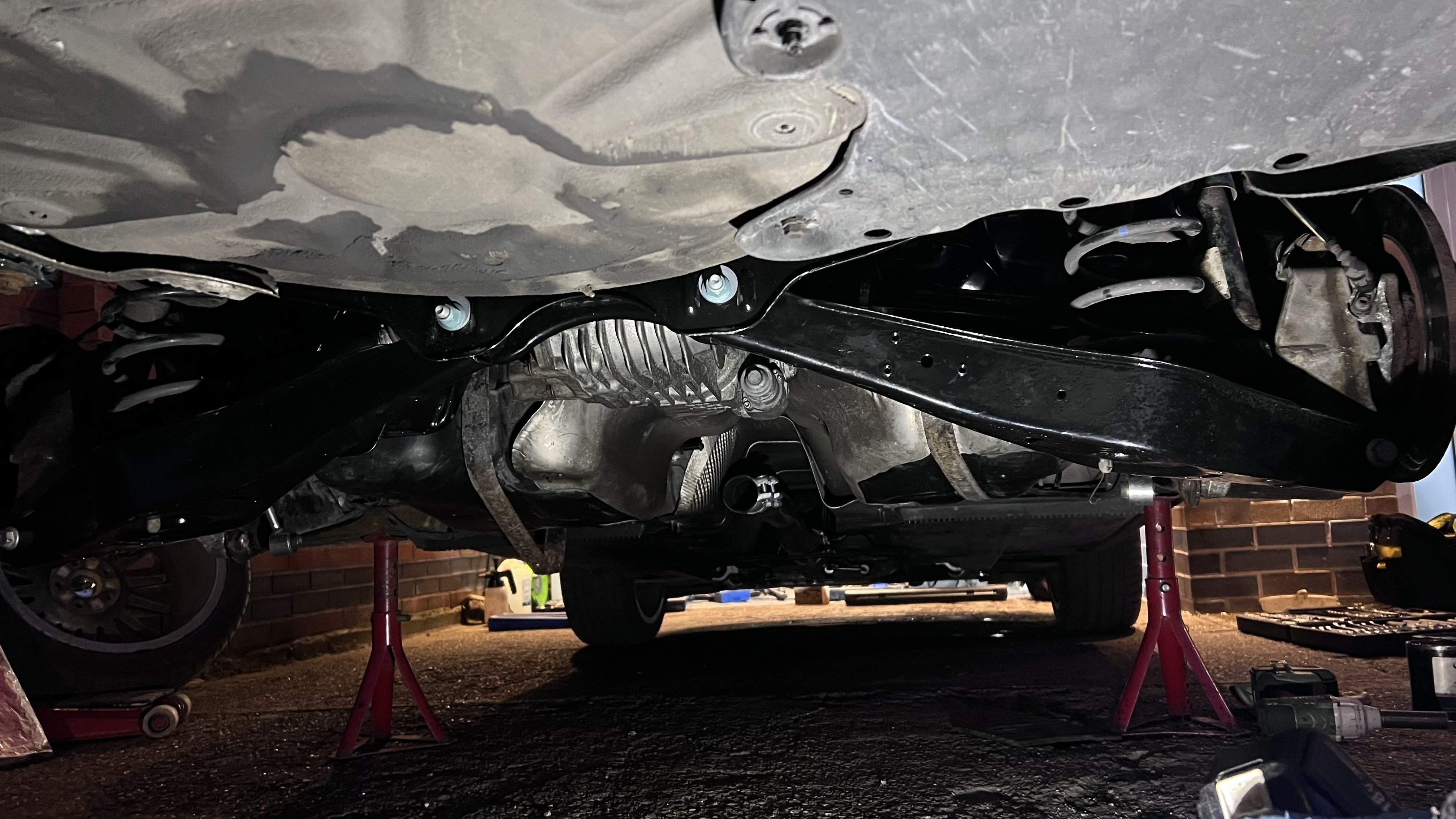

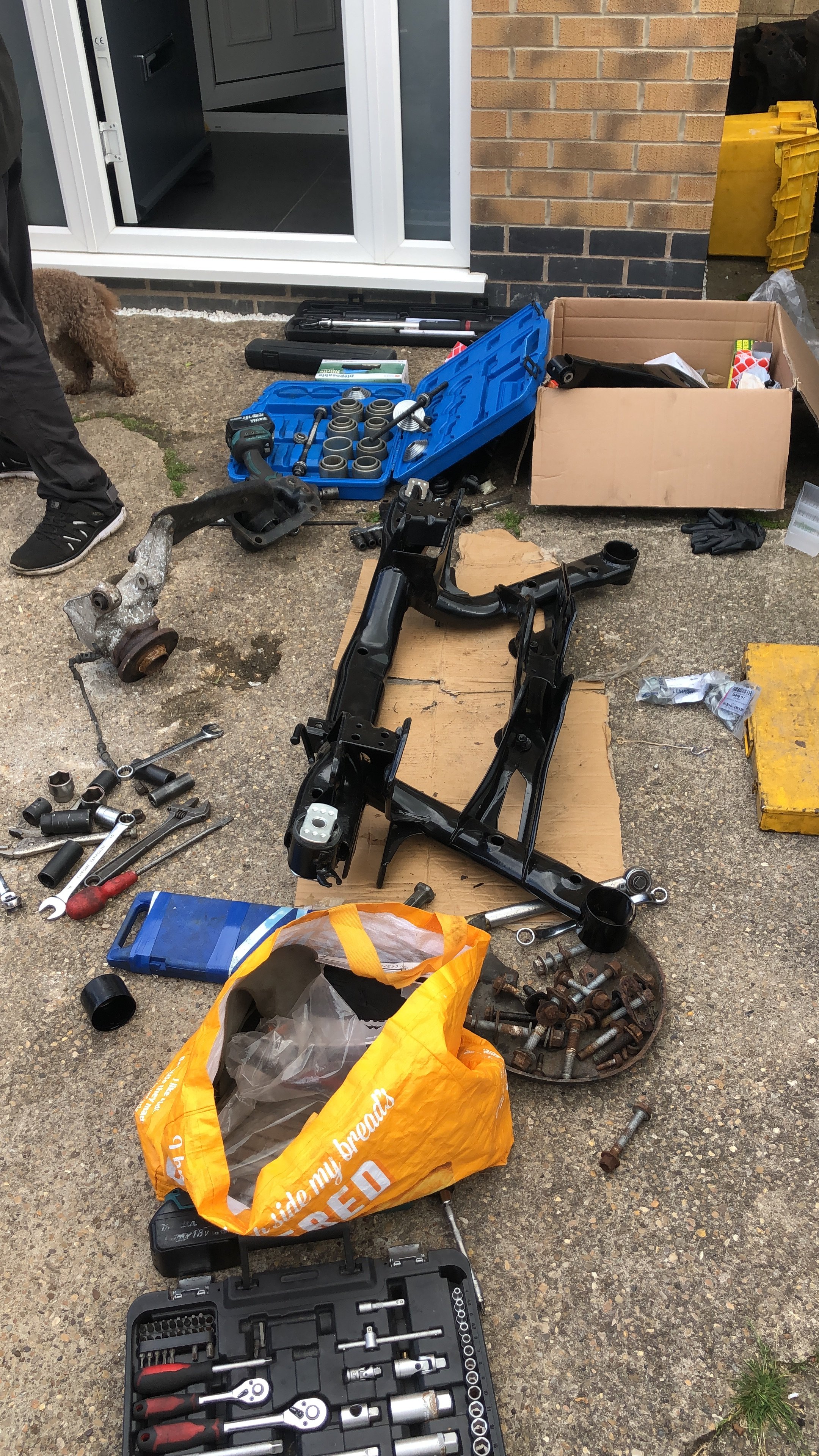

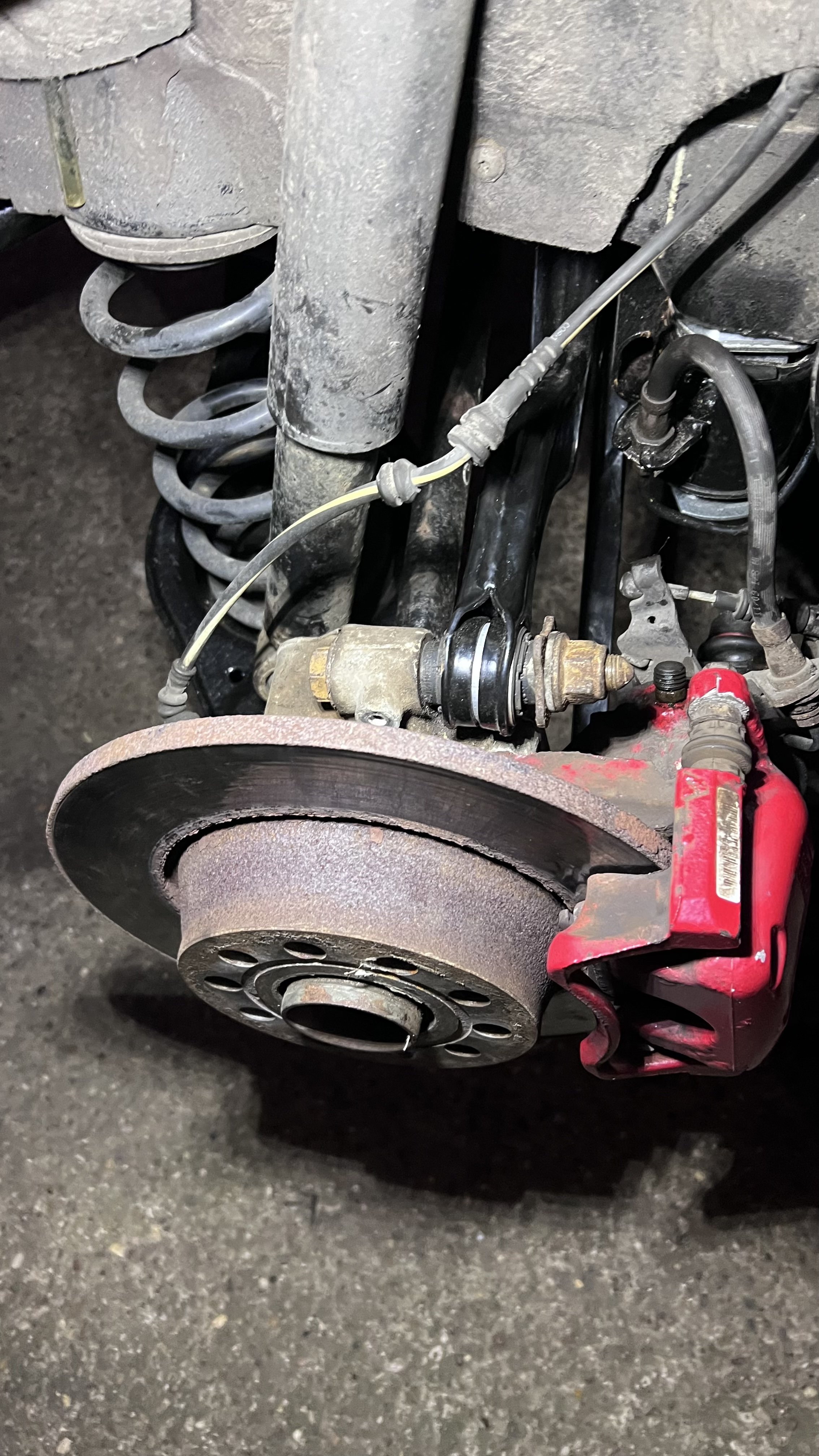

I started building the rear subframe a while ago, I was short of some of the bushes, but got most the arms on and bolted together, but the subframe sat like this for over 6 months.
As of today now you can see there is a sneaky driveshaft in that back hub now 😁
and there is that lovely haldex all ready to help with putting the power down 😁
I overlooked a couple of bits to my mates annoyance, so I’ve got to source a few bits and make sure i have the wiring up of it all in my head ready to do it blindfolded.
So now we have a taste of it, in two weeks time we are set to fit the box and the prop and then off for an exhaust to be made for the rear, nothing fancy as I want to keep it as a sleeper, but I’m extremely excited to see this car done now and just see how different it drives with 4wd capabilities 😁

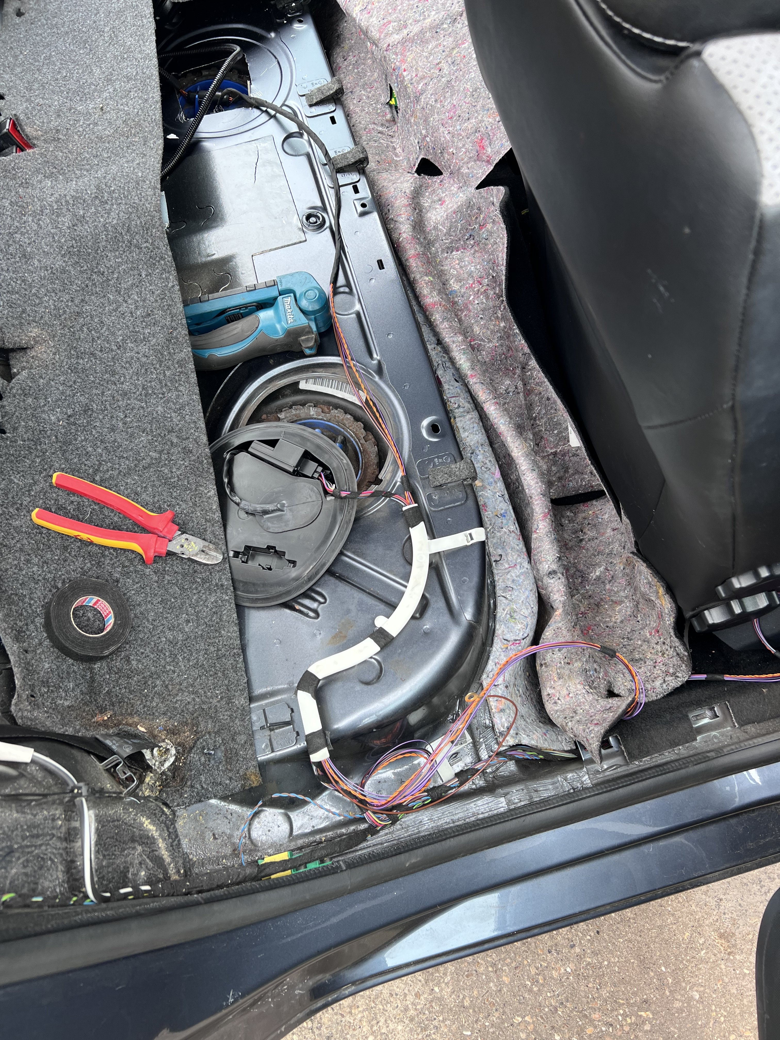

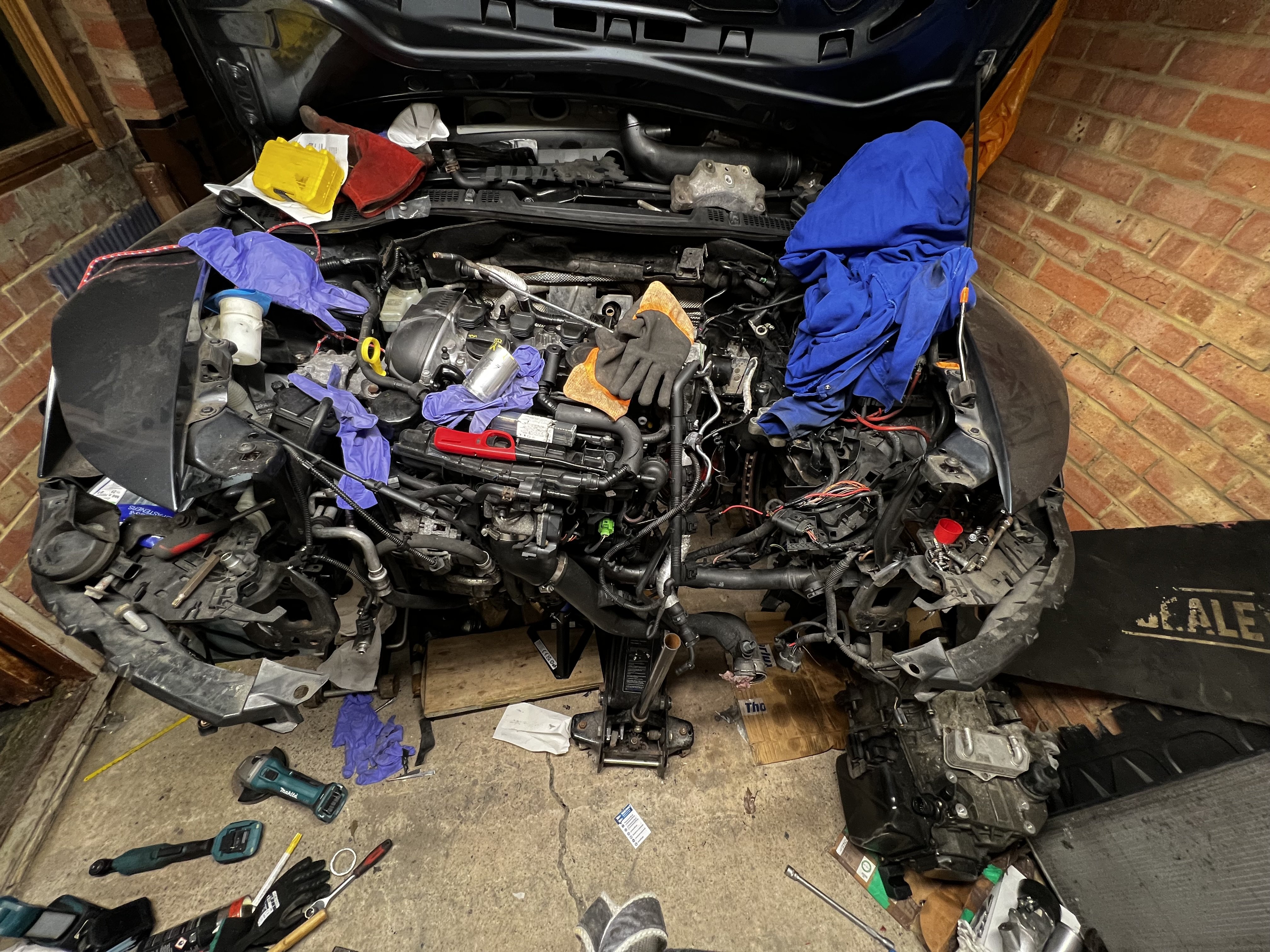

Thanks guys, we got the box in yesterday, really excited, there is no prop shaft bearing support mounting point on a none 4wd shell so I’m just trying to get a cut out off a donor to weld up as we speak, it drove on the 4wd DSG box so I’m well happy 😃
it’s so close now, get the prop support sorted and then the heat shields and the prop installed, custom cat back exhaust and the wiring and it’ll be fighting fit, there is a bit of tidying up to do on the rear too as it was rushed but not a lot and it will look OEM underneath which is just what I wanted 😁

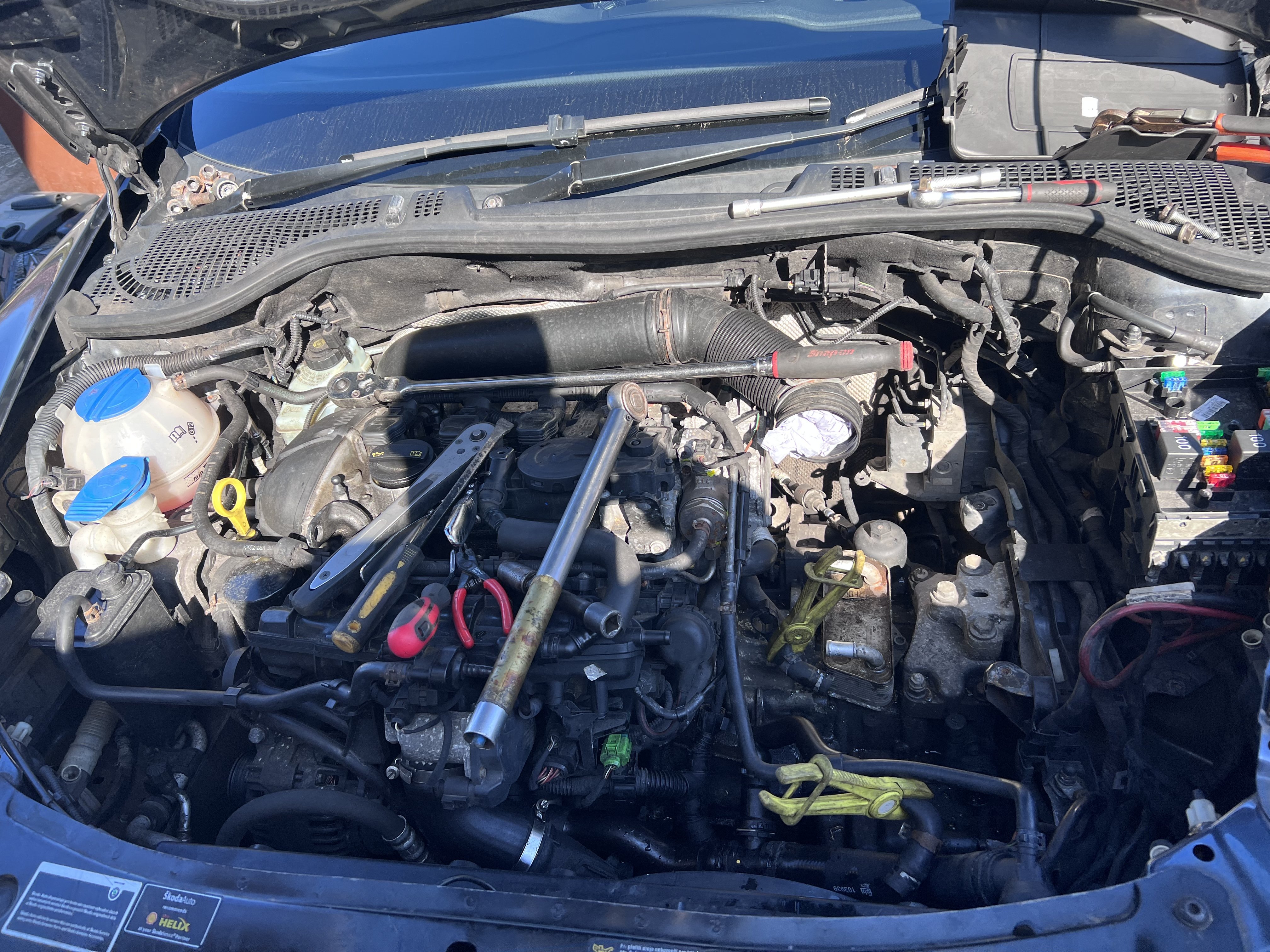

as always, I’m rubbish with photos, so here is one of half a stripped engine bay ready for the box to come out 🤣

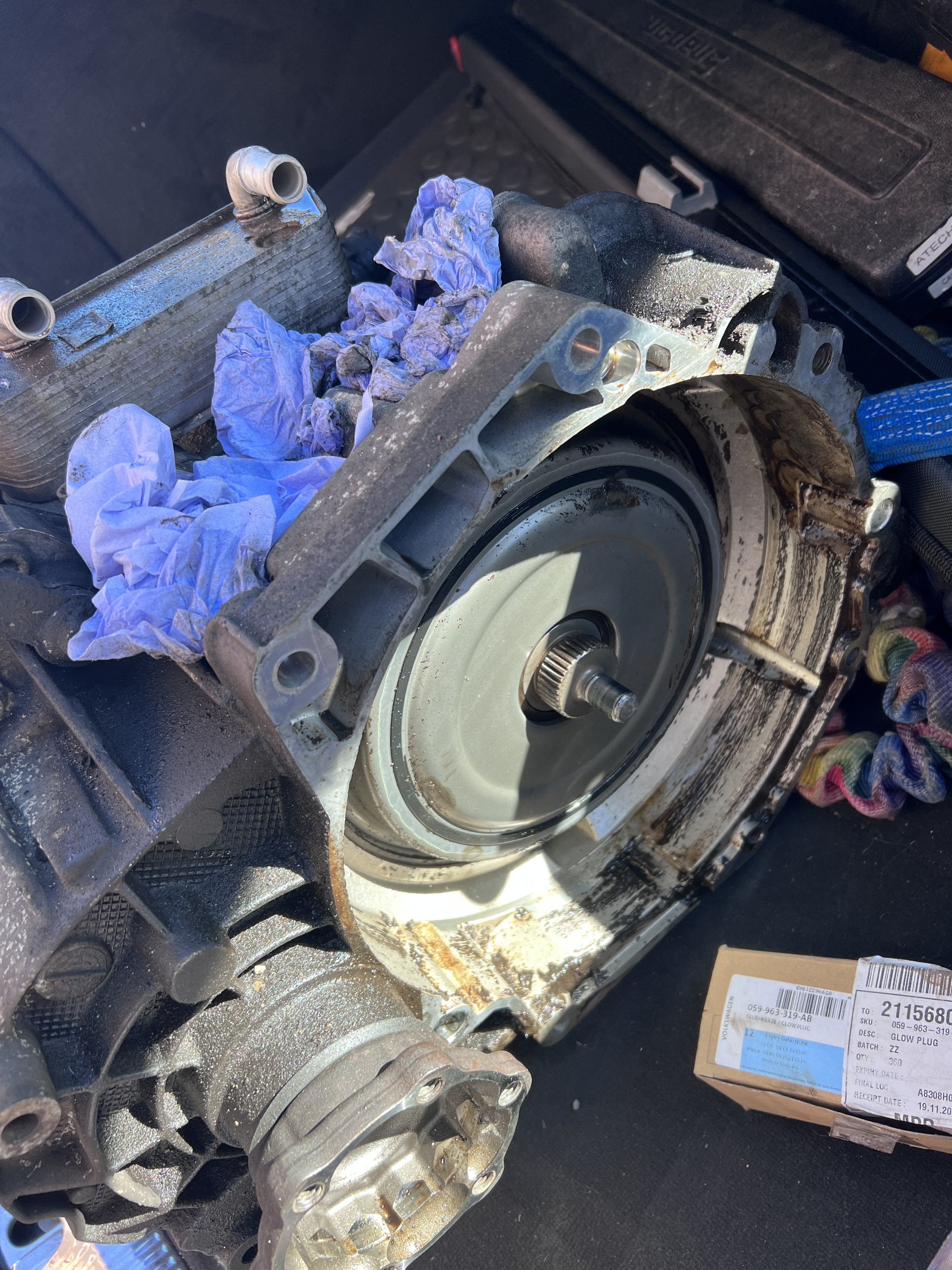

Oh and best but now is that I can clean the engine bay properly as this box doesn’t leak like the old one 😁
you can see how gopping it is inside the bell housing from the large inner seal that has gone.

Load of other bits like having the AWD box leak fluid like the 2wd box did, finding out that it was due to a crate engine being fitted in 2014 and not having a spigot bearing installed 🤣
Which then led to the K04 install whilst I had the box off, failing mapping first time round when we couldn’t get enough fuel into the engine.

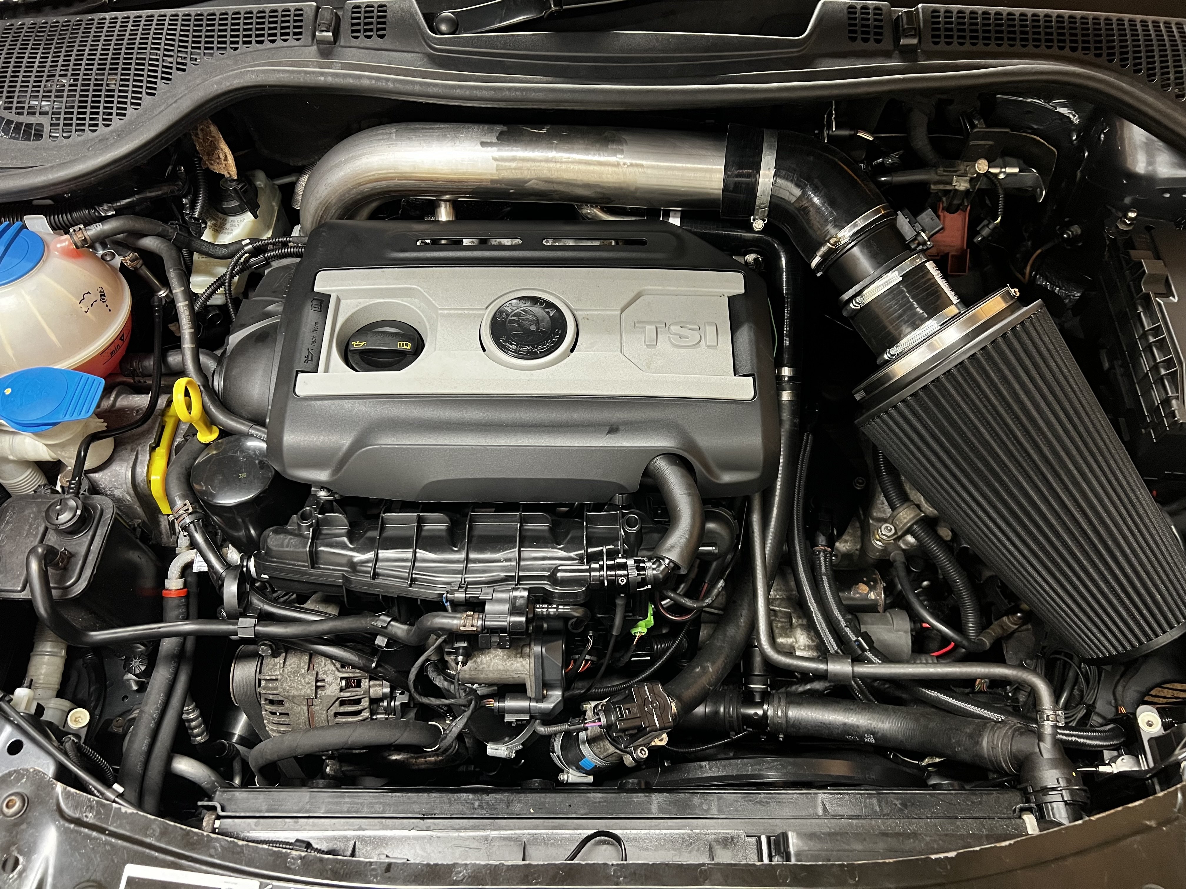

engine bay pic is of how it stands now, I do have a different take off plate for the oil cooler, so I can go back to using none modified oil filters, and the cover and turbo coolant pipes will sit like OEM again.

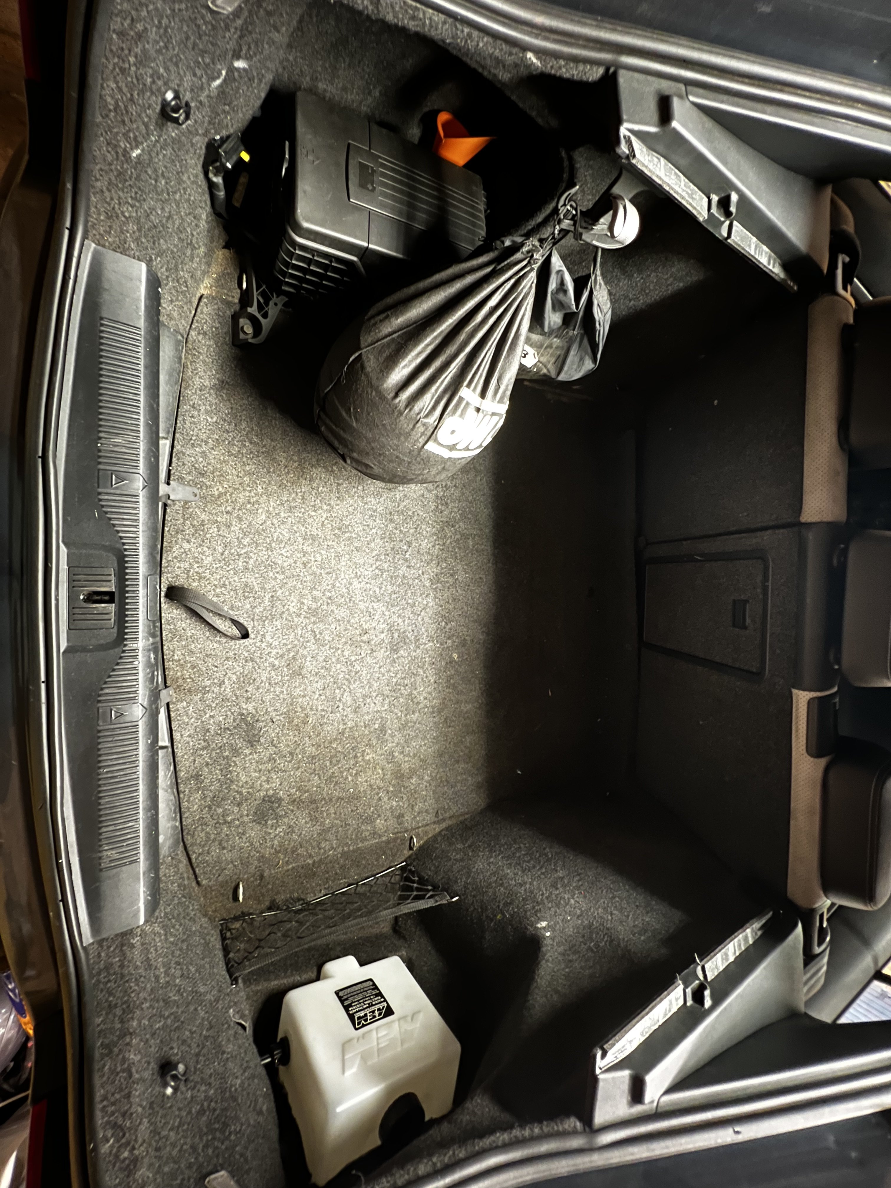

boot install of battery and meth kit, I’m fairly happy of how it stands, I’d like it a bit neater but it sits ok so will stay for now.
