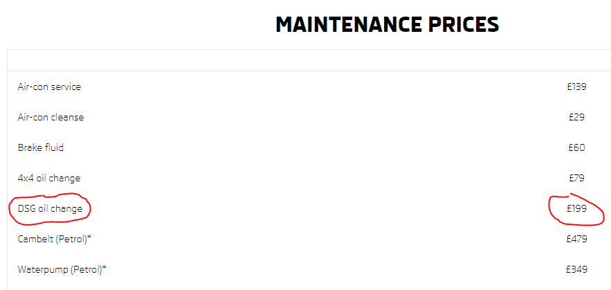

Mileage isn't the only consideration when it comes to preventative maintenance. Time is a factor too.
Low mileage suggests infrequent or short journey's. Oil, including gearbox oil, does not get properly warmed through and can speed up it degradation.
For the sake of £200 I'd be tempted to have the DSG oil changed now that the car is 5 years old.
https://www.skoda.co.uk/owners/servicing-maintenance-fixed-price
Be sure to ask if the price quoted includes the DSG gearbox oil filter. This is not an official service part so isn't changed. However this (in my opinion) is an oversight and for the sake of a few extra pounds I'd be asking for it to be changed. It doesn't matter how fresh / viscous the oil is, if the filter is blocked or partially blocked there is a risk the gearbox could overheat.
