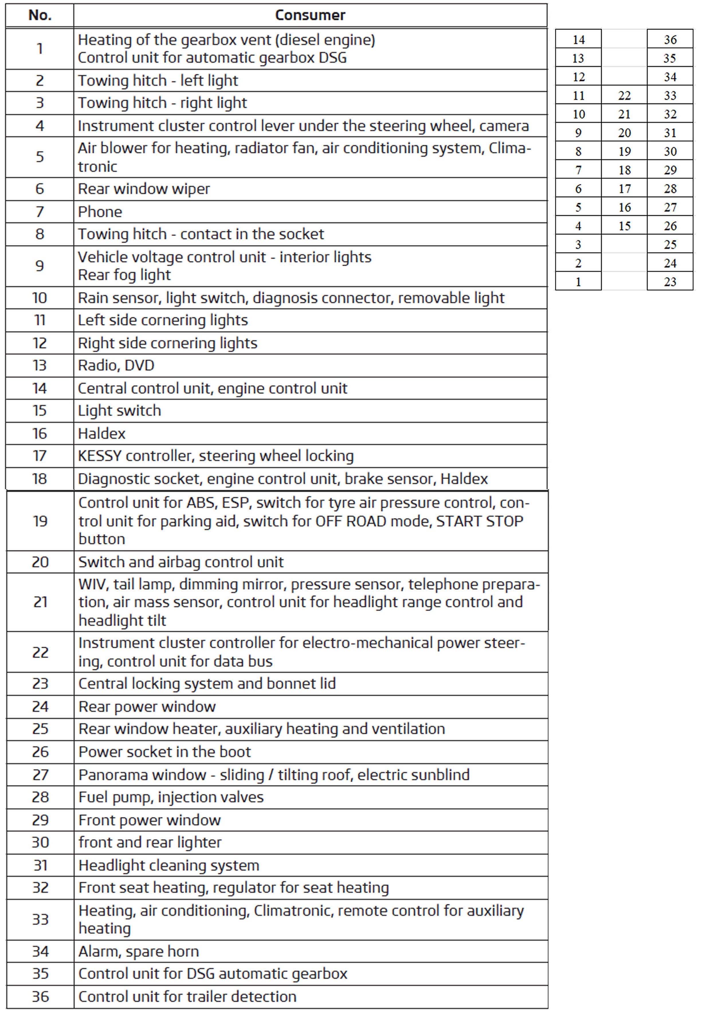

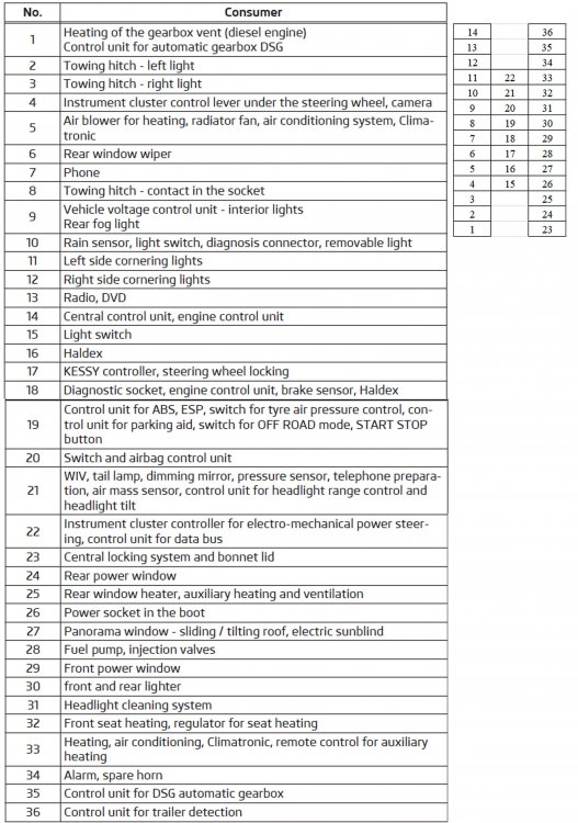

2 hours ago, Expatman said:
Thanks, tried removing fuse 8 for 5 mins,
Also supplied by fuse 13 at end of dash.
Edited by Urrell
