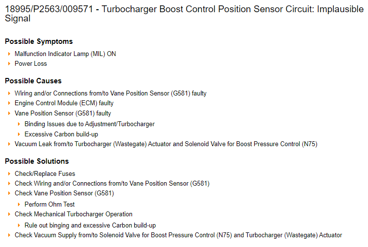

P2563 (pending) - Turbocharger Boost Control Position Sensor "A" Circuit Range/Performance

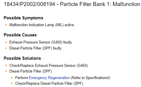

P2002 (pending) - Diesel Particulate Filter Efficiency Below Threshold Bank 1

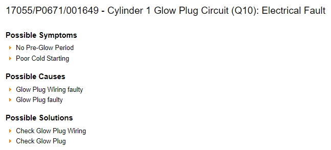

P0671 - Glow Plug/Heater Cylinder 1 (Q10) circuit, electrical Fault in Circuit
P2563 - Turbocharger Boost Control Position Sensor, Circuit Range / Performance

P2002 - Particulate Trap Bank 1, efficiency below threshold

1) P0671
Replace all four glow plugs, not expensive and easy to do...
2) P2563
Fit a new G581 sensor...

4) P2002
Replace the G450 sensor and perform a forced regeneration on the DPF. Check the ash load inside the DPF to ensure it hasn't reached the end if its life.

Don't ignore the DPF issue for long. A faulty G450 means the DPF isn't working as it should, so if it isn't finished already, if you continue to drive around in it then it soon will be.

So! Got the car back on the thursday, (new exhaust pressure sensor, glow plug, and boost pressure sensor) advised to give it a good run to make sure the dpf clears. Drove no differently than before and after 50 miles engine light returned. Back to the garage instead of waiting for the dealer to drop it off. I've got the car back today after having a new actuator fitted and it's like they've given me a different car!

Strange though, as none of those fault codes would ordinarily lead you to the turbo actuator.

Yeah its a weird one, did a lot of reading on it, found some posts on a vwaudi forum about similar issues but they struggled with limp mode as well whereas i was just down on power. Possibly the diaphragm had failed or actuator come out of alignment with low usage previous to my buying of the car. Or atleast thats my closest theory 😂
