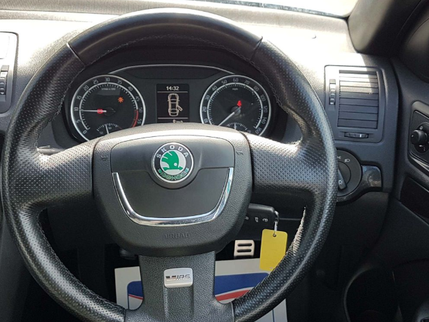

Although looking at he photos it has rear parking sensors (good) and the factory fitted detachable towbar (good or bad, good if you need to tow, possibly bad if it has been used to drag a caravan around all summer). Other warning flags are the blown bulb warning (who advertises a car, and takes photos with an orange warning light on the dash!?), and the fact the RPM is sat at 1,000rpm with an almost to temperature coolant, suggesting it is trying to regenerate the DPF,
