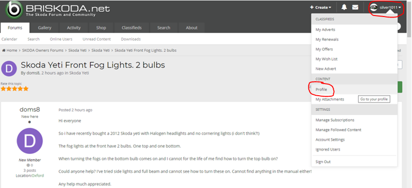

If you would like to you can add details of your Yeti into your profile here...

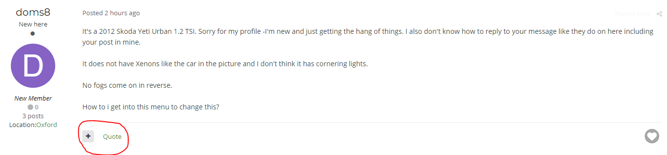

If you'd like to include a previous post into your reply you can click on the "Quote" button underneath the post you'd like to quote...
It should then look something similar to this...
