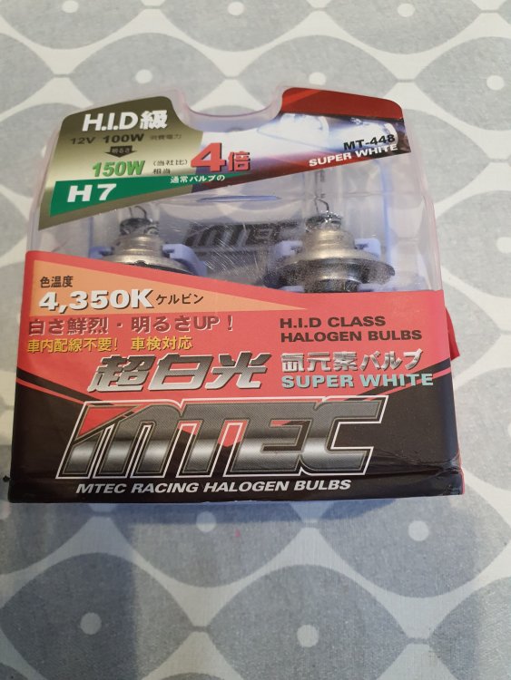

Hmmmm well, there's 2 ways to look at this
The theoretical approach:- as above
Or the practical approach:- as below
I ran 100w H7's for 2 years & there were 2 positives.
1. I saw further down the road
2. I never had to demist my head lights😂😂
