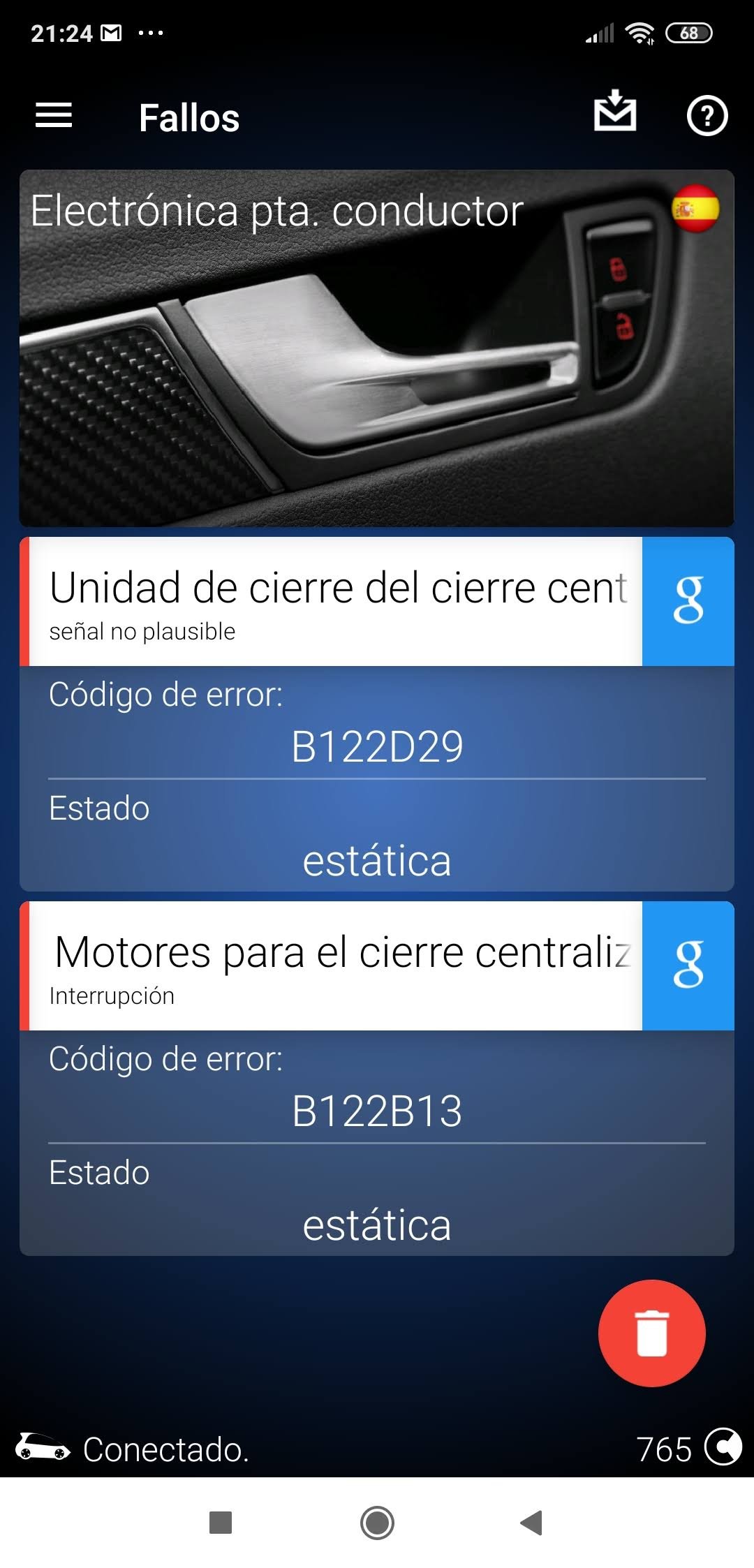

I leave a picture of the two faults  that my obdeleven accuses.

It is either genuinely a lock fault or the system has got itself into a pickle - and thinks that when it tries to lock, it actually performs an unlock.  Does this issue only effect the driver side door or is it the whole car that is suffering from this problem?

I had my driver's side door locking motor replaced under warranty, due to locking issues.
They were the car locked me out, but opened all the other doors and after locking the car, I could come back to find it unlocked!

All I know is that it came up with door locking motor (open circuit).
Since they replaced the motor, I've had no further problems.

Hi ... Well, I finally bought this article: https://www.ebay.com/itm/132299477687
When I arrive and install, I will tell you if it solves my problem.
