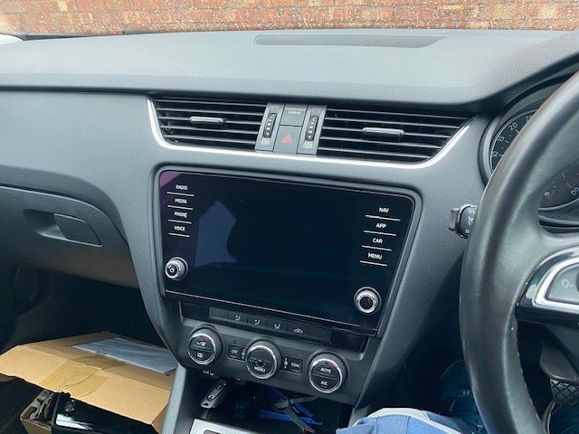

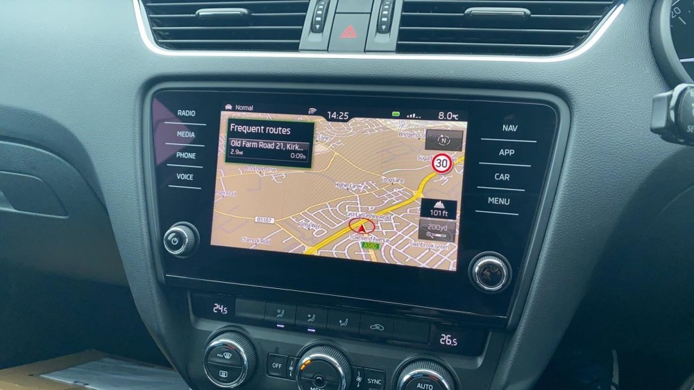

Done a nice upgrade today to replace my old 6 inch Amundsen with an 8 inch Columbus, makes a big difference to the interior.
The new screens are lovely but just so you know that’s a MIB2.5 Amundsen screen, not a Columbus one :)
Haha that sounds better so i'll take it 🤣🤣🤣 works perfect anyway
 5E0919605M thats the part number, i thought it was 8" columbus
No, MIB2.5 Amundsen. The old MIB2 Columbus is 5E0919606 and has soft keys. The 9.2 inch Columbus has no swivel wheels and is part number 5E0919606D.
Payed £99 delivered so i'm well happy, thanks for the info
