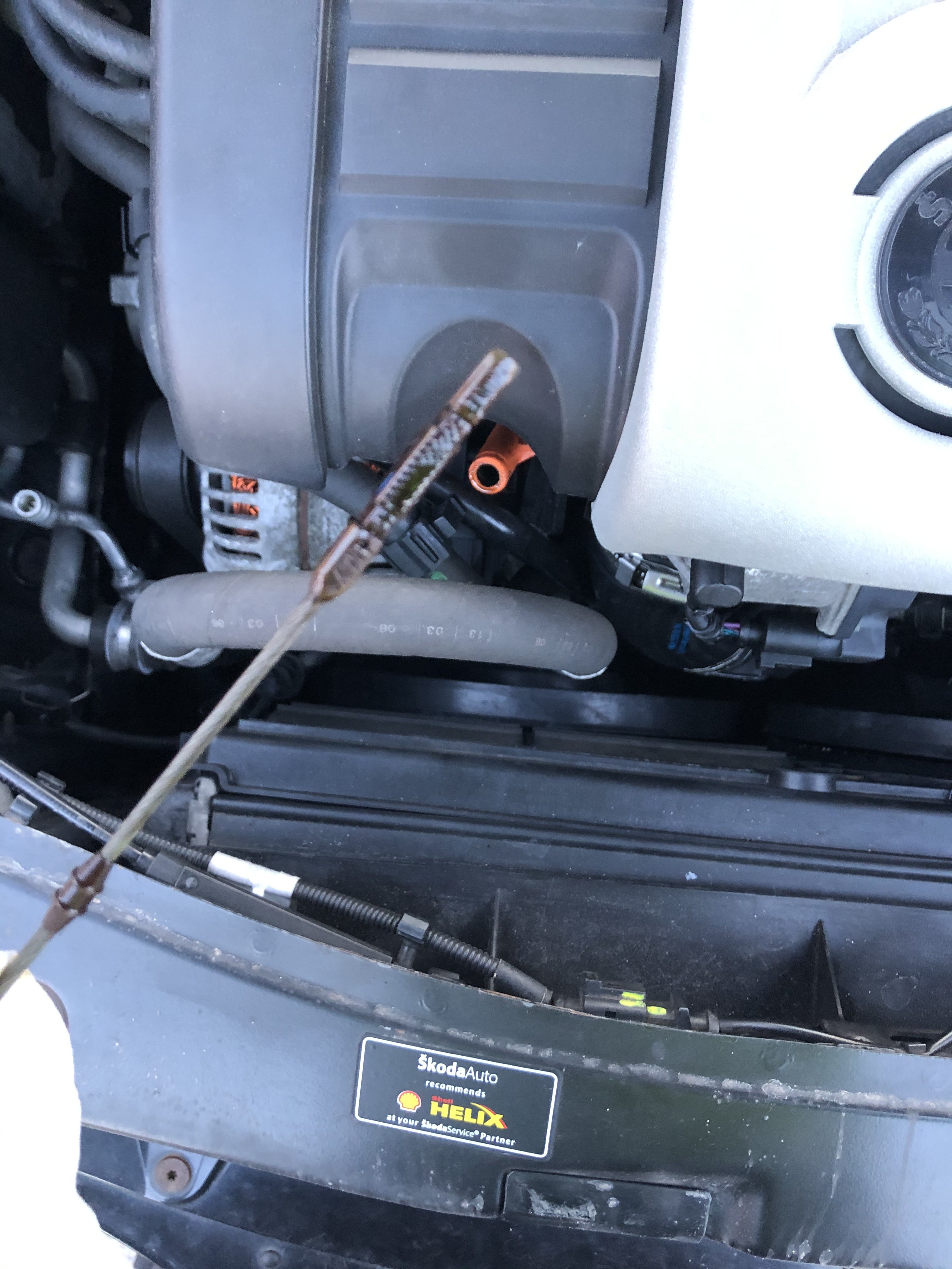

I just had to go out and top the washer fluid up in the cars so did a coolant and oil check too.
The oil was full still, I can’t even remember the last time I checked it and it’s been in since the beginning of September.
I took a photo but I do realise this isn’t exactly hard evidence, you’ll just have to take my word for it 🤣
