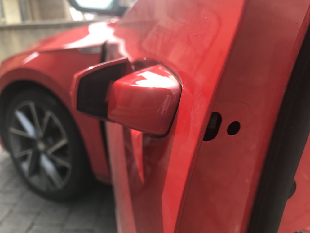

HI My Roscommon Friend and newly found BRISKODA Colleagues,
I have a similar Sportline - 2017 190 DSG same red and my door handle is now striking the same pose as yours.
I took off the little black cover on the side of the door to try and adjust the screw to try and remove the handle but hey presto, no screws in place which is very different to drivers side.
Likewise garages are shut here too. Any pics or video clips from anyone here how I might at least temporarily get the door handle back in position? don't want to force anything to break. Thanks.

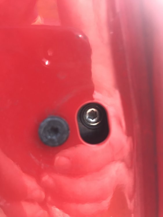

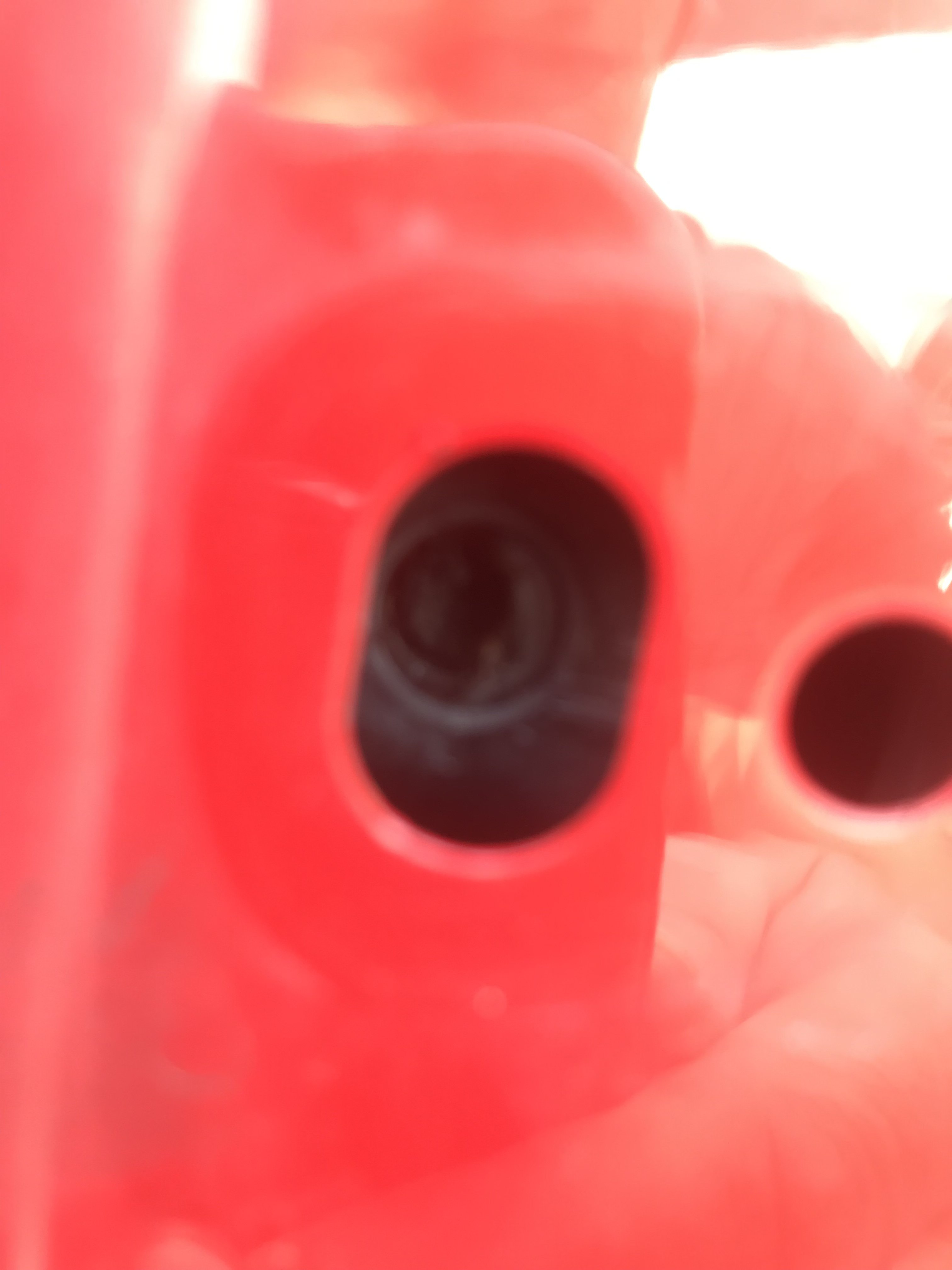

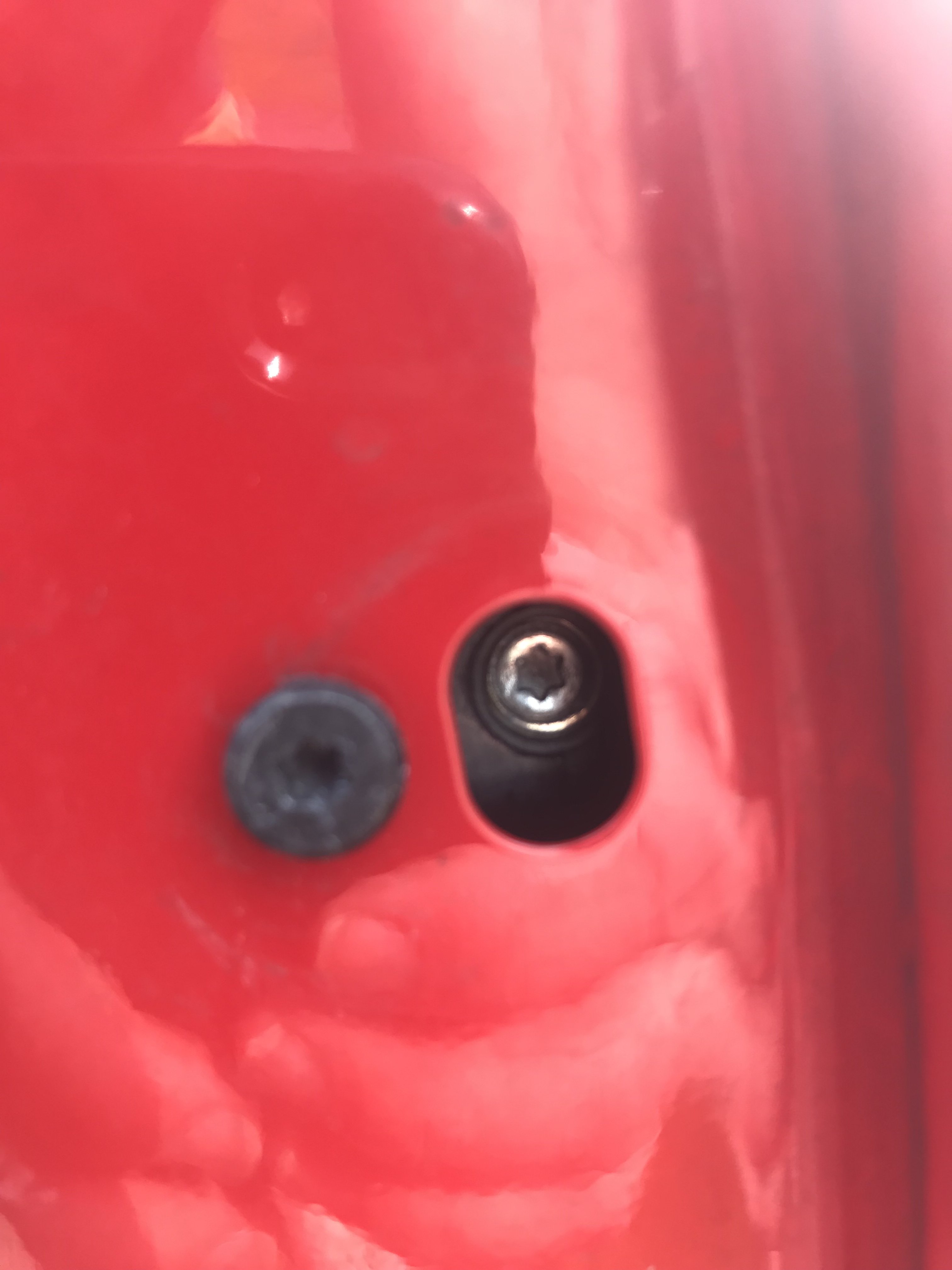

i had another look at the car but I seem to have the challenge that I don’t even have the screws that should be in place. The photos included here show the passenger door,close up of passenger door where adjustment screws should be and the drivers door which seems to have the screws in place.

13 hours ago, johntdoyle said:

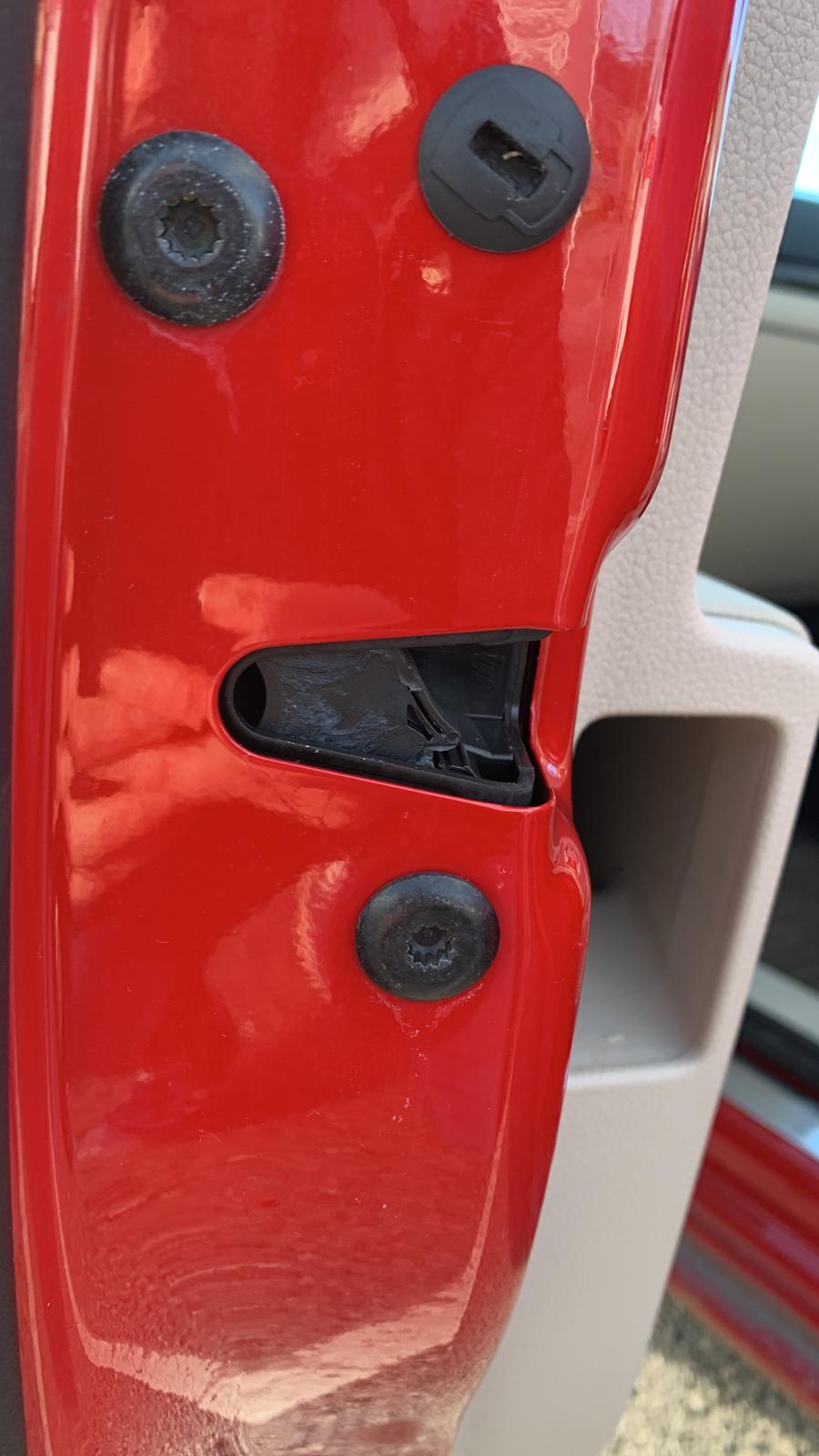

I just put back mine for the umpteenth time now and I took a few pictures which  might help you.

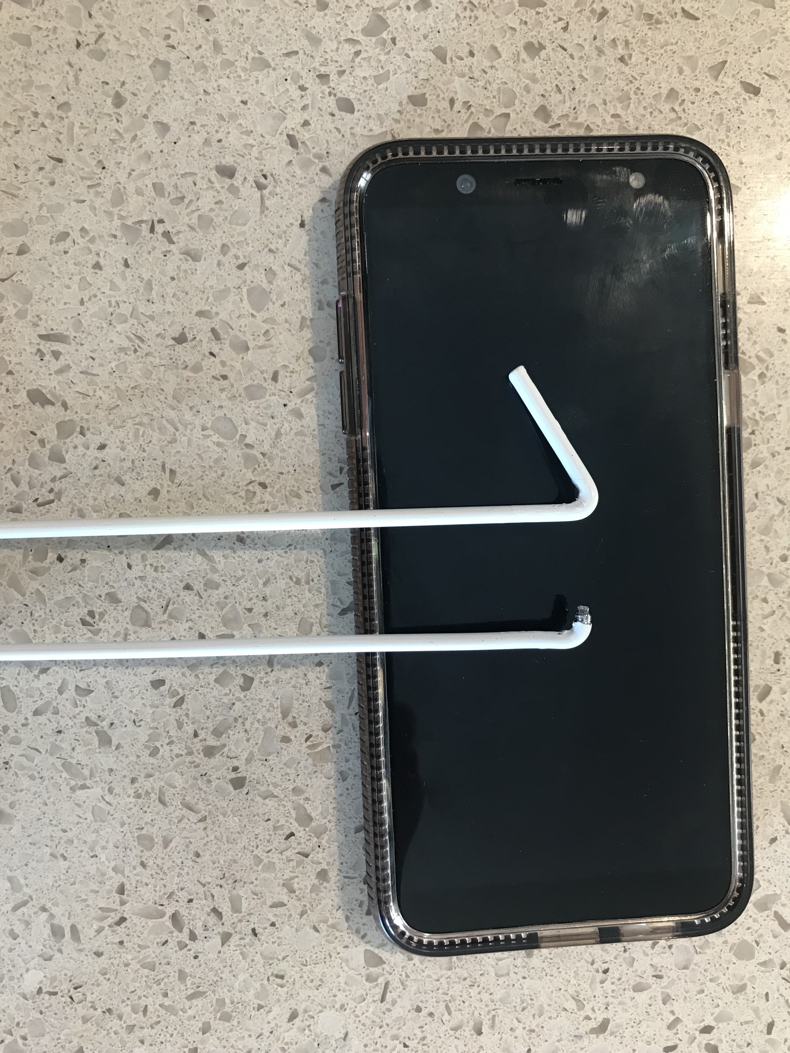

Firstly open door and remove the oval grommet .
Behind this you will see a half moon shaped clip,
This needs to be pulled forward about 5mm by means of the suitable hook tool, I found I  could use the fork of a circlip pliers to do this.
With this clip released this allows the handle end  cover to be removed, might take a bit of wriggling if doing it for the first time .
With this out the handle can how be released further and relocated correctly.
Now the end cover can be reinserted , you need to pull the handle out slightly to get the Clearance to get it back in.
Now push back in the clip on the inside of the door with a screwdriver or similar and refit the grommet. That it!

21 hours ago, SportlineBri said:
Sportlinebri thanks a million.  Look like my car is not so mutant after all missing screws and as for the inclusion of the hook tool pic that was the clincher. Hadn’t got one  and tried a few different bits but then found a kids toy ground peg, straightened the angle a little more and took the end off it with a pliers. Hey presto it worked a treat. Got the door handle back together handy enough after that and tested about 40 times.

that was a priceless bit of help. Thanks Sportline Bri and John . I sawed the end off a small Allen key to pull out the half moon thingy. I shall be keeping that in the glovebox too!

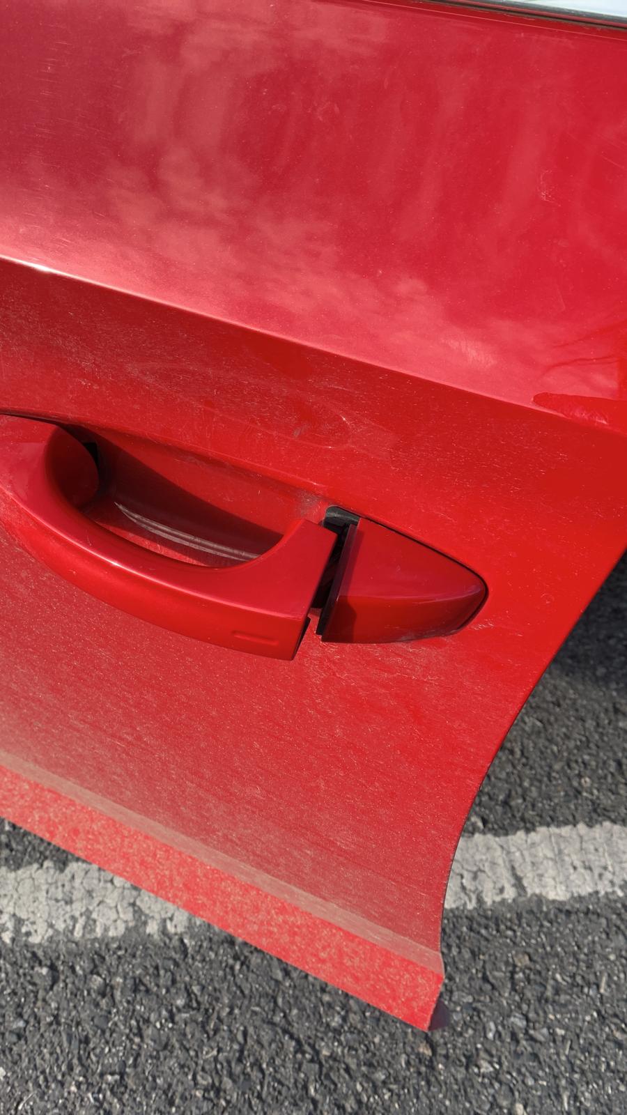

Hi guys had the very same problem today so first port off call was here.
Great details by the way followed the above steps and managed to get the small part off the door handle out and then the main handle back in.
problem now is the door handle is all back together and looks ok but when I go to open the door the handle it go’s about half an inch and won’t open.
Any help greatly appreciate.
thanks.

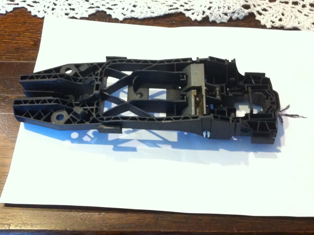

Thank you for the photos and instructions @johntdoyle. I had the same happen to my 2016 Superb, 1.6 DSG passenger handle, 3 days after collecting it.  These instructions were worth the £10 freedom membership alone.
Is the ground peg Magic Door Fixer™ for slotting into the small gap between the handle opening so you don't need to remove the housing completely by pulling the locking pin?  The locking pin is plastic, and looks like this fix will be done a bit, so the plastic might wear.
Job was a good un as I said on the 14th of May but job was not a good un last week.  Took it to my (very) local Good Garage Guide garage after much scratching of beards (mine) and heads (Johns) we agreed that there is only one item in the system that's the carrier plate for the handle so change it says I.  Unfortunately I had to pay for diagnosis (at very reduced rate) but hopefully this info will save other owners an arm and a leg and a hell of a lot of frustration.
Skoda Part number 5NO 839 855 H.  In the picture below the little arrow points to the pin that we all keep pulling and pushing.  Obviously the door card has to be removed to gain access but apart from that a reasonably easy job.  However it did come as a bit of a surprise to find no trace of an adjuster of any sort despite the comments above.
I have tried it about 50 times now and all seems to be working as expected, so my thanks to Sandy Garage of St Blazey you've earned your place in the Good Garage Guide.
