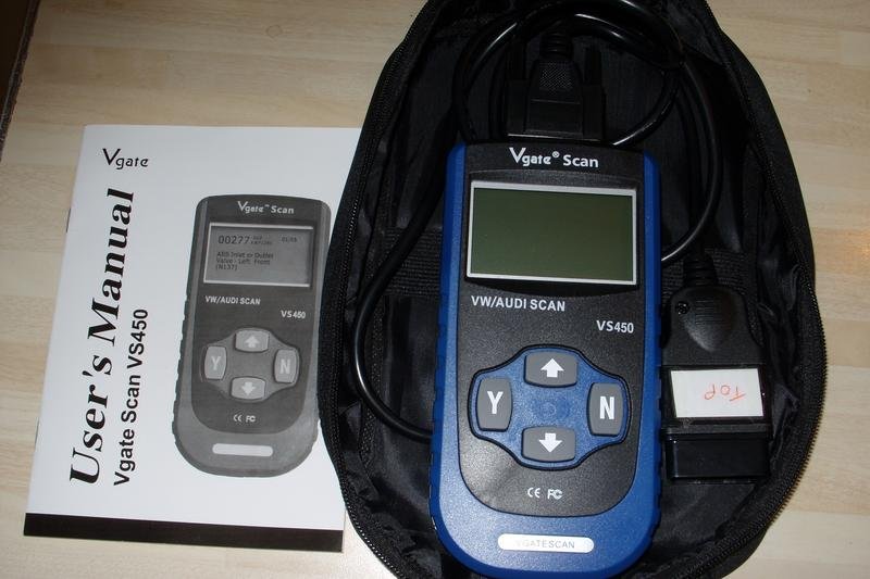

I just have this stand-alone one which works fine...
