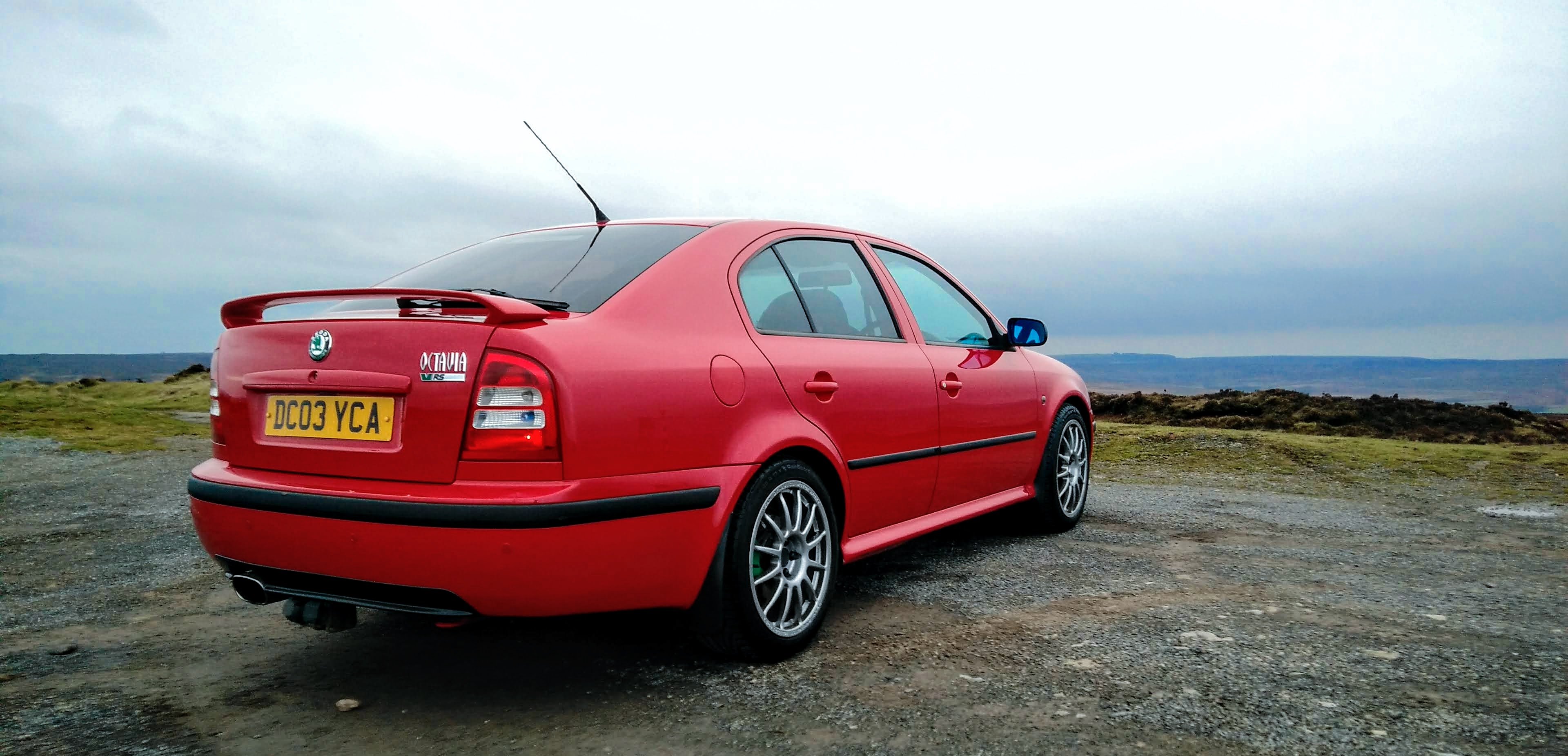

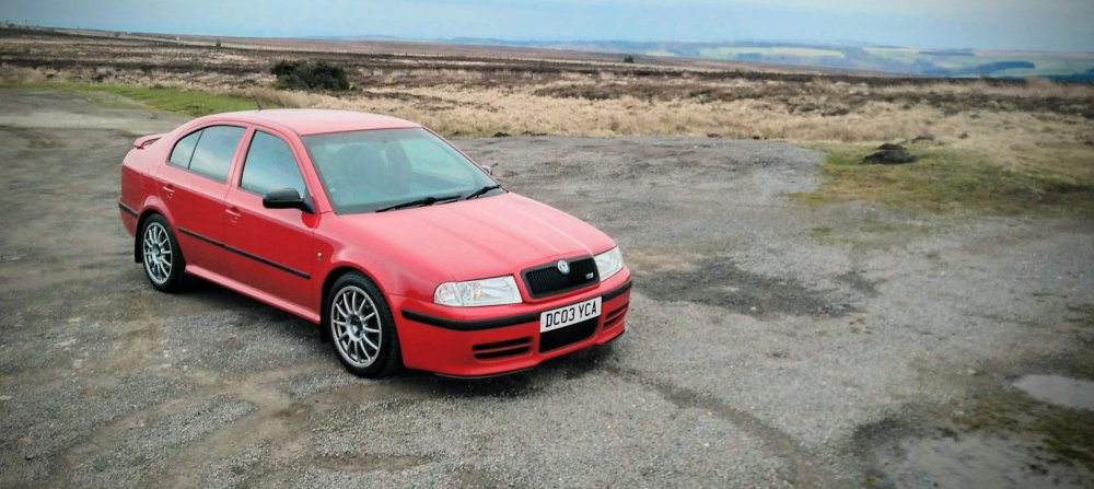

OK if you see a set of alloys that will fit with the clearance for £150 or under buzz me a message! Not bothered about condition as long as not buckled. I will get them powder coated anyway. Wish I had the cash to splurge on a new set but money talks and have not long had my original car (Corolla T - Sport) taken off road as someone took the side out in the night and didn't leave any details! Shame as I put close to 3k into modifying her.
Is that your car in the pics? Looks neat!!
Well, "sort of"; vRS estate (and hatch on some markets) had 6.5x16 5x100 ET42 fitted with 205/55R16W as standard. No mk1 had standard 18" wheels though.
It is my car, yes.  It's a work in progress and has a few bits that need tidying up cosmetically.  It's my daily driver so gets all the abuse a family car has thrown at it but on the whole, it scrubs up nicely.

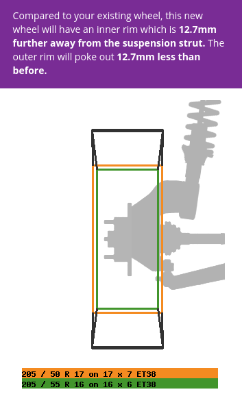

They will fit your car as the ET is the same as the original 17" Spiders.  They'll be quite narrow though and although the tyre width is the same as the original Spiders, the rim will poke out less and won't fill the arches as well.  I you aren't wanting to achieve a wider stance, then they should be okay.
Below is a screen shot from Will They Fit based on the measurements you mentioned.
Hope this is of some use.
Oh right, according to a site I was looking at online, the 16" MK1 VRS wheel is ET42 not ET38. This is where I get confused.
