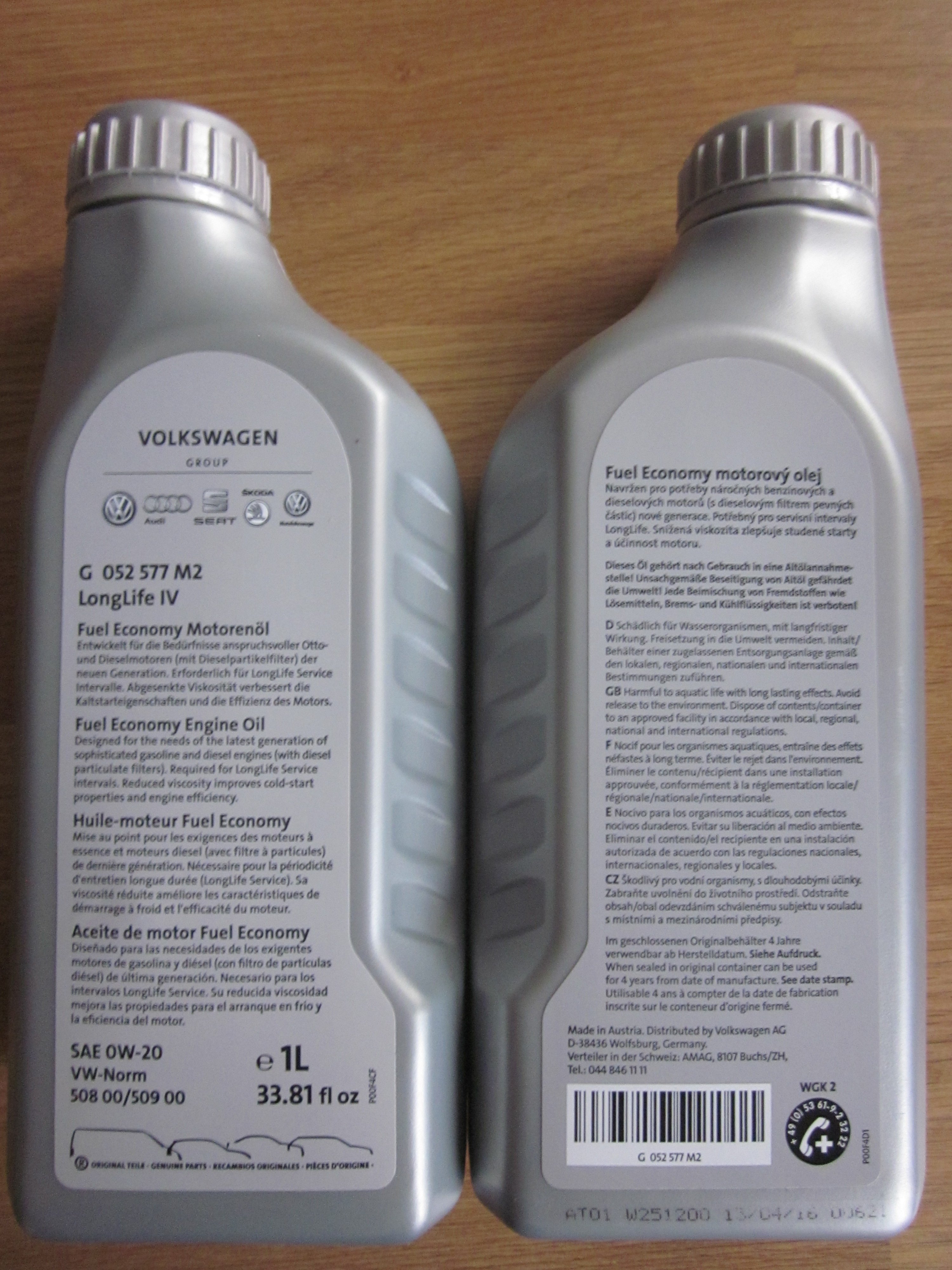

 Your car came with 0w 20 FS IV from the factory. That is VW 508.

Does that bottle of oil show to VW508 /509 ?
The spec of oil should be 0w 20 FS IV.
0w 30 will be fine if to spec VW504 which likely it is.  But that is not what should have been supplied.

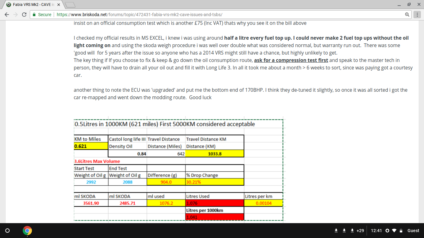

Skoda employees and Dealership Employees sometimes say that 1,000 km & 0.5 is within tolerances.    Well what Owners manual say is posted up above.
*** Below the 0.5 litre is about in the first 5,000 km.   That is how it was always to be, it is lost in translation'. ***
It is not within tolerances, it is what might be used by some in some circumstances.  That is not in a British Winter driving normally, not over a Alpine Pass Towing something.
So if you want to know what the Tolerances are, ask to be Shown in Writing, not in a Owners Manual covering all engines, 3,4,5,6,8 cylinder, petrol or diesel from 44 kw up to as much power as VW Engines might go.
