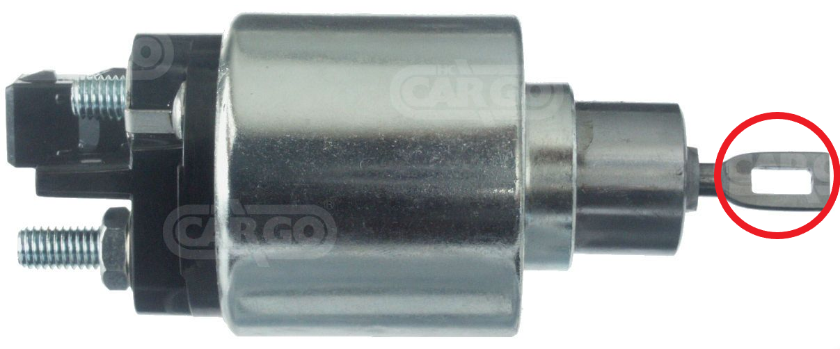

They usually have an end on like this that just hooks out...
