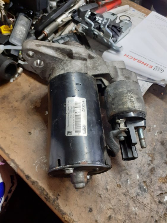

Apologies if this has been answered in a separate thread. I have a 2002 Skoda Fabia SDI estate that's done about 153k miles. Recently it wouldn't start and I have had to roll start it on numerous occasions.

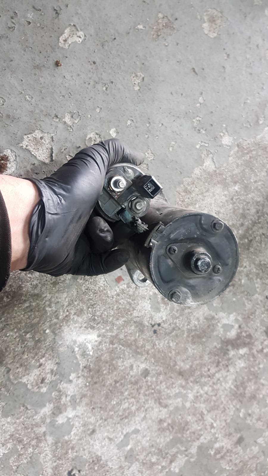

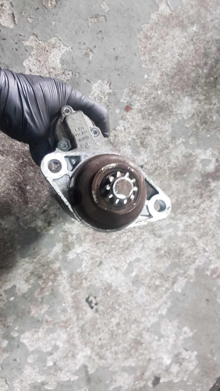

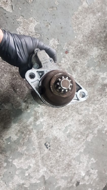

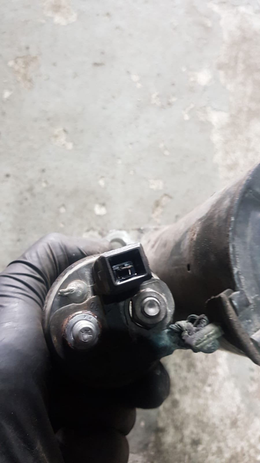

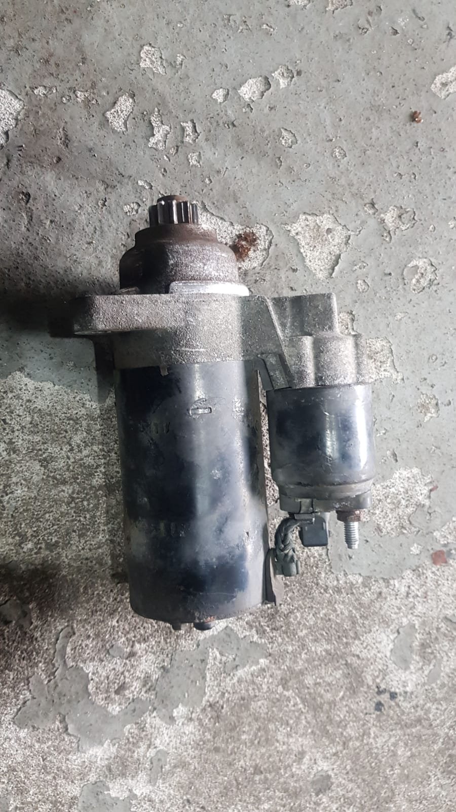

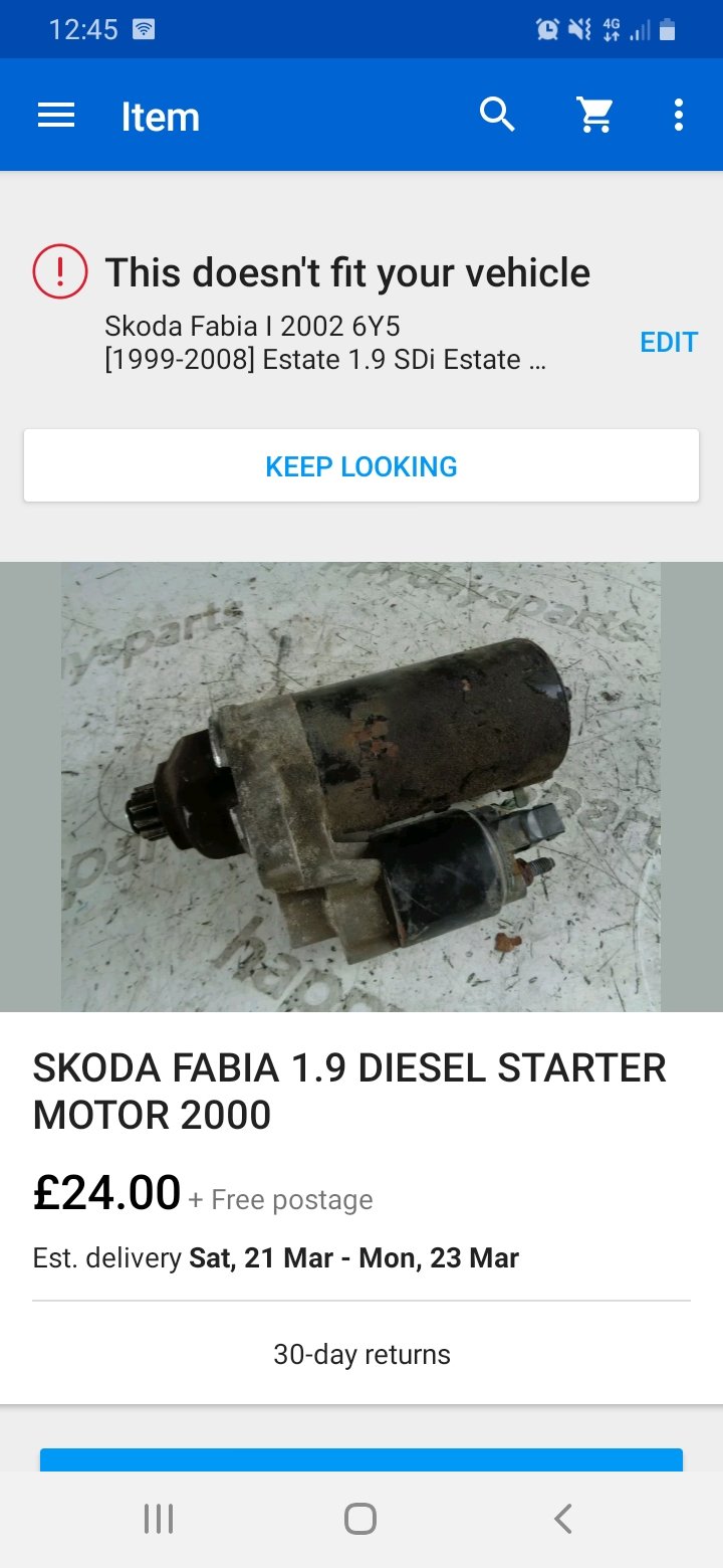

I have had a starter motor replacement diagnosis. I got one from my local scrappy but it was the wrong one. Please can anyone identify from the code number or point me in the right direction if this is the correct one? An album of photos coming up. Thanks everyone. The image at the bottom is the wrong one I returned to the scrappy it's a TDI one. Cheers.

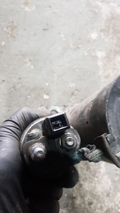

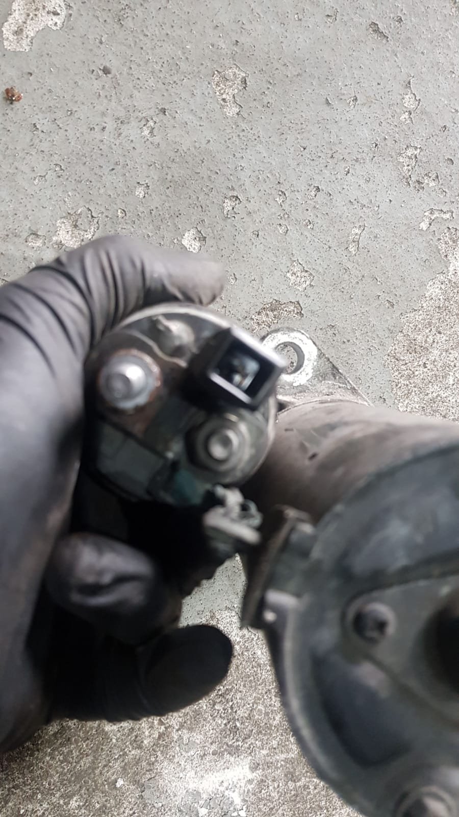

    Just be totally sure the starter is at fault. They rarely go wrong. The fault is normally a break in the single wire that goes down to the starter solenoid.
  • Breezy_Pete
    Breezy_Pete
    Have you checked the wire? A brand new starter motor won't help at all if the solenoid isn't getting energised because the wire is breaking/broken.  It's an extremely common fault, especially on

This is the Skoda part number for your starter...
I've just checked ECP prices and motors. I don't know how much you paid the scrappie, but for circa £60 you could have a new motor ( Or if you get one from Scrappie, then I've noted from ECP data , that the part numbers on there for 1.4TDI is same as for 02 SDI) . But is it the starter motor, as there's a well documented fault on herE about the solenoid coil wire breaking. Or it could be the problem I suspect I have ( but it'll wait for warmer days ) of the solenoid sticking and all you hear is a click as solenoid tries to engage. I use the old fashioned tap on solenoid with hammer.

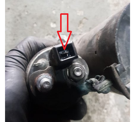

The wire to check connects here:

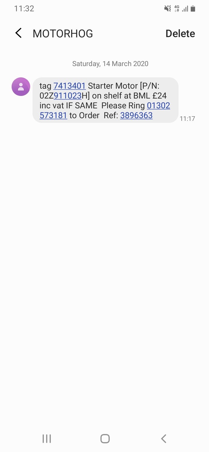

Hi everyone thanks for your replies. I've rang the dealership and they've said the above part number is wrong for my 02 Skoda. They have said its 02T911023H. Any ideas apart from a brand new one at £80? I'm starting to think I won't find a second hand one. Thanks..
A brand new starter motor won't help at all if the solenoid isn't getting energised because the wire is breaking/broken.  It's an extremely common fault, especially on the diesel engines due to higher vibration levels.

I have had the wire checked and my mechanic said its OK
Check it yourself; might save you a lot of trouble and expense, mechanics don't always offer the cheapest solutions unless they are also friends.
Not sure what access is like on a 1.9 SDI, but I expect there's an angle where you, or a camera phone, can get a view of it with minimal disassembly. Most likely problem area is right next to where the wire goes into the connector.
If you're not sure where to look,  get a picture of the engine bay from above, towards the front on the right hand side of the engine (as viewed from in front of the car looking into the engine bay), we may be able to help you find it. From google images, it looks like there's an intake air hose just above the region you should be looking down, in between engine cover and battery box.  May be very easy to disconnect this to move it aside temporarily?

A starter with the part number 02T911023H is the same item whatever vehicle it has come from.

Hi. I am getting this message but the part number matches up. The last two digits cannot be seen because of rust, I am assured that it is the same part as I have sent pictures. Any advice? Should I check the wire first again?
