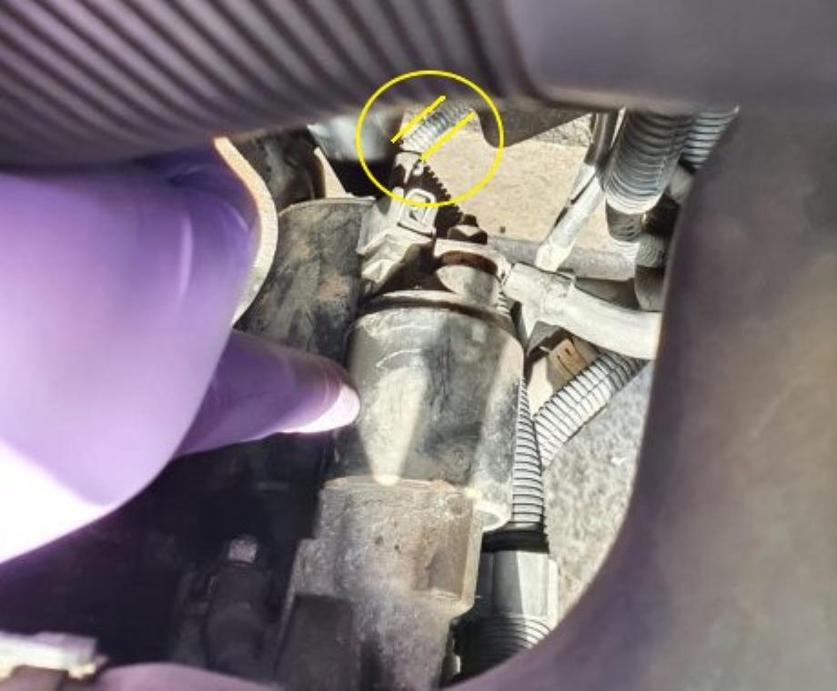

It's this wire I think, try giving it some gentle movement if you can get a hand to it, to check if it just breaks off:

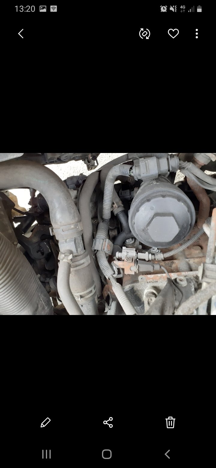

Hi. I am getting this message but the part number matches up. The last two digits cannot be seen because of rust, I am assured by whom? that it is the same part as I have sent pictures. Any advice?
Should I check the wire first again? this has been recommended a few times.

I think you'll find there's a black PVC sleeve over the wire, try pulling that back a bit away from the connector to get a better view/feel of the actual wire where it goes into the cable-entry of that connector with the wire release 'ears'.
Take a close up photo of that point with flash on if you can get the phone in there. :)

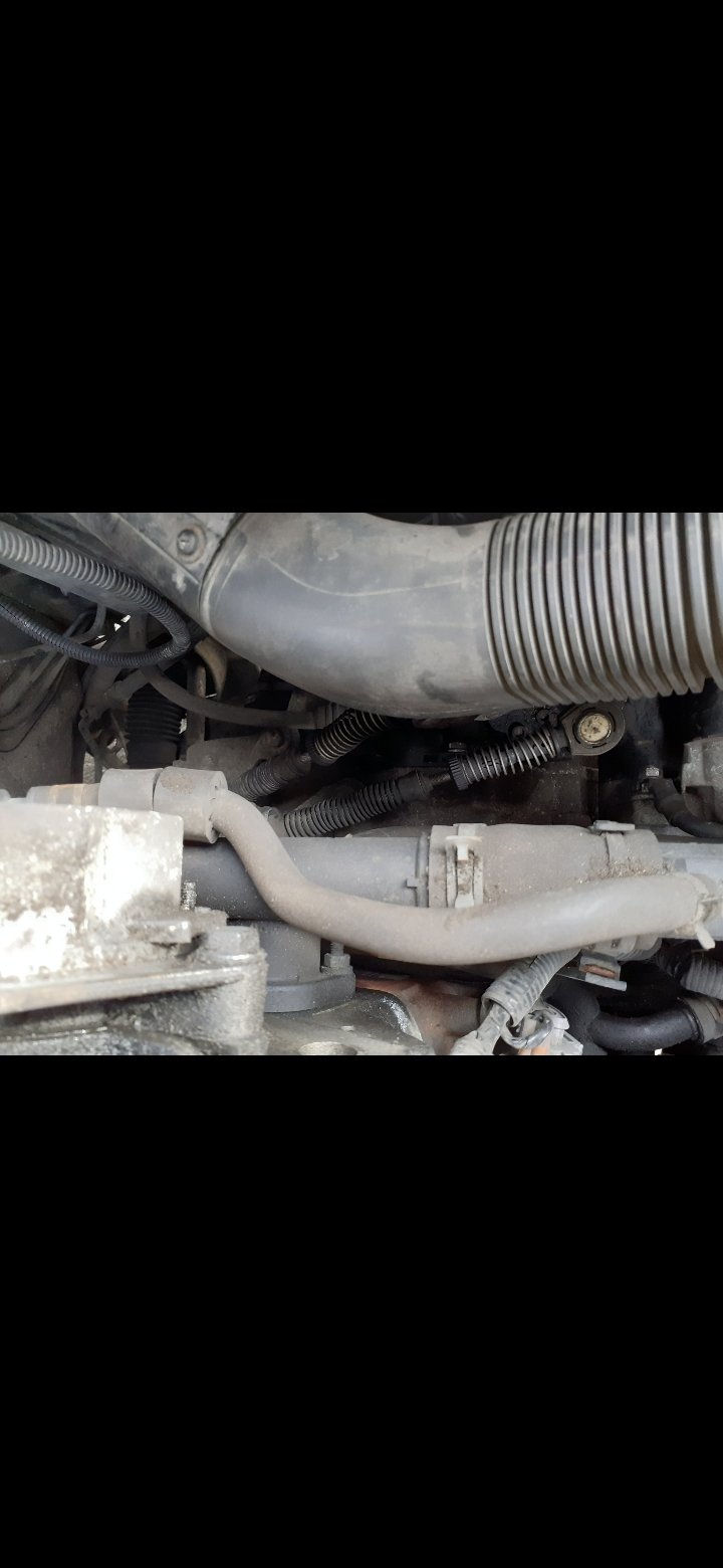

Is that picture face on or upside down? I have tugged at a few wires in this picture I am posting now and nothing is falling off it feels pretty secure.
  • Sponsor
The one I put the arrow on is your picture, but it looks like you had the phone turned so that it  looks like you're sitting on top of the engine looking forwards towards the front of the car and downwards.  So the radiator fan is at the top of the picture, battery box on the left out of shot.
In this latest picture of yours above, I don't see the same items, maybe it's been taken further across away from the battery?

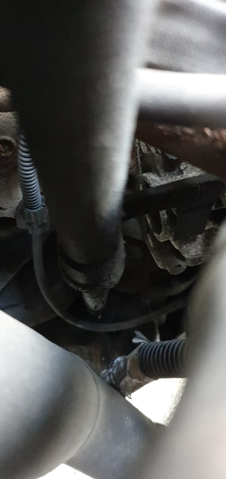

Right thanks yeh that latest picture I took is under the engine a bit further to the left. I'll take another look tomorrow. Appreciate your help

Hi. Yes I have managed to watch the video very helpful. There are more wires and pipes near my engine so getting my beefy hands in there is difficult.

Hi. Yes I am not doing any work myself. Am I putting my finger on the correct wire? It is slightly loose.
In the yellow circle mate...
Edited by TMB

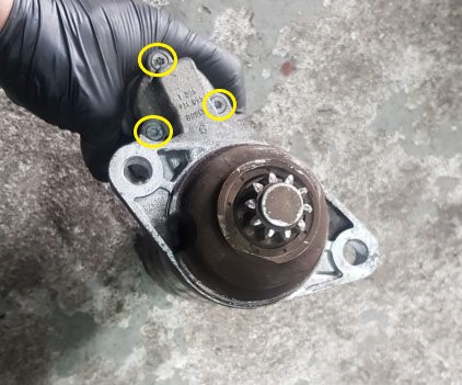

Just replace the solenoid, the motor is generally fine unless it's burnt out from being stuck on while the engines running.
Thanks sepulchrave. Would this be bought new? If so from where? Plus how would I take this out? I have a Haynes manual I hope its in there.
Thanks
Solenoid is held on with these three screws...

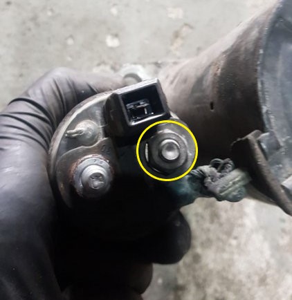

And remove this nut to free wire ring terminal...
Edited by TMB
It really is that simple, do you still need a Haynes manual?
