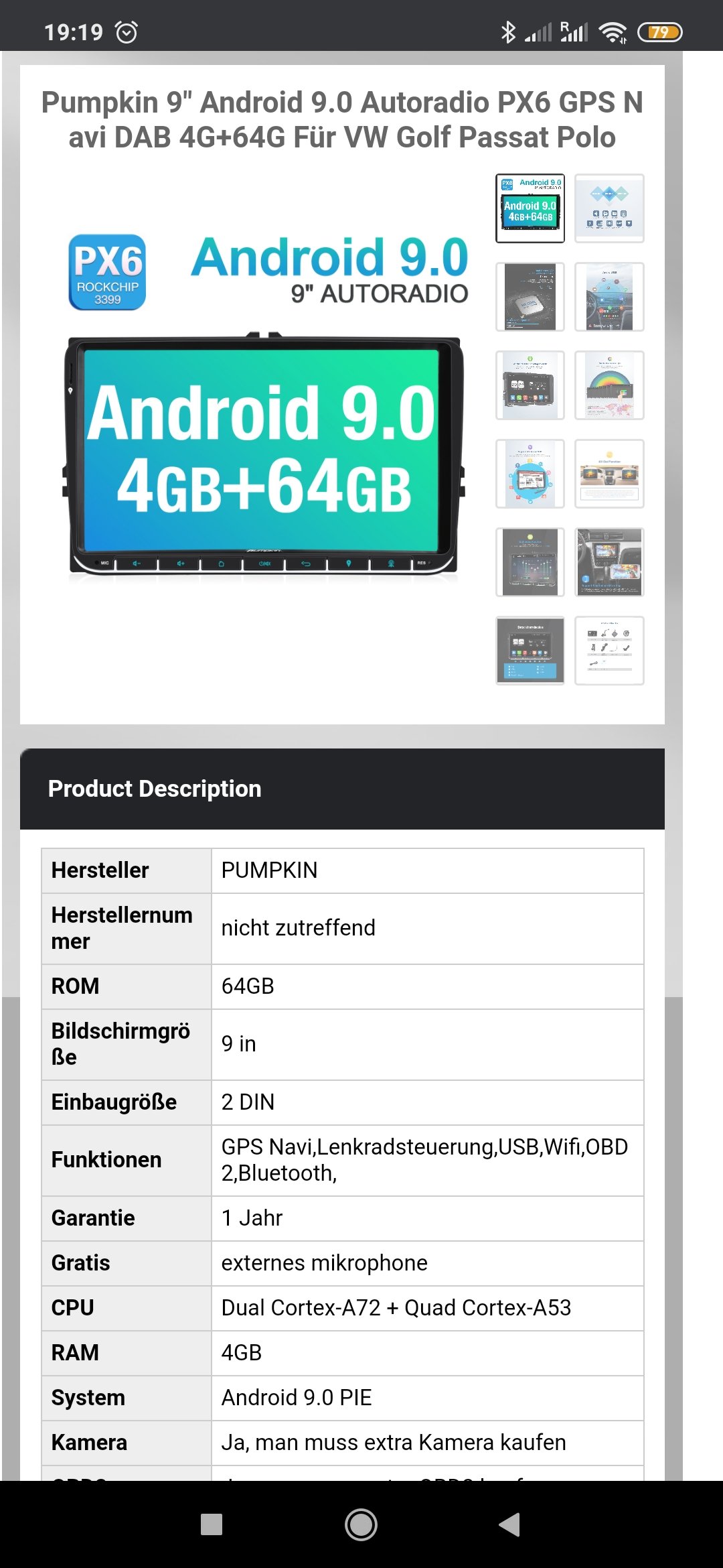

Mine is pre FL, 2007 and all the models say px6 with 4gb of ram and 64gb ROM all say 2007 onwards, how do I get around the battery drain issue many say on the 2007 model as they changed them late 2007 or if someone can point me to one that won't drain the battery
