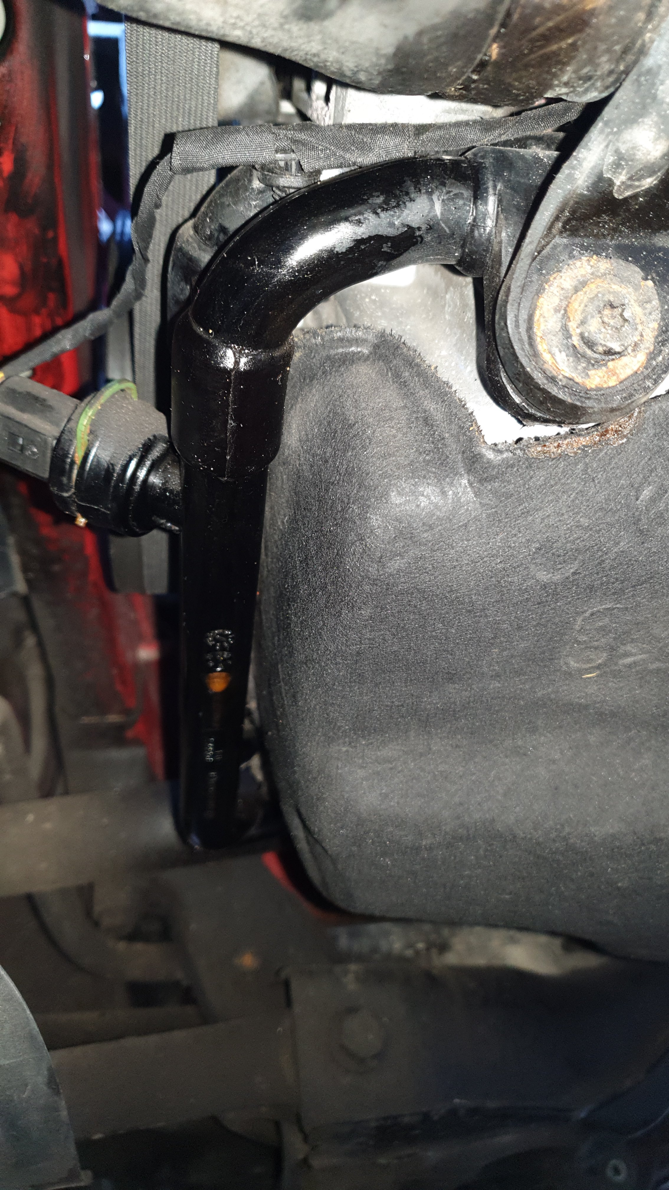

Thanks for that Troy, just took the under tray off and its dripping in two places,one near the sump plug drain, and its looks like the main one along a pipe under the water pump (see pic ) there is a sensor on the pipe but it looks OK, how do you remove the black sump cover underneath ? Cheers Stuart

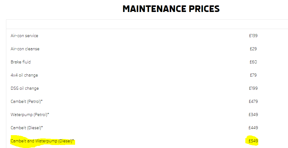

Looks like its time to do the cambelt and waterpump, think I will go for the INA kit, hopefully no tricky bits to catch me out. cheers Stuart
VAG water pumps are well documented to be a fairly common weak point.
Cambelt and new water pump time...

Just done belts and water pumps on my Rapid and wifes Fabia , both 1.6 tdi , 2013. both showing signs of slight leakage from water pumps . There is what looks like a drain hole on the bottom of the pump and discolouration was visible on both . One has 50k and other 70k , both belts came off looking in perfect condition , both had suffered a slight loss of coolant prior to the change
