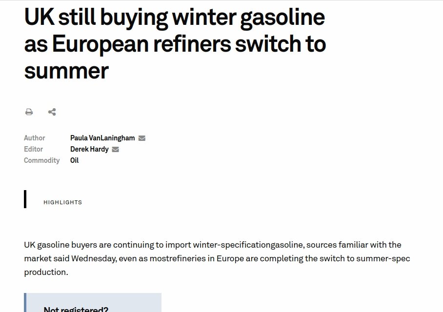

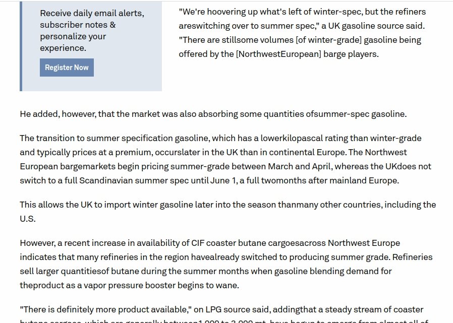

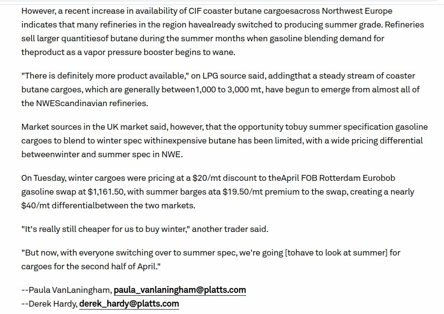

Also my understanding is that this winter/summer petrol thing doesn't happen in the UK as we don't get cold enough. Diesel is definitely different.
The word is 'hygroscopic'.
Your understanding is wrong on winter fuel in the UK.
Mid October in Scotland to the end March or Later from the depots.
Slightly later sometimes down south in starting and the Winter Grade can arrive in the UK later than in Europe some years.
