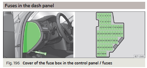

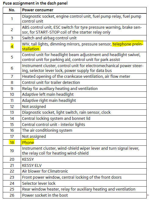

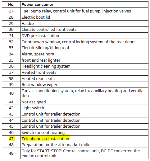

The fuses you need to check are numbers 4, 18 and 47...

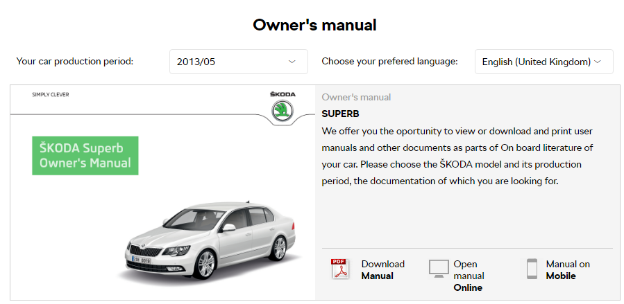

If the hard copy manual is missing from your car, you can download them electronically in PDF format here...
https://www.skoda-auto.com/services/owners-manuals
