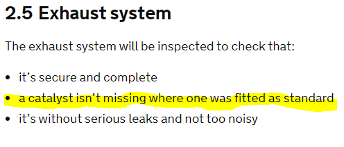

You need a new DPF. A DPF clean won't work as there is nothing to clean.
When the DPF is 'deleted' it is either removed completely and replaced with a straight-through pipe, or the DPF casing is cut open, the insides removed and then welded back up. The sensors that control the DPF are then coded out so that you don't get the warning lights on the dash.
Either way the MOT tester is able to tell visually that the DPF has been tampered with. To clean the DPF you do not need to cut it open, so the fact the MOT tester has been able to identify the weld they are well within their rights to refuse to issue an MOT certificate.

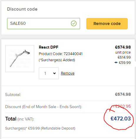

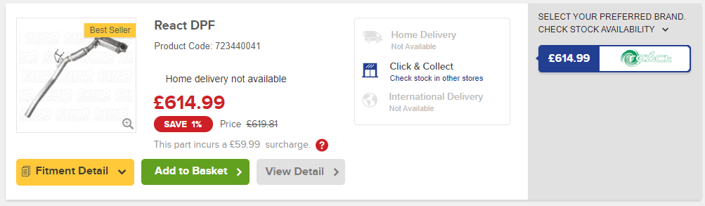

Halfords is never going to be the best place for a new DPF quote, you need to find a DPF specialist, or a trusted local garage with low labour rates and access to non-genuine DPF's. I'm afraid even this will cost you between £500 and £700. It'll also need someone with access to VCDS or VAG-related diagnostics software to reactivate / code the DPF sensors...

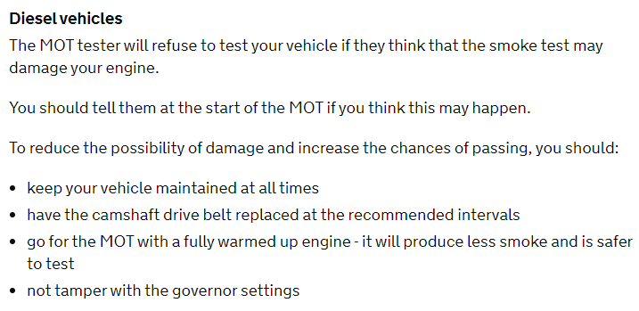

Correct, the MOT tester has spotted that the DPF has been opened / tampered with. This alone is enough to fail the car.
The MOT tester knows that evidence to show the DPF has been cleaned doesn't exist, the evidence it has been opened and gutted and not cleaned is there for him to see.
If the tester still wanted to carry on with the test, diesel engined cars are put through a smoke / soot test, a probe is inserted into the exhaust pipe, the engine reved and the levels of soot are measured. For fear of damaging the engine the tester will not be willing to rev the engine knowing the engine oil level is low.
If the DPF has been removed, gutted or is inoperative this should be evident from the recorded levels from the soot test. A fully present and functioning DPF will record a zero reading in the test.
