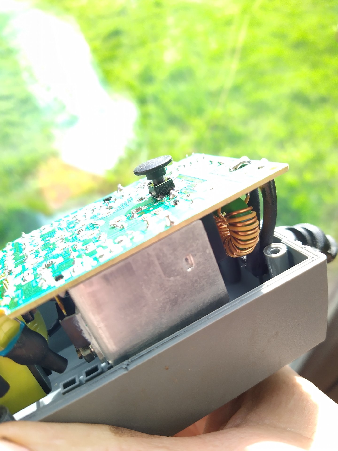

That was exactly my problem from day 1, would work after a while & got worse & worse when not used for any length of time.
A very easy & cheap repair, ideal Coronavirus project!
Got the Aldi charger apart after struggling to get the triangle head screws out and can see the pcb mounted switch, wow its small, delicate soldering exercise. JR where and what type of pcb switches  did you order can I ask. cheers
On my Ctek, which looks the same, I put a few drops of isopropyl alcohol into the switch and spun/pressed it repeatedly. Easier if you gently pull off the "top hat". Solved the problem for another year. There are numerous threads on the interweb showing how to fix or replace the switch.
You're a good un Green machine!  Switch cleaner fixed it. Cycles through on the button now. Have put it on a leisure battery to see if it works. Will report back tomorrow. Many thanks.
Yes I also did that for over a decade before it finally let go.
I bought the switches on e-bay, searched for PCB mount tactile switch or similar.
Success. Green light on this morning battery fully charged.
