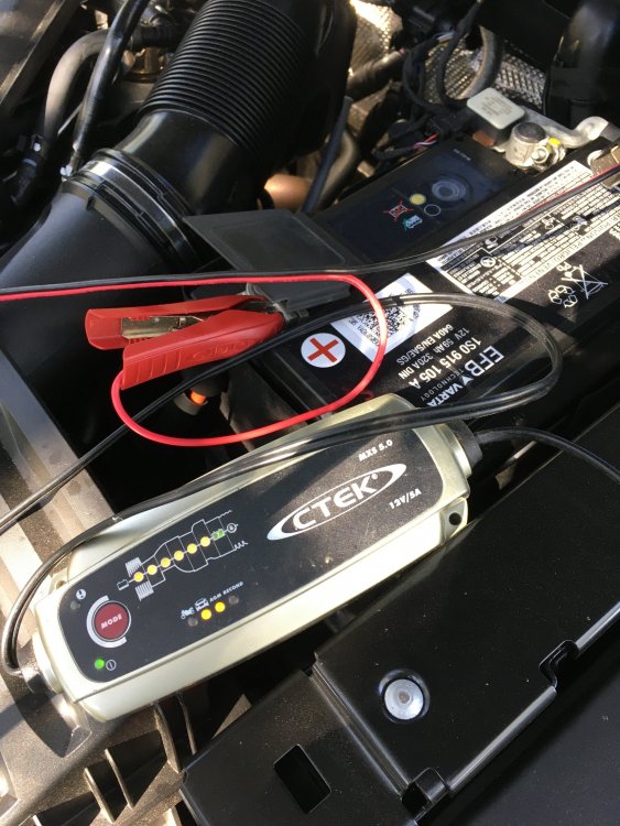

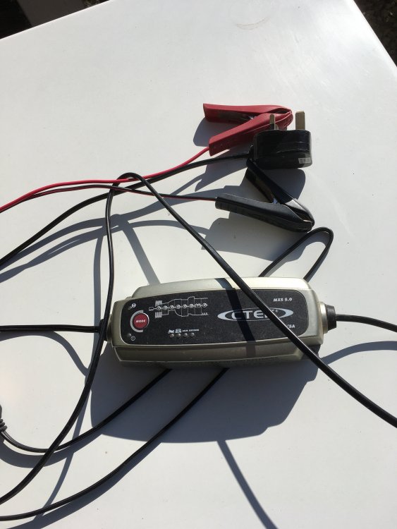

Like many motorists my car is not going to get much use over the near future.
I have been given a CTEK charger and before using it I would welcome some advice.
1 Is it suitable for my car?
2 If it is what is the correct procedure of connecting it up?
Many thanks in anticipation

does your car have an agm or Efb battery?
also does the cteck have an agm or cold mode on it?
if it has an agm mode, then you should be fine.
Whatever you do, do not do a reconditioning cycle, that will likely kill an agm.

A note for connecting up to the battery terminals - with the charger unpowered, connect Red/positive charger lead to positive battery terminal, then connect Black/negative lead to the bare tab mounted on the firewall bulkhead - NOT the negative battery terminal. The same precaution applies to connecting up jump-start leads.
Thanks ...have done this as per instructions in user handbook .

Its the same CTEK charger I have.. there is a AGM mode.. front panel has an indicator. Just look on the picture you posted OP
