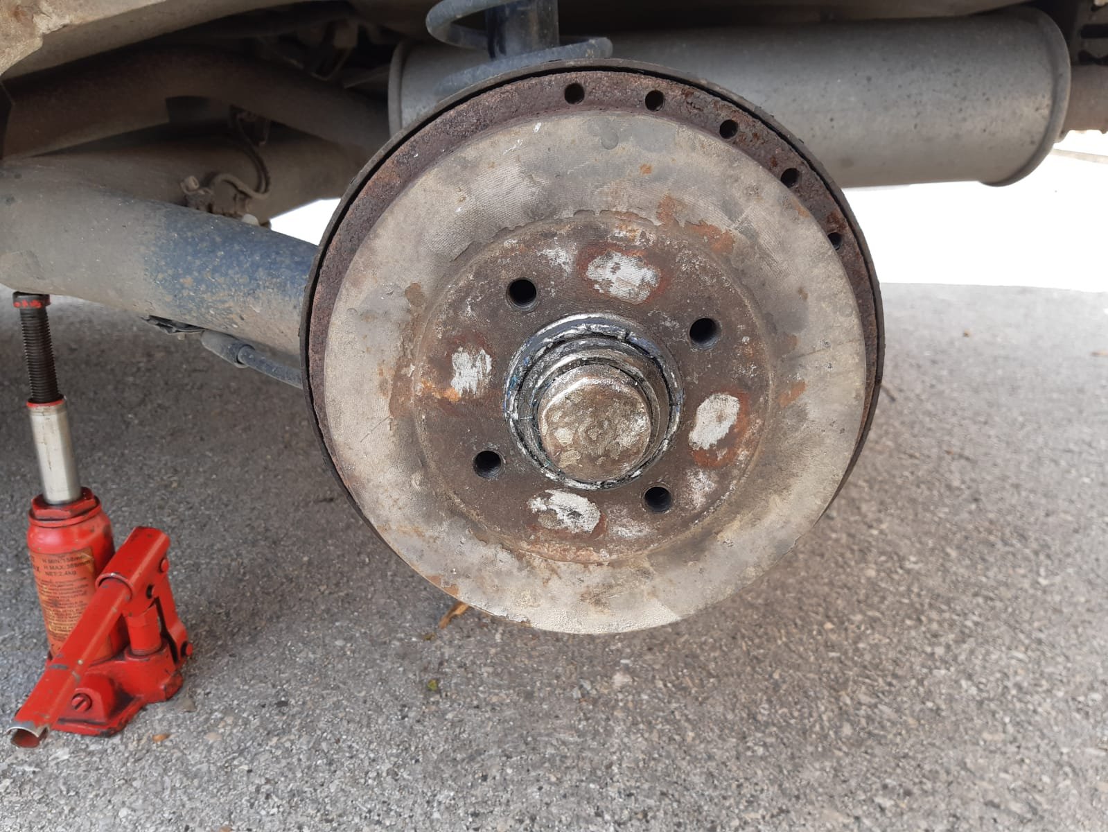

Hi guys,
So ı need to change my rear brake drums,  ı bought new one and dismounted the wheel. After ı saw the old drum ı pullar on it but unsucessfully. It doesn't nove at all. I checked uf there was a screw place to pull it out,  nope. Do you guys have any technique to pull it oy or is there something elde ı need to do to change the drum.
I checked couple of video on how to do it (ex:ChrisFix) but couldnt figure out what ı was missing.  Do ı need to do"hammer time" on the old drum to remove it?

Just unscrew the nut. Take all the washers out and the drum will come off. Clean it, lube it very well.
And you are golden.

I already tried by removing the nots, but as I see on the video you need to take the cap off in order to remove the drum. Also I will check if The new Drum I got have bearing in it or not.
The other videos I looked at (ChrisFix Channel, Link :
The drum wasn't hold by anything other than the bolt. But it does not seem to be the case for the Favorit. Will check and get back to you guys on a DIY how to do it.
Yes that is the case on cris fixes vehicle because it is a driven axle.
On the favorit you need to remove the dust cap first then the nut, all the thrust washers and tap it and it should come off

So after checking the new drums I got, I saw that they don't have bearing in t. So I will have to put a new bearing in place. Since I don't have a toold how do I get the cap off ? He uses some kind of special Plyer to pull it out, but how do you do it with common tools ?
Come on, it's not so difficult. Use a screwdriver and a pair of channellock pliers. See video below.
