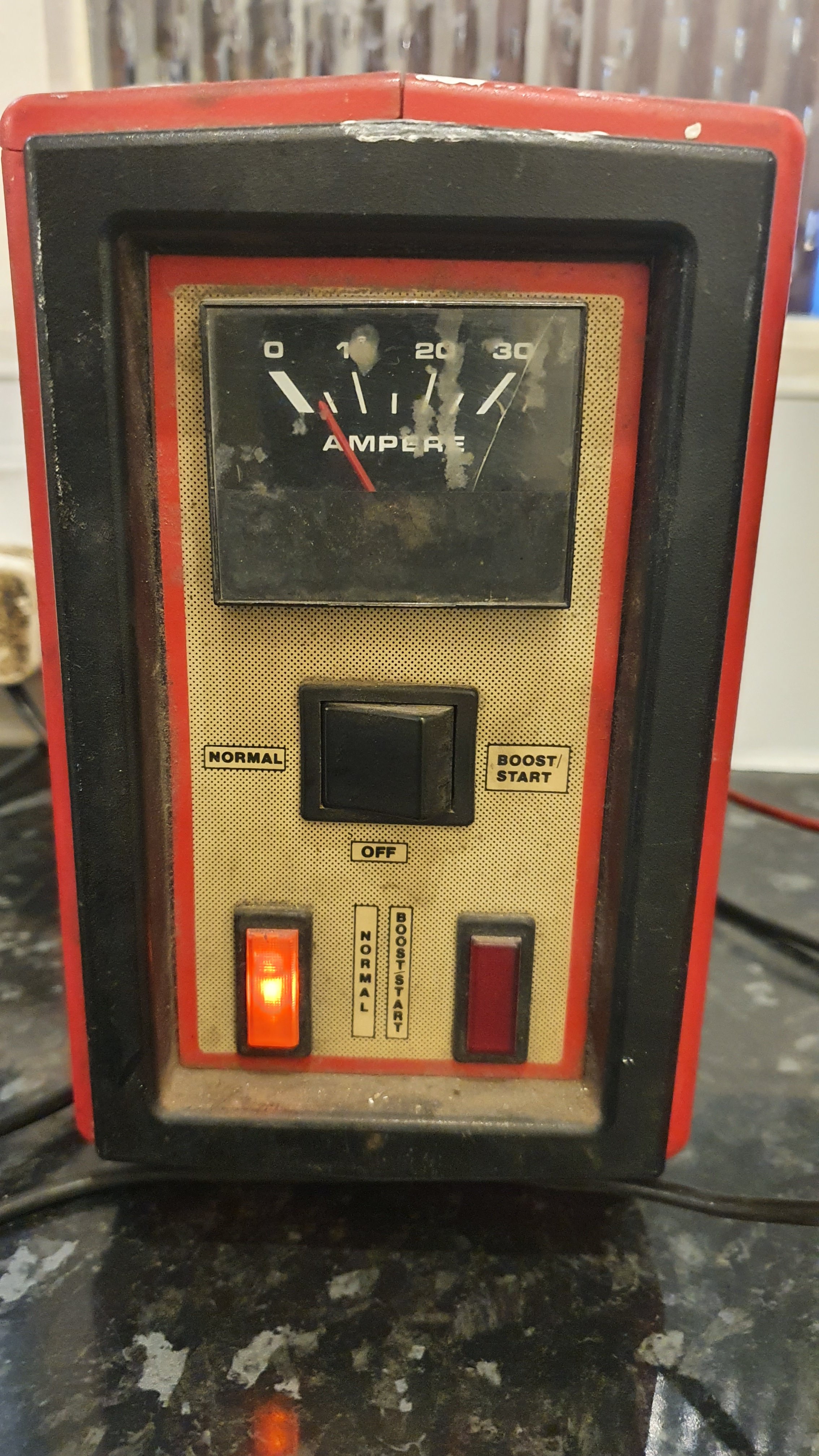

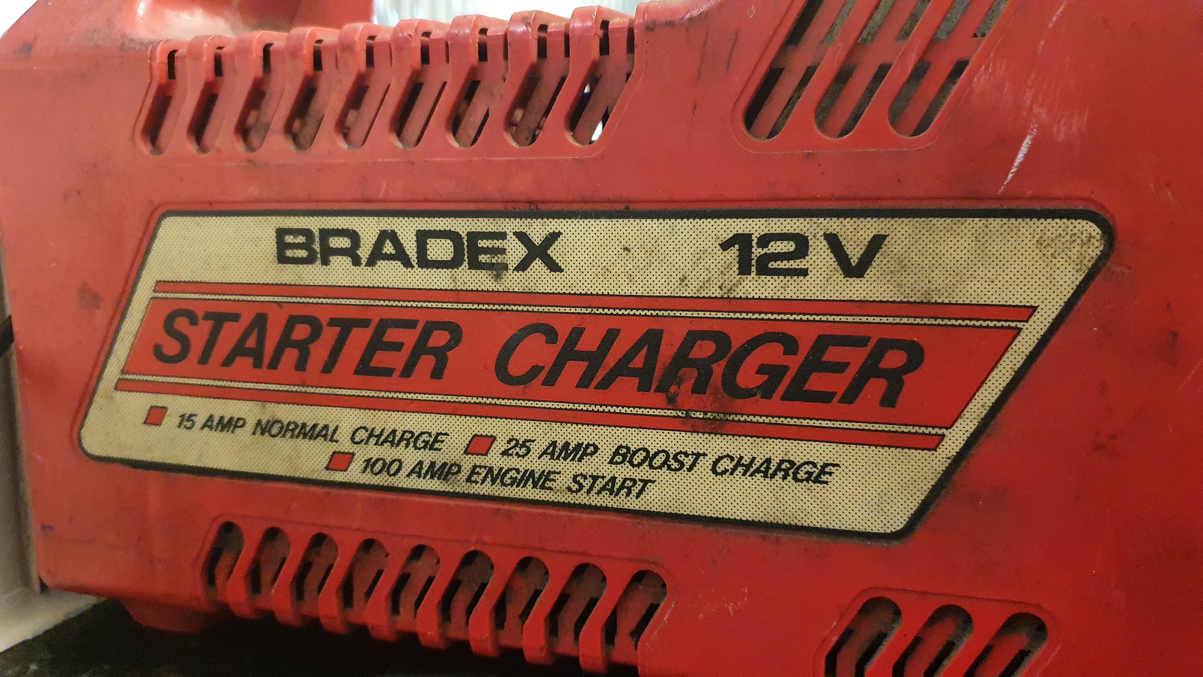

That's a bit 'agricultural' in appearance. Wouldn't leave that on overnight, just to be on the safe side. Probably won't need to anyway, looks like it'll charge fast.
It's my father in law's, he's been a mechanic for the last 40 or so years, he generally goes OTT on his tools.
I'm going to leave it on charge until I go to bed tonight, then the Mrs is going to keep an eye on it whilst I'm at work tomorrow, then I'll try it on the car on Friday.
Thanks for all the replies, much appreciated. 👍
@broona    I edited above, but it would not load..........It was re charging purposes. I think you will be ok with your charger but yes, as you say, keep an eye on it whilst charging. It seems like the efb batteries will accept faster charging than standard flooded batteries.
