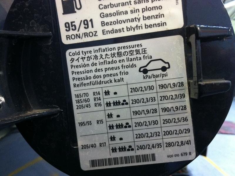

My vRS Fuel cap allows 95 Unleaded to be used as an alternative to 98 Ron.

Does it say you can continually run 95 Ron fuel in the cap? I’ll check my 06 BWA as I thought it said only to be used if 98 isn’t available or words to that effect? I’ve a few petrol turbo cars so it could be any one of them tbh 🤣🤣

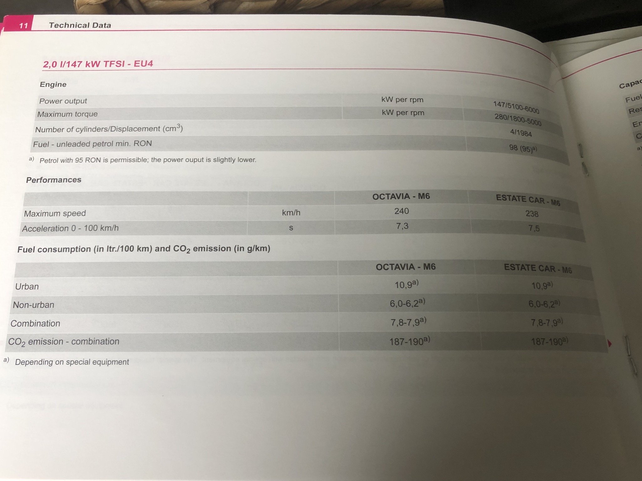

@Roottootemblowinootsoot
it pains me to post this photo, but here is the gumph in the owner manual. Stating output is reduced from the book figures on 95 Ron fuel.
it states it for a couple of engines lik the 1.8tsi for example.
