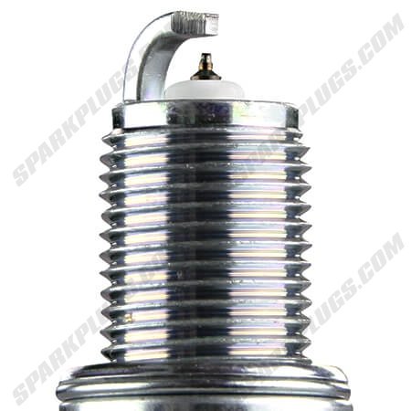

OK, but if you had less pointy central electrodes, the gap wouldn't open up as rapidly as the material would wear across a bigger cross-sectional area?  And the tip wouldn't be as fragile? Maybe?
The advantage of iridium plugs resides in the material itself, apparently it's so resistant that it allows the use of a fine electrode. Rather than an inherent design problem, I think the conditions inside the combustion chamber are so violent that the plugs couldn't have done any better, with the continued use of 95, 91 or lower octane fuels, they could only withstand that much.
For reference, a new plug looks like this.

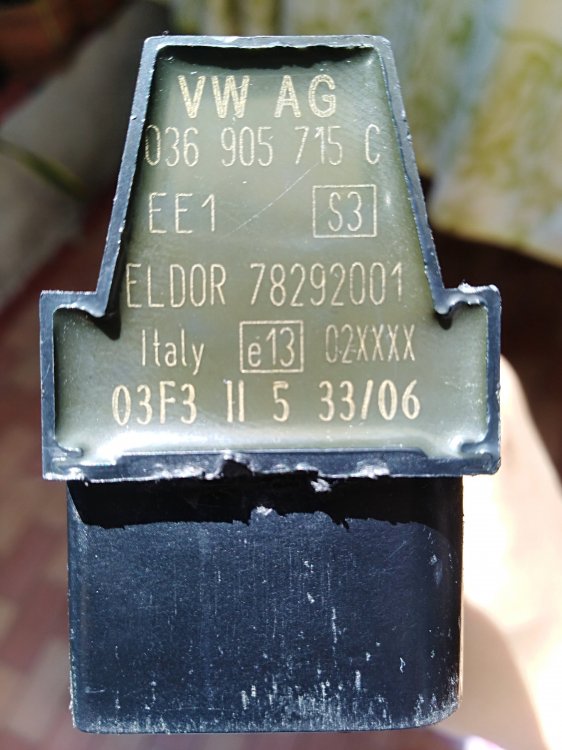

Also, this is the coil I replaced. Still the original unit apparently (33/06). There's another one like it so I'll change it as soon as I can, even though it hasn't failed yet.
  • Sponsor
I think big spark gaps cause the coilpacks to fail. I wouldn't change a working one, just carry a spare in the car and a means of reading fault codes (handheld scantool).
My 2003 Polo has all four factory units still, I believe.
Great, thanks for the advice. I'll be a bit more zealous about the sparkplugs from now on.
