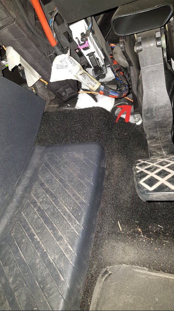

I have the cable in  the boottom of a pillar next to the pedals .Whats the best way to rout e the cable to the front of the car?
Only 4 cables so i missing 2.

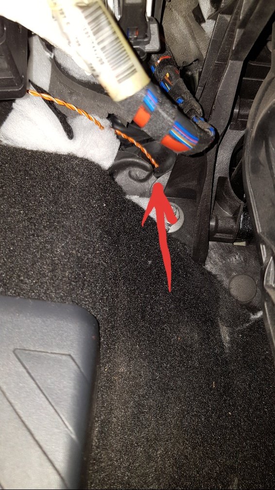

Can someone point me where the gromit on LHD Driver side is , please ?
I found the grommet its very small.20200414_104641.thumb.jpg.0df8db9e3270a2056780151bbc78e040.jpg20200414_104347.thumb.jpg.2fc4adc30fcc09d981aeb6ab9a3a78a7.jpg

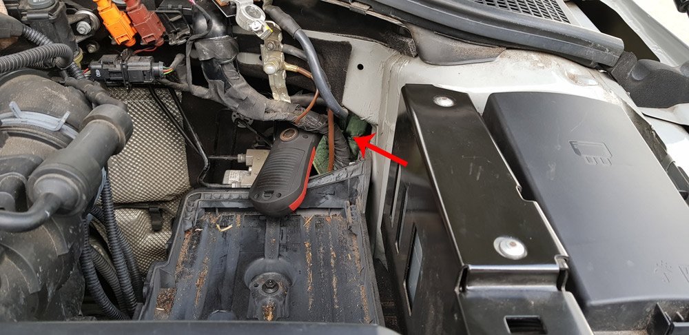

I was not able to take a picture from the engine bay, when i passed the cable (phone battery died), but it' the same as the octavia you have to remove the battery(no other way) , you can only see the tip of the grommet .

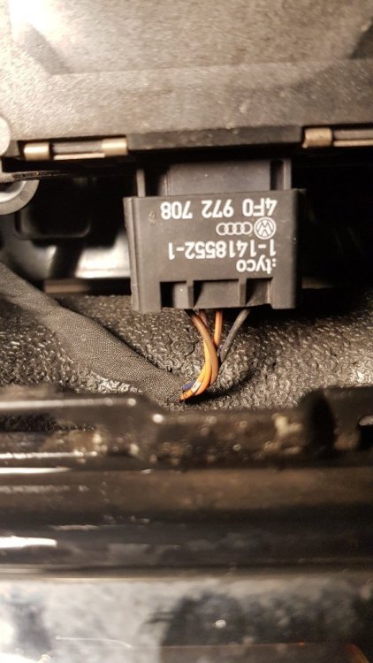

cutputape.jpg.3693ba39c513b5e8531c03ed9e0c8a66.jpg.f93a7ca6f9463671d08998d7c12589ae.jpg
Can anyone please tell me wath is  the original cables route for  acc radar  in the engine bay?
