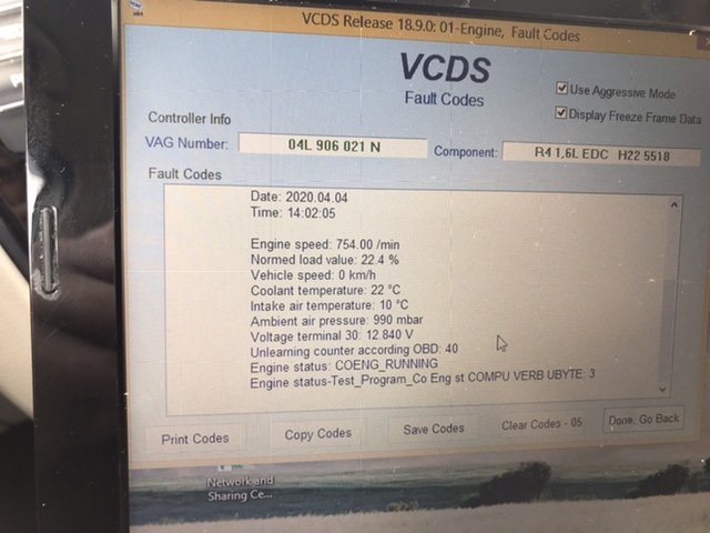

I bough a and new battery and Put in my car. After installing it vcds show the following status when I have overnight put external charger that show that battery is fully charged.
see the picture. Does this mean that battery is not good.

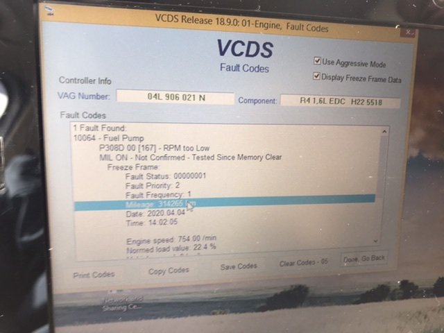

I have measured battery voltage at start and when car starts it drops from 12,8v to 11,1v and later to 10.6volt. Car also showed once glow plug mil light and vcds show following error rpm too low.
The new battery right after installing in car show battery low mil lamp. But overnight charged gave the result over.
Is this battery not good. It have 760cca and 70ah from local general car selling store.
hope someone can figure out what.
I have changed one fuel pump because of this before. Because car cranked 5 to 7 times before start but now with new battery it starts fine but it have given on the morning first start low rpm on fuel pump.

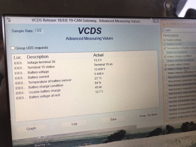

but does picture mean that this is what is charged and that number should be 70Ah when fully charged battery.
Or does this mean that this is the battery’s life time rest. Since this is the new battery I can claim and change to another one.
After driving for one hour now i can see that it shows 45 Ah. This should mean that alternator is good?

Coding definitely needs doing, the system learns how much capacity a batter has so needs resetting when a new battery is fitted. That's probably why the Ah is so low in VCDS.
