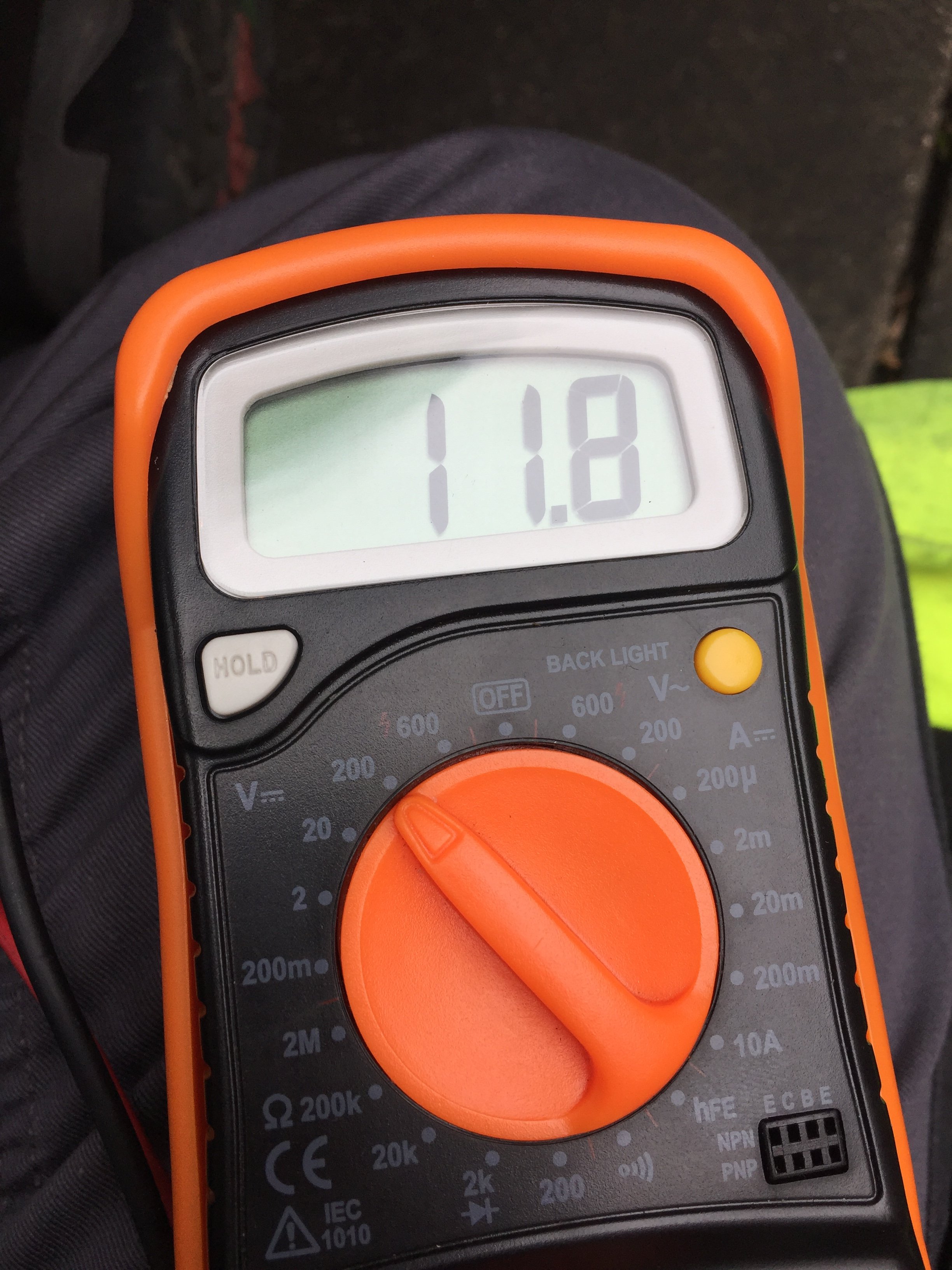

Oh yes! Right I’ve tested the black yellow switched wire on the smaller plug and it’s reading as below so ok.. so from advice Ime now stuck until I get a vcds diagnostic 😐
