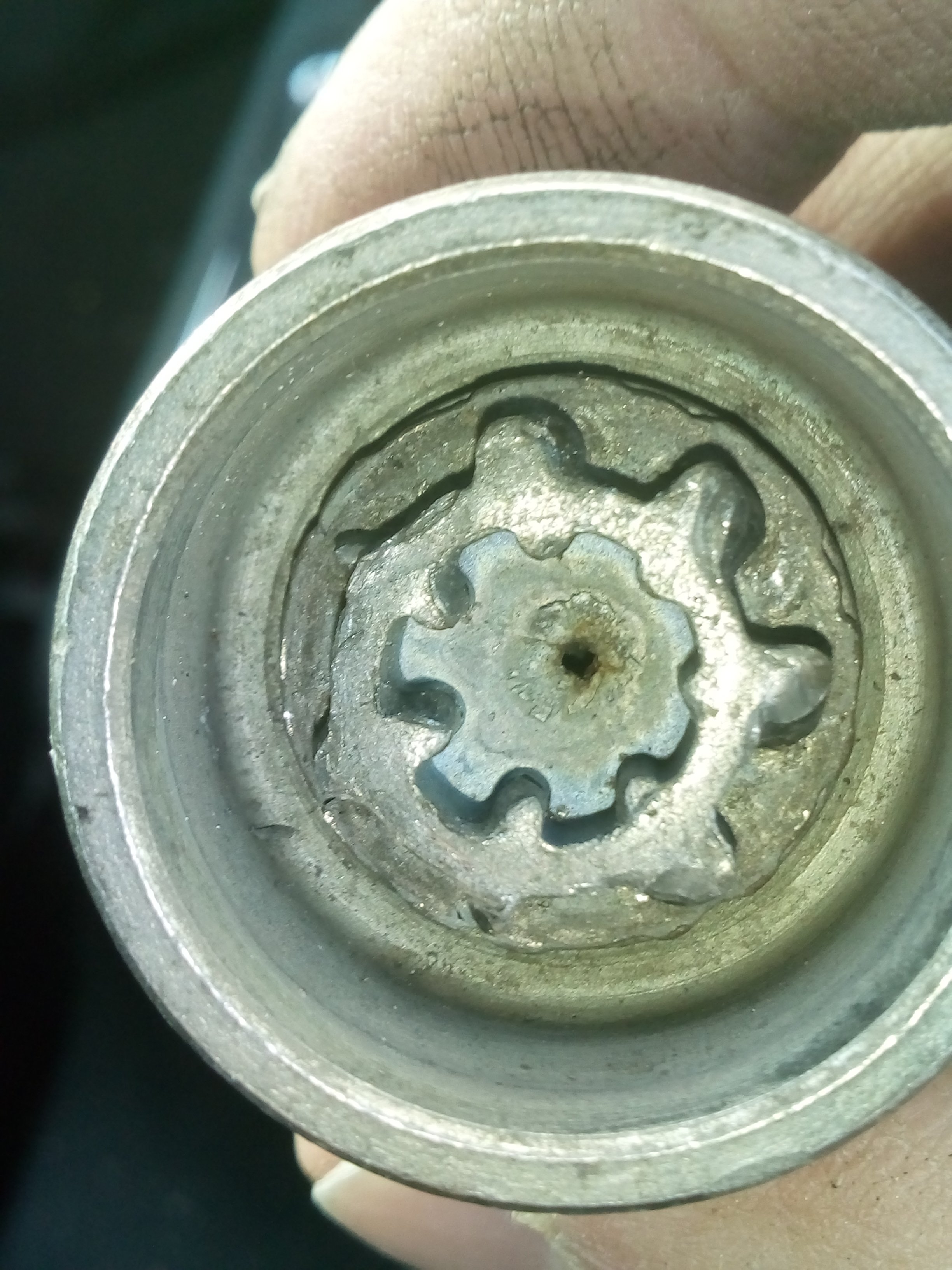

rounded off locking nut help?
tried to take my wheel off today to refurb  but slipped the lock nut
didnt try again after that
the wheel nuts are fine
anyone have a spare or same one that i can use to loosen my lock nuts to remove (im in bimingham)
or know how much they are at the dealers? but i doubt any will be open and i dont want to get stranded with a puncture
or alternative solution to get wheel off?
skoda superb mkII
thanks in advance
heres a pic

what number is on the side? i got mine for 20 pound.
i put a thread up few months back when my locking nut stripped the nut on my car, i had to weld another nut onto the locking nut and unscrewed it that way. it was a nightmare! needless to say i didnt put a new locking nut back on, i just used a normal one.
mine has the letter f on the back

It appears that eBay from @froggy8 is your best bet as the letter alone is not sufficient because you require a 3 digit number they say came with your new car pack etc. They can search for it based on your car details too.
If Halfords are open I think you can  get socket which is multi splined and you hammer it on the wheel/locking nut and them remove it with the wheel brace.  The locking nit will need to be replaced but at least you'll get the wheel off.

i do have some sockets..but smashed the cheap one by trying to hamering it on it just cracked. will look to see if i got a steel one that fits over it.
I had one rounded off and went to the tyre place I usually go to. Their impact wrench managed to vibrate it loose.

If you haven't managed to sort it out yet, I watched a video yesterday, where the locking bolt was missing, so the guy used a cold chisel to break the outer ring and used a socket to undo the nut
As mentioned, once you get it off, leave it off and replace them all with standard bolts. I can't imagine you see many MkII Superb's on standard alloys sat on bricks these days, the risk of theft is very low.
Being able to get the wheel off, at night, in the winter, at the side of the road with your family in the car takes precedent over the security of the alloys, at least for me.

got it sorted now . thanks fellas
local tyre place was open. he managed to get the three open by hammering the actual lock nut key on to it quick hard and using his air gun . the 4th one he had to hammer a socket on to it . only asked for a fiver as im a regular there.
iv replaced all with standard bolts now anyway. the wheels are only 16in ...so no chance of them being nicked lol
