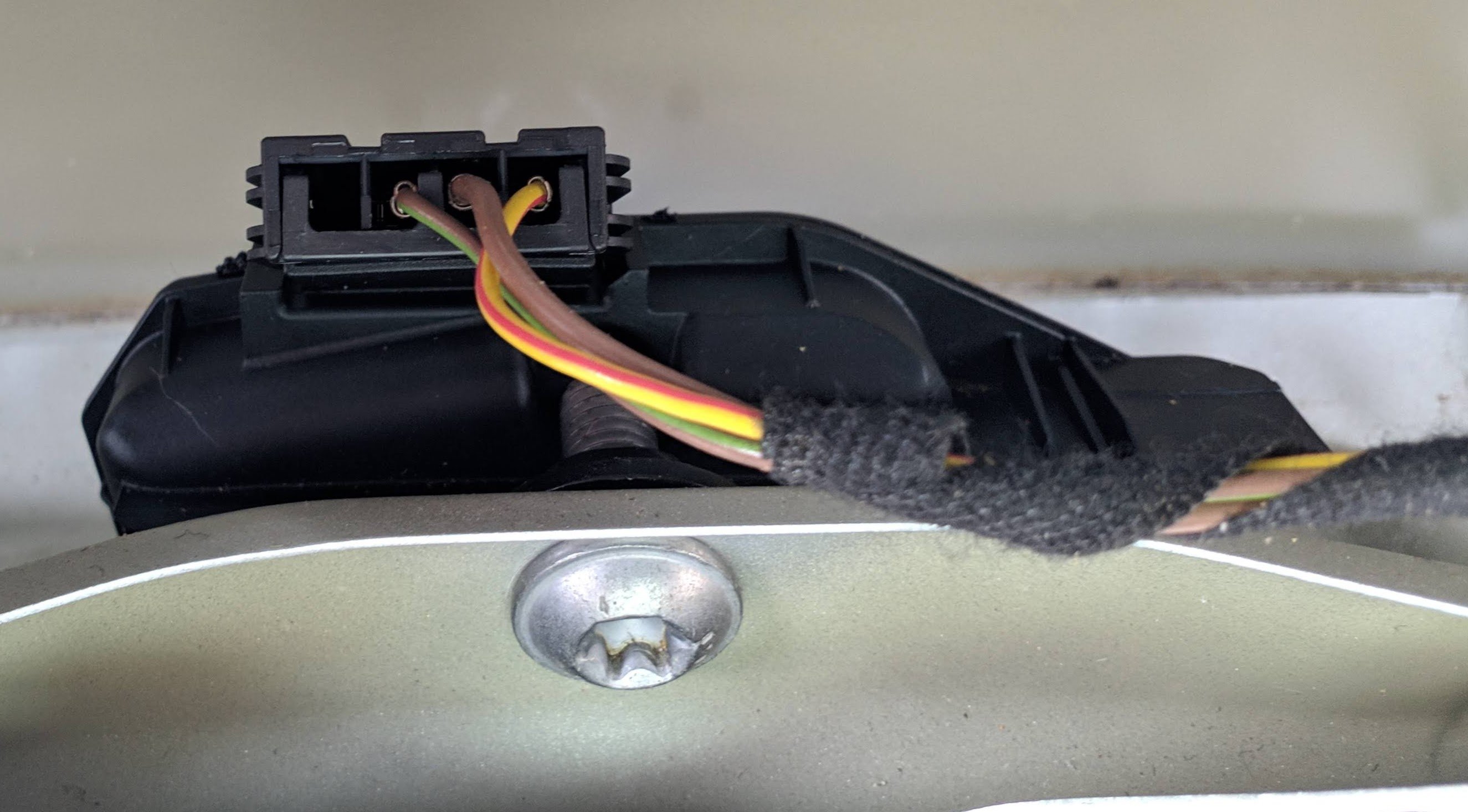

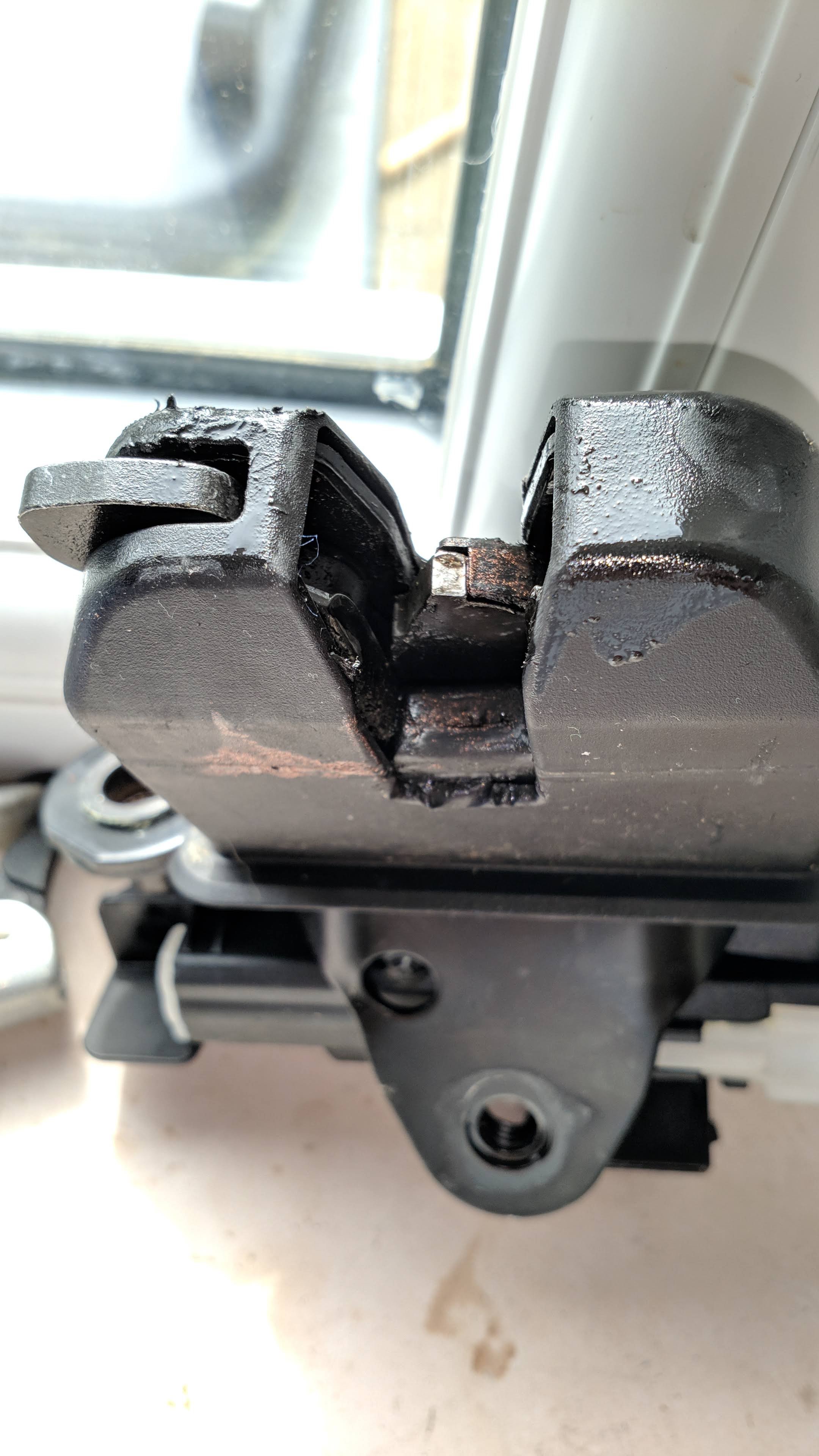

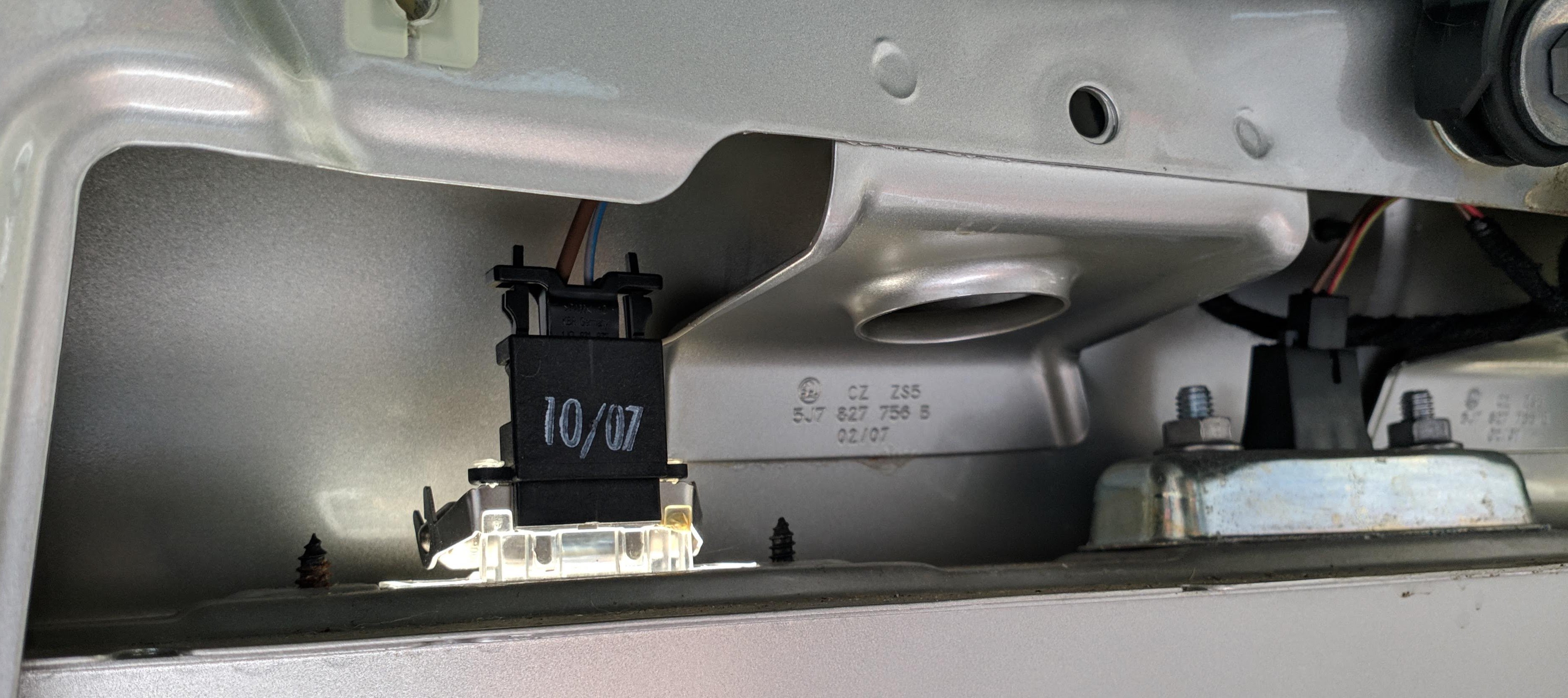

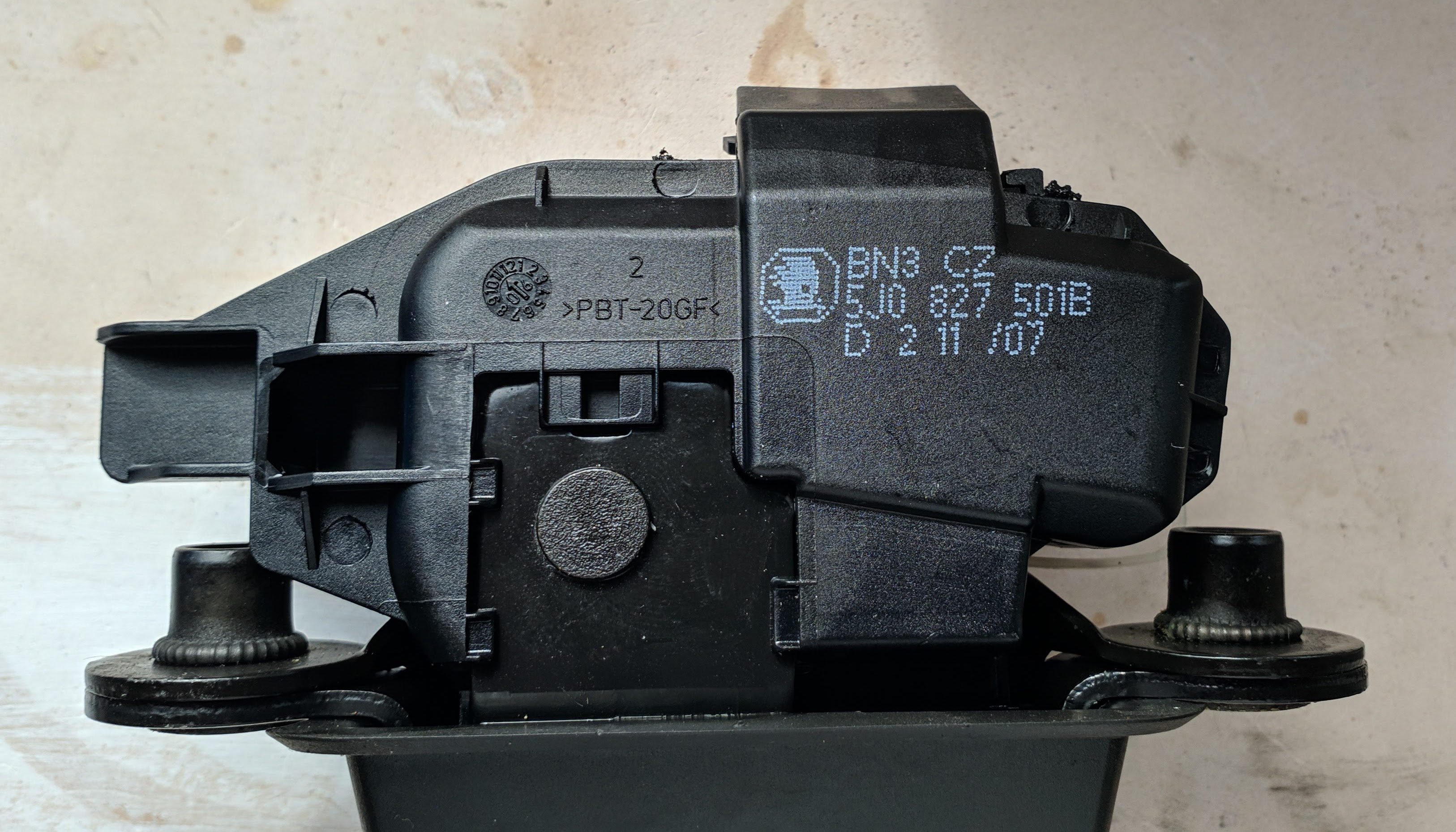

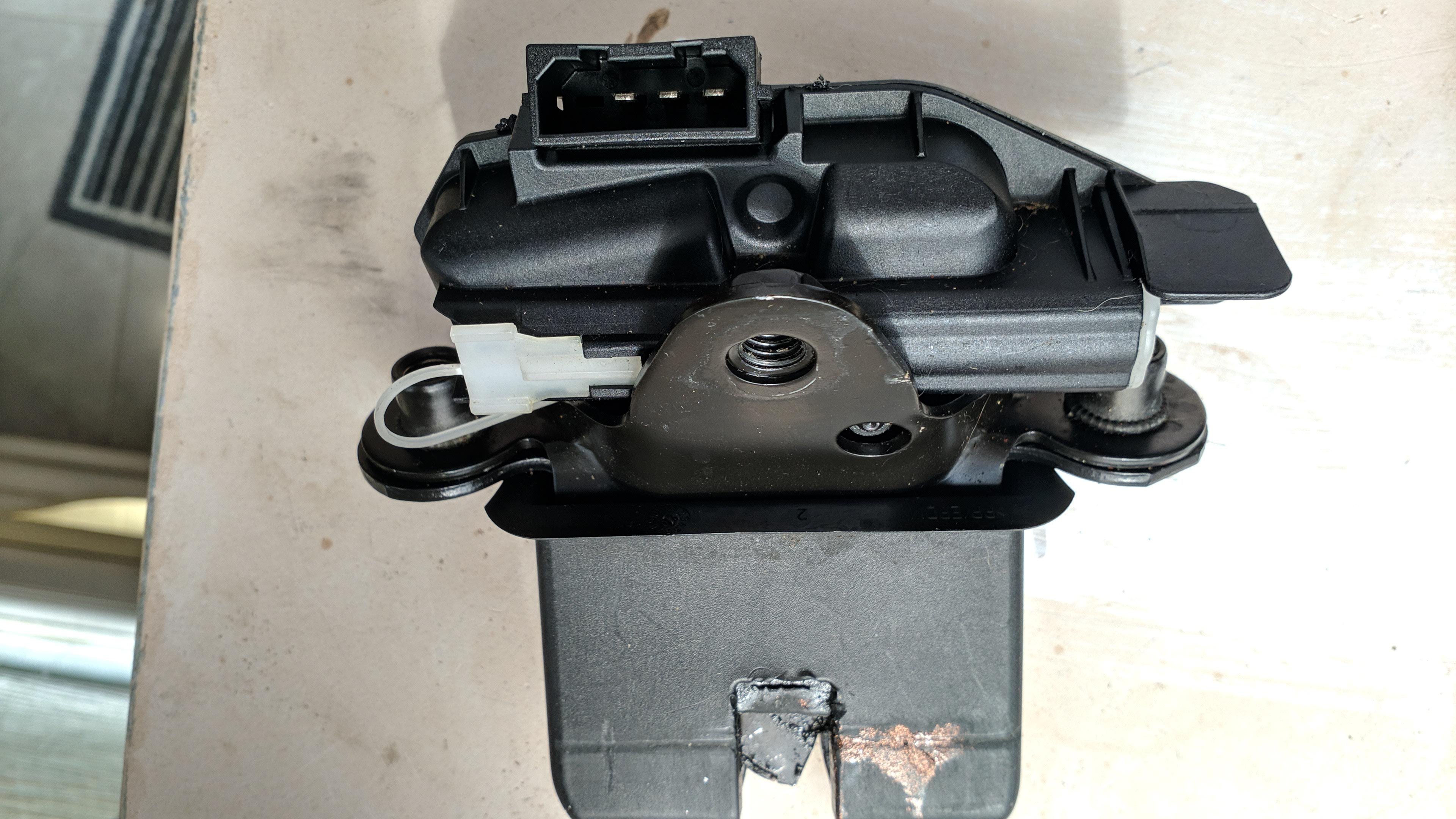

So removing the trim and checking wires where the taligate loom goes into the body revealed no damage, in fact the whole of the tailgate was so clean inside I could have eaten my dinner off it - not bad for a 13yr old car ??
The issue appeared to be the tailgate lock, the actuator switch and the number plate lights were all as new.
A lot of spray cleaning and grease helped a lot, but occasionally it still sticks - so a new 5J0 827 501B is required

So the used part arrived yesterday, I took the opportunity to fill it with white lithium grease before fitting.
All back together within 10 mins and working again, which is nice :)
