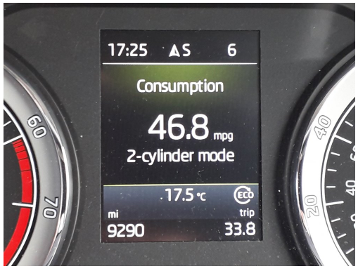

Where I live, being very flat and without fast roads (no dual carriageways or motorways) the engine in my car is very often in Two Cylinder Mode.
Does anyone know if its always the same two cylinders that are shut down?
If so, is that likely to cause any `issues`...(have you noticed that we don't get problems these days, just `issues`😁)... due to lack of driving at the moment?
Many thanks.

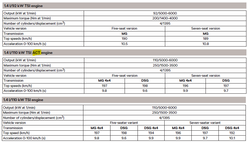

I did a little digging before buying our 1.4 TSI Kodiaq.
The 1.4 TSI 125PS engine does not have ACT.
The 1.4 TSI 150PS engine does have ACT.
But, the 1.4 TSI 150PS with both 4x4 and DSG does not get ACT...
The Superb of course may well be different.
The 1.5 TSI too.
Edited by silver1011
Thanks Silver1011. I’d’ve thought the higher capacity engines would be be ripe for this technology too.
