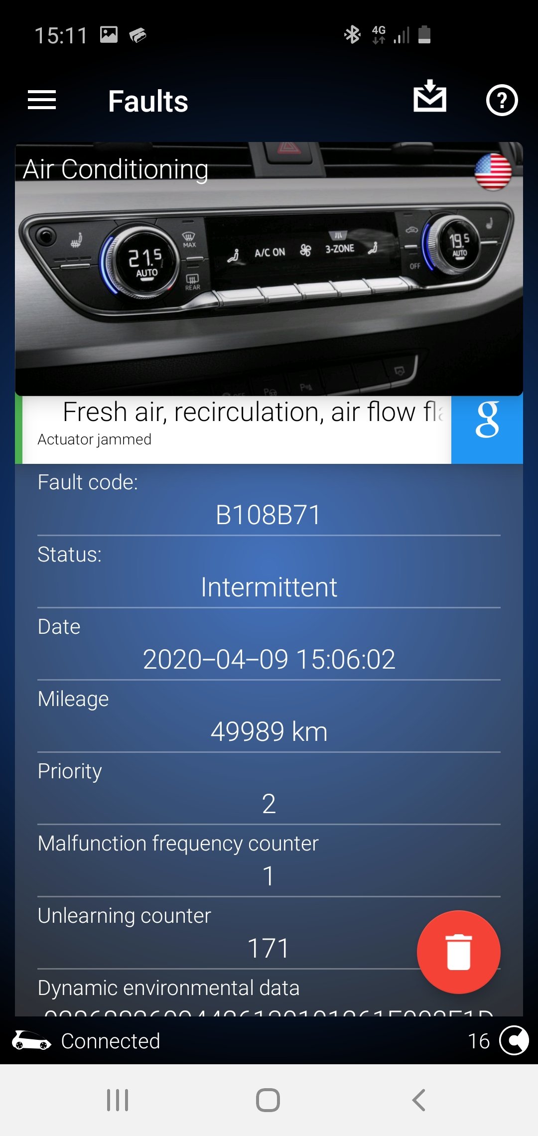

So today my Octavia's aircon decided to play up. It Ran nice and cold and had plenty of blowing power and all of a sudden it sounds like the recirculaton is turned on when it's not. The fans won't blow much cold air out any more.
I've plugged in my obd11 and got a fault code B108B71. Air flow flap motor actuator jammed it says. I've reset it and started it all up and within 2 minutes of the aircon running it does it again.  Screenshot_20200409-151130_OBDeleven.thumb.jpg.55e22456809bb7e5277e7a4de6ae477f.jpg
Anybody else experienced this problem before?

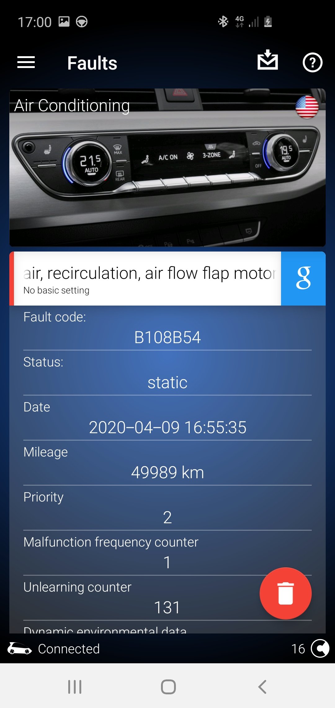

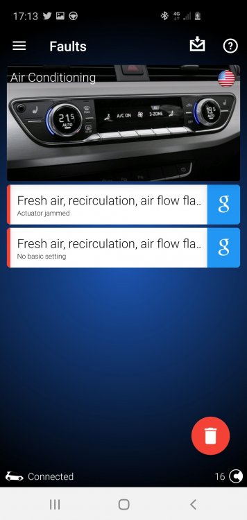

Update:
The car has now decided to display another error on OBD11. B108B54 - No basic settings. What's going on with my car??
