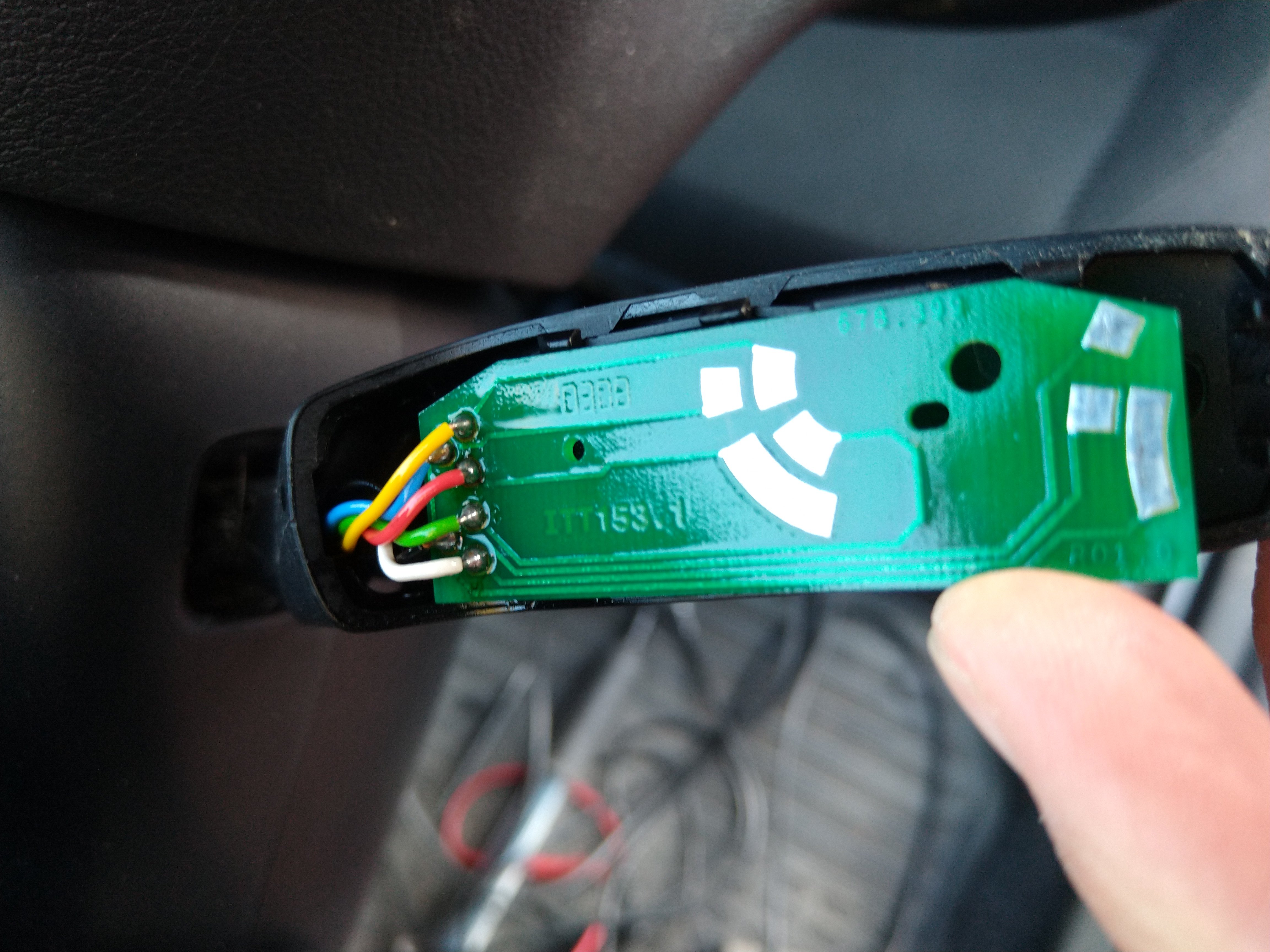

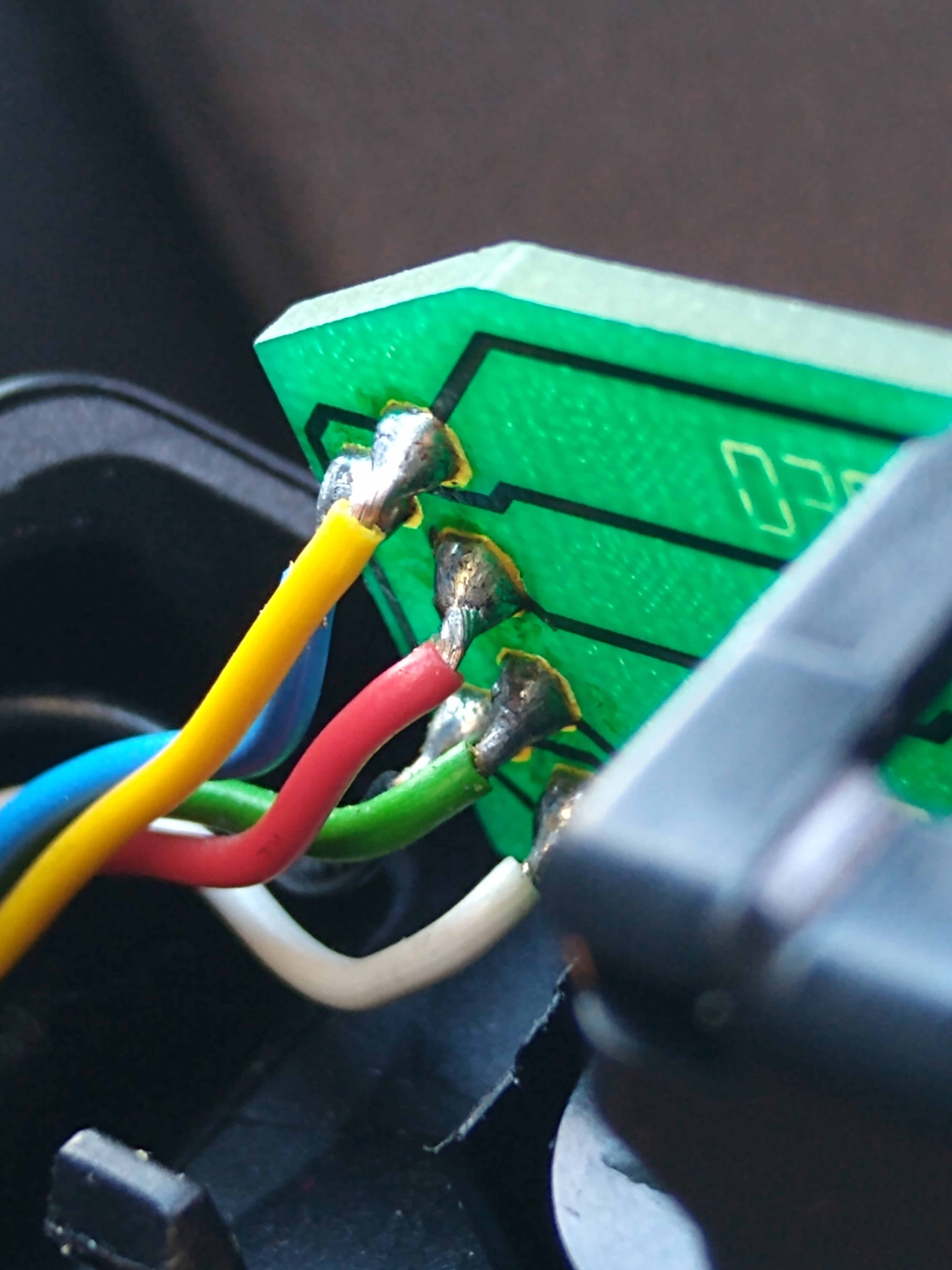

I have no connection on min, soldered directly to the pcb.
But maybe resolder all the connections is step one.
Hmm different to mine iirc only three cables on mine.........
I was aware of the belief that these were soldered on other vag group cars
This is mine.
I don't know what I can do now.
Is VCDS (or similar) a must? Or can I maybe find whats cousing the problem in another way?
In my limited experience I would say that looks over-soldered.............is it standard fit on your car, and is it a Fabia or Octavia???
Its a 2008 Fabia.

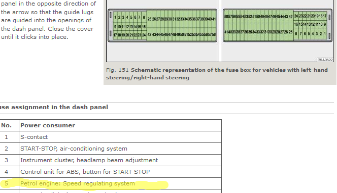

I asked about fuse originally,  then had a nosy at the wiring diagrams.............seems there is not one for the CCS in vehicles of this age.
Edited by UrbanPanzer
Ahh.....had another look, the 5 amp fuse supplies the brake pedal switch for CCS..(not brake lights) as there is 2 sets of contacts in the one switch. The feed goes to the Engine ECU.

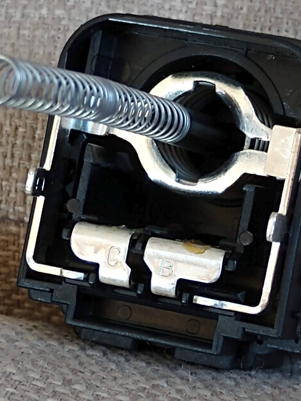

So i wanted to check out the switch a bit more.
It seems to operate as its intended to do.
The two middle pins is in contact when the brake is idle, the outer pair is on when the brake is down and vice versa.
If i delete the fault code it immediately comes back, without driving, braking or anything.
Are you (or anybody else) still sure its the brakeswitch?
