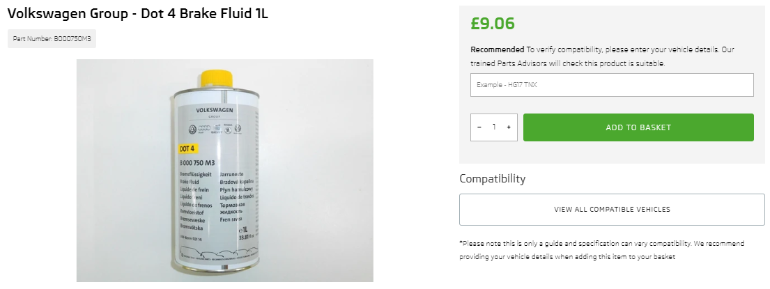

Be aware, as with oil, VW have their own standard specification for brake fluid...
VW 501.14, as per the product I illustrated above.
Compared to DOT 4 it has a reduced low temperature viscosity. Make of that what you will.
For those of us who have suffered from the now infamous 'VAG Teeves MK60' ABS pump issues that affected a huge number of Skoda, SEAT, VW and Audi models and proved to be an extremely expensive fix for those that weren't able to claim under warranty, or before the repair kit was released, will know how the failures were related to the state of the brake fluid.
DOT 4 will be fine, it is still approved for use by Skoda, but as mentioned for the sake of £10 I'd be tempted to buy new fresh fluid, and one that meets the standards set by VAG.

VW 501.14, as per the product I illustrated above. Compared to DOT 4 it has a reduced low temperature viscosity. Make of that what you will.
At a guess, it'll be to make sure the ABS/ESP functions work effectively as I believe the newer (post 2006?) pumps have smaller internal pathways.
I'd certainly agree that using something that meets VW 501.14 rather than just DOT 4 is the best plan :)
